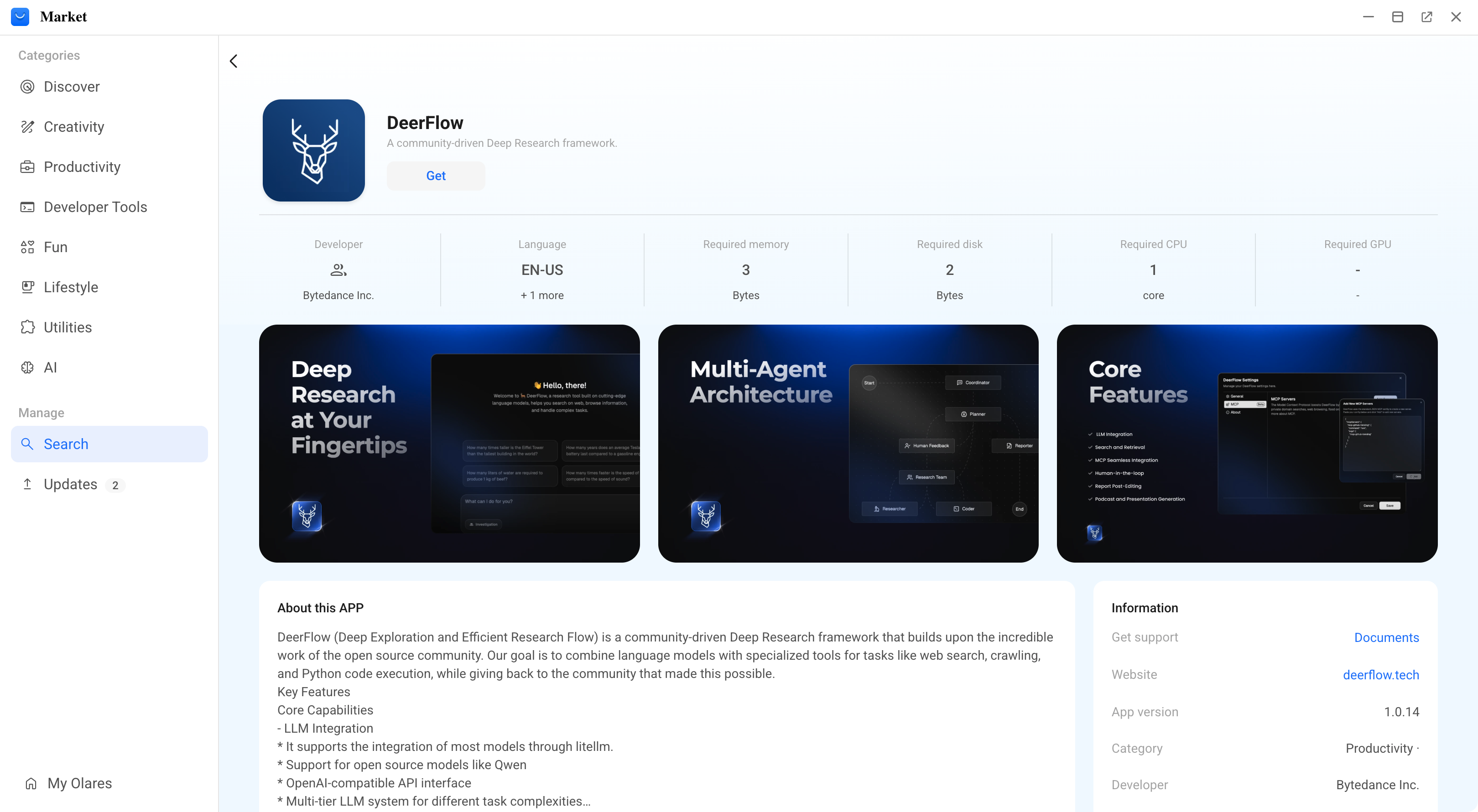

  1. Open Market, and search for "DeerFlow". Install DeerFlow

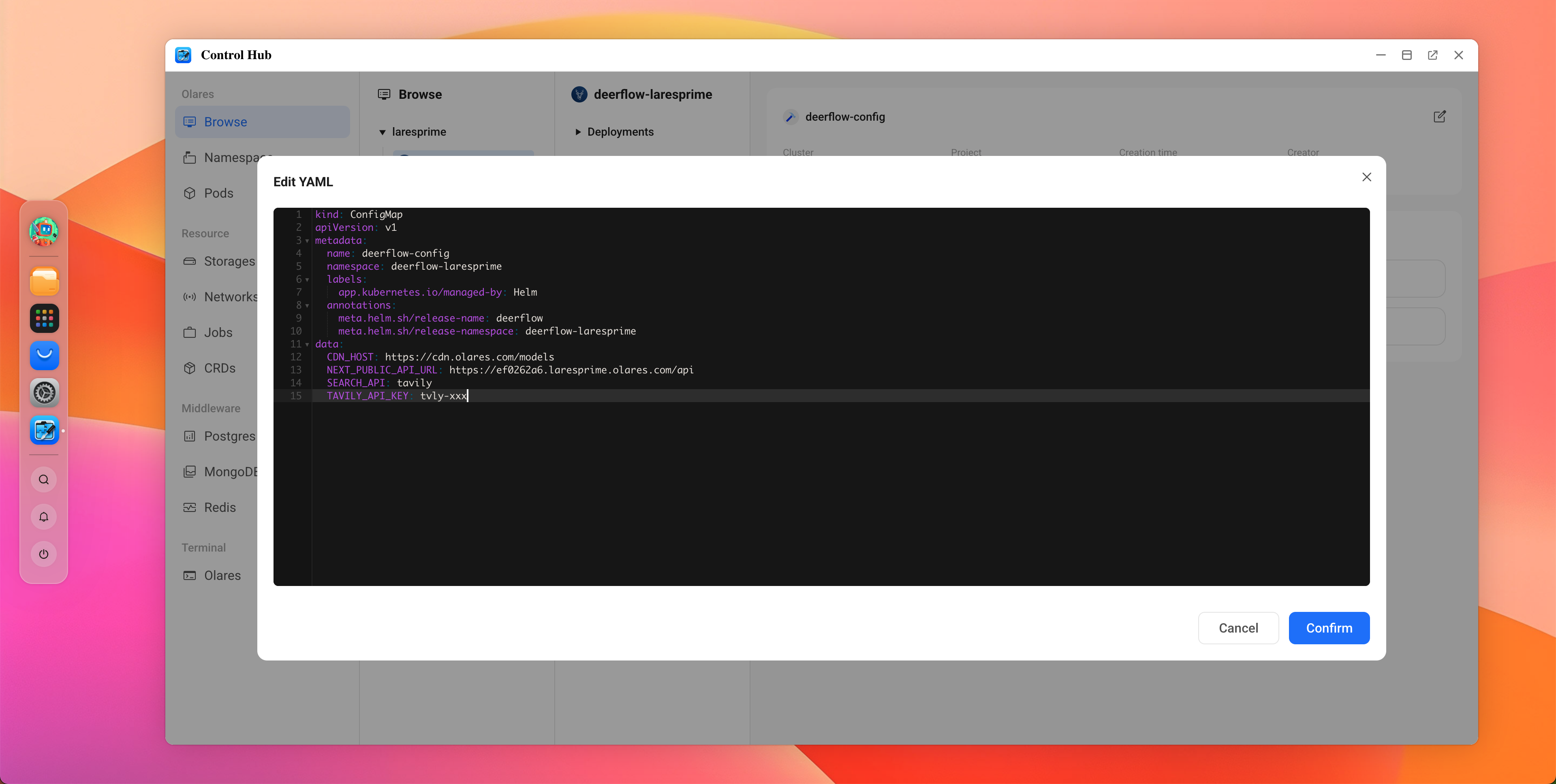

To enable web search, add your Tavily API key to the application configuration.

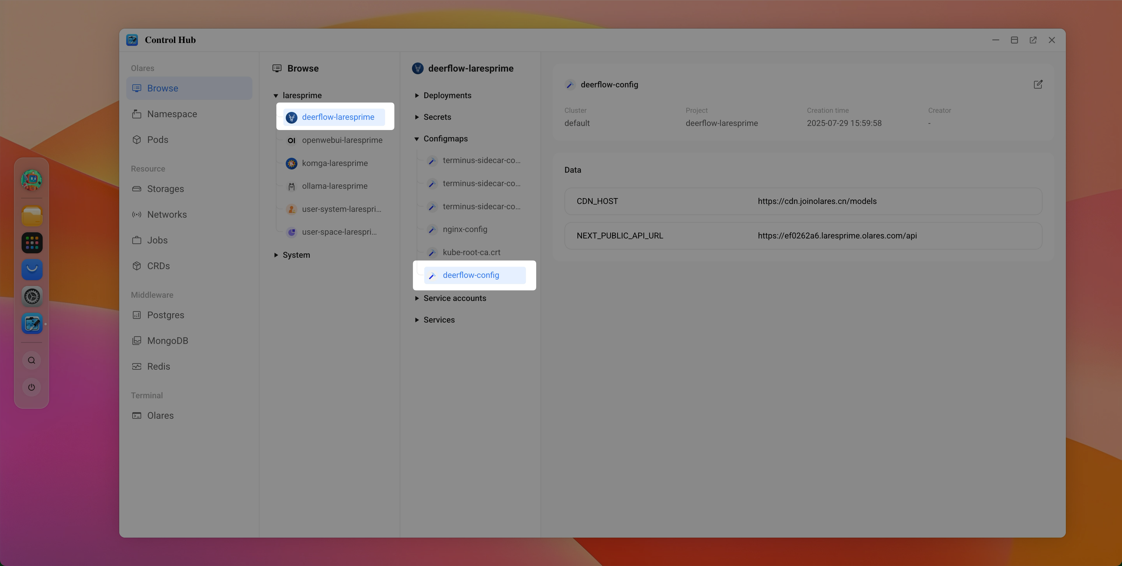

  1. In Control Hub, select the DeerFlow project.
  2. Click Configmaps in the resource list and select deerflow-config. Browse to DeerFlow's configmaps
  3. Click edit_square in the top-right to open the editor.
  4. Add the following key-value pairs under the data section:
    yaml
    SEARCH_API: tavily
    TAVILY_API_KEY: tvly-xxx # Your Tavily API Key
    Configure Tavily
  5. Click Confirm to save the changes.

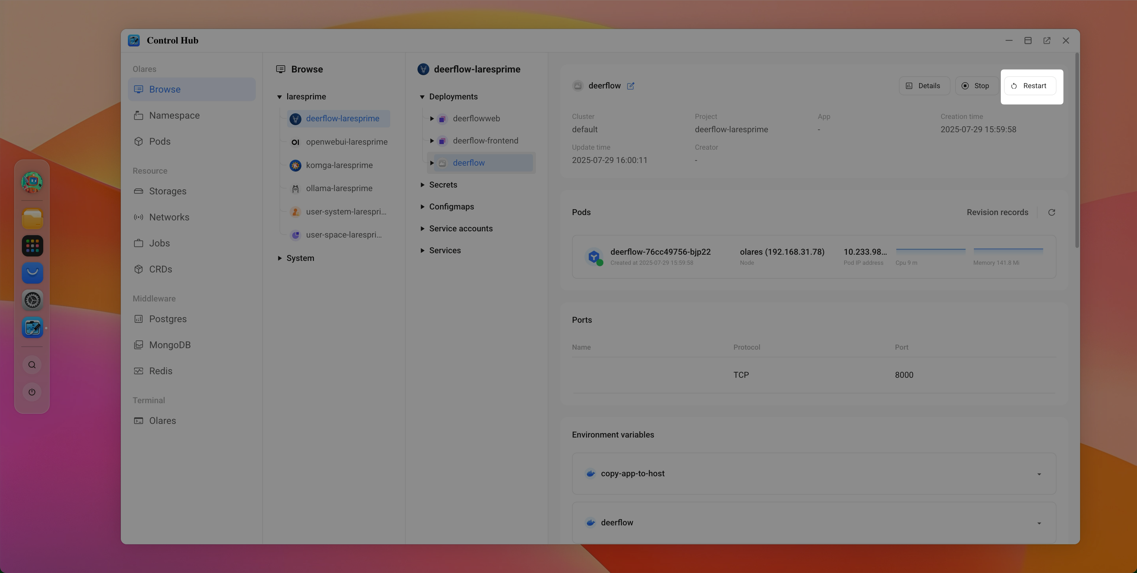

  2. Under Deployments, locate deerflow and click Restart. Restart DeerFlow
  3. In the confirmation dialog, type deerflow and click Confirm.
  4. Wait for the status icon to turn green, which indicates the service has successfully restarted.

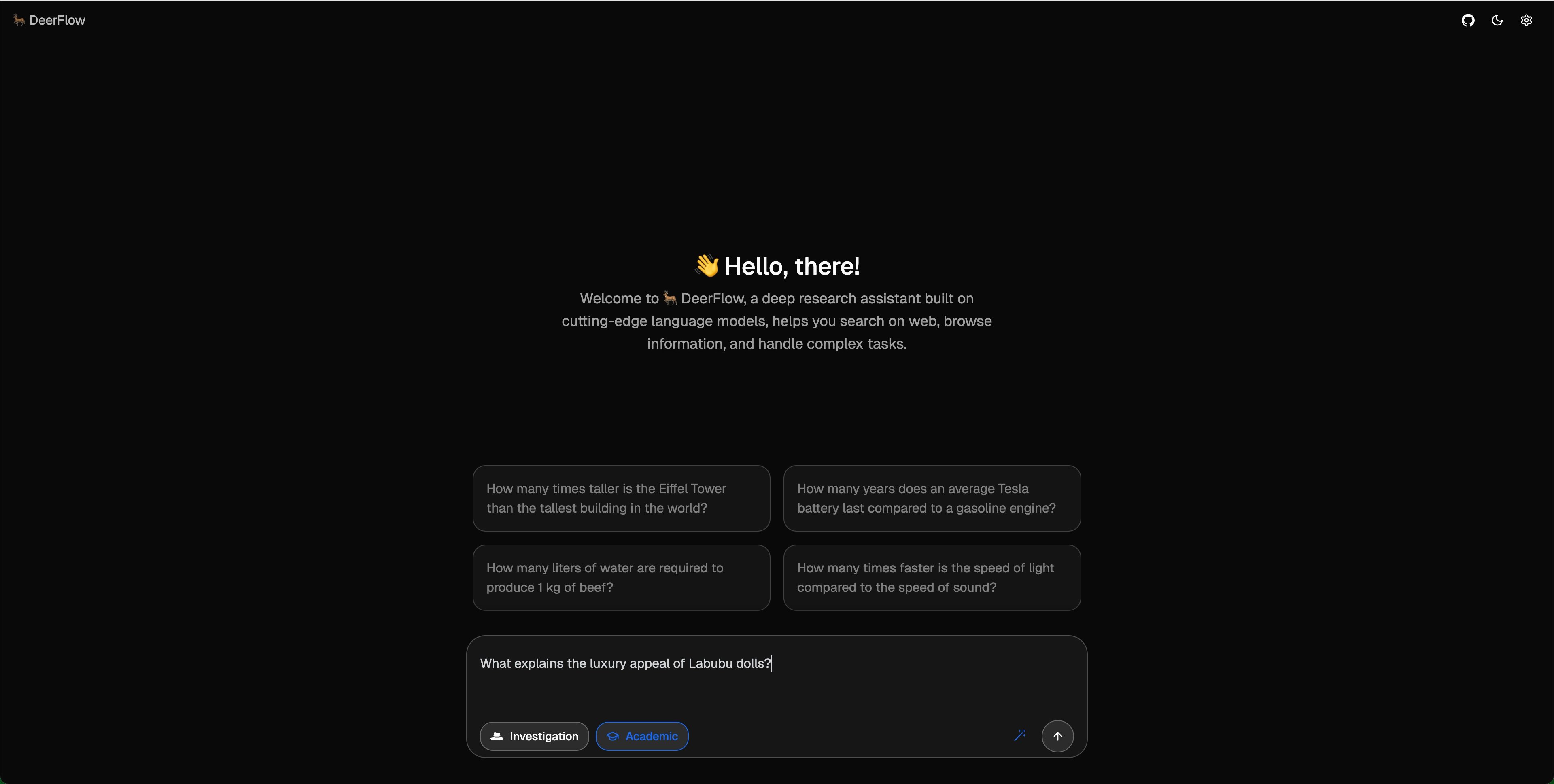

  1. Open DeerFlow from the Olares Launchpad.
  2. Click Get Started and enter your research topic in the prompt box. Enter research prompt
  3. Click the wand icon to have DeerFlow refine your prompt for better results.
  4. Enable Investigation.
  5. Select your preferred writing style (e.g., Popular Science).
  6. Click arrow_upward to send the request.

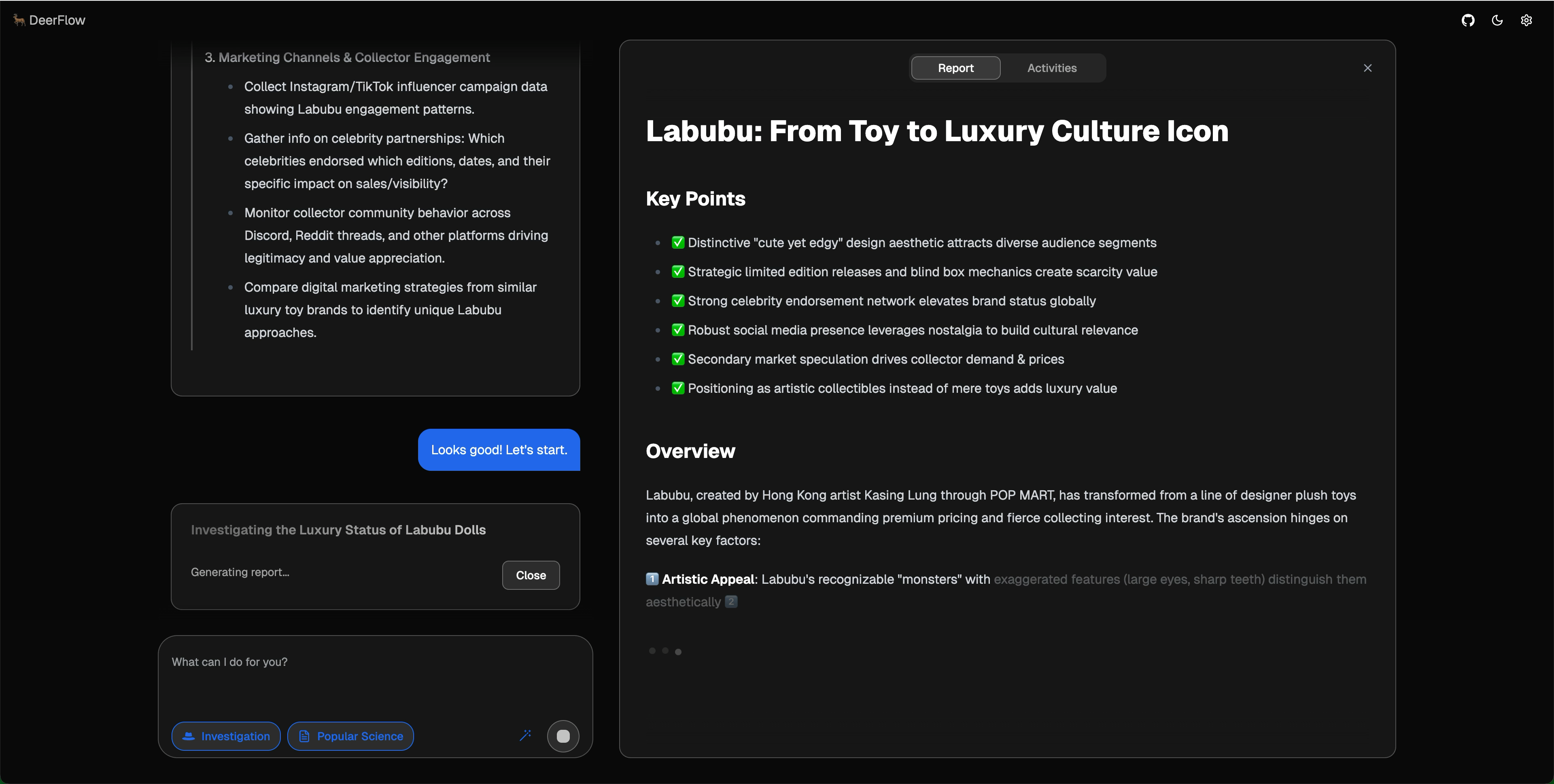

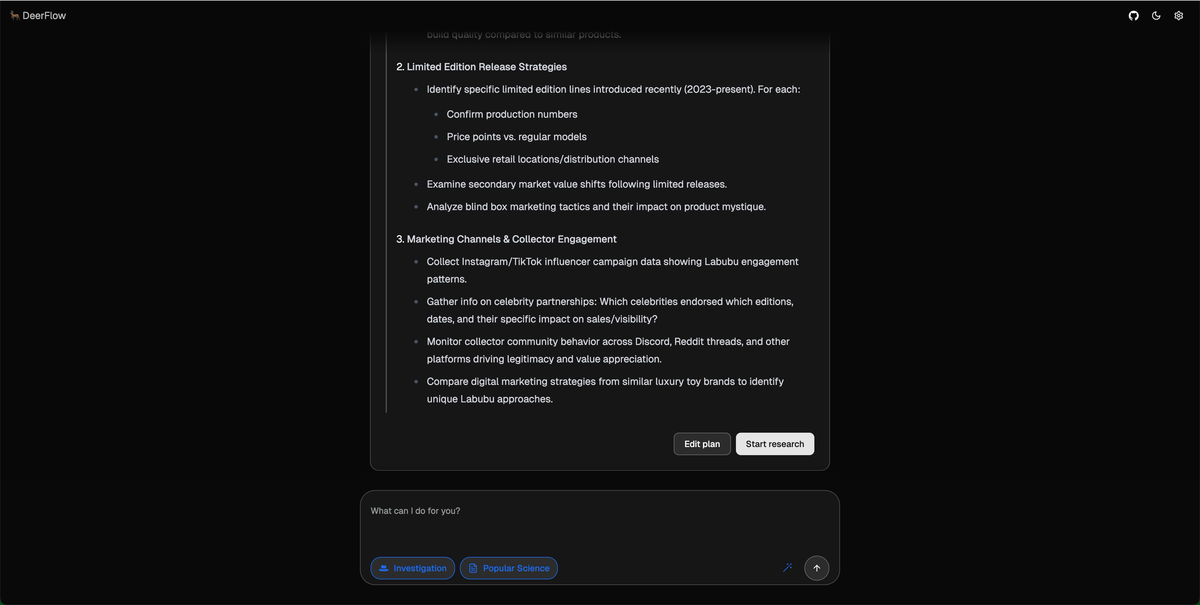

DeerFlow will generate a preliminary research plan. Review and edit this plan if necessary, or allow it to proceed. Generate research plan

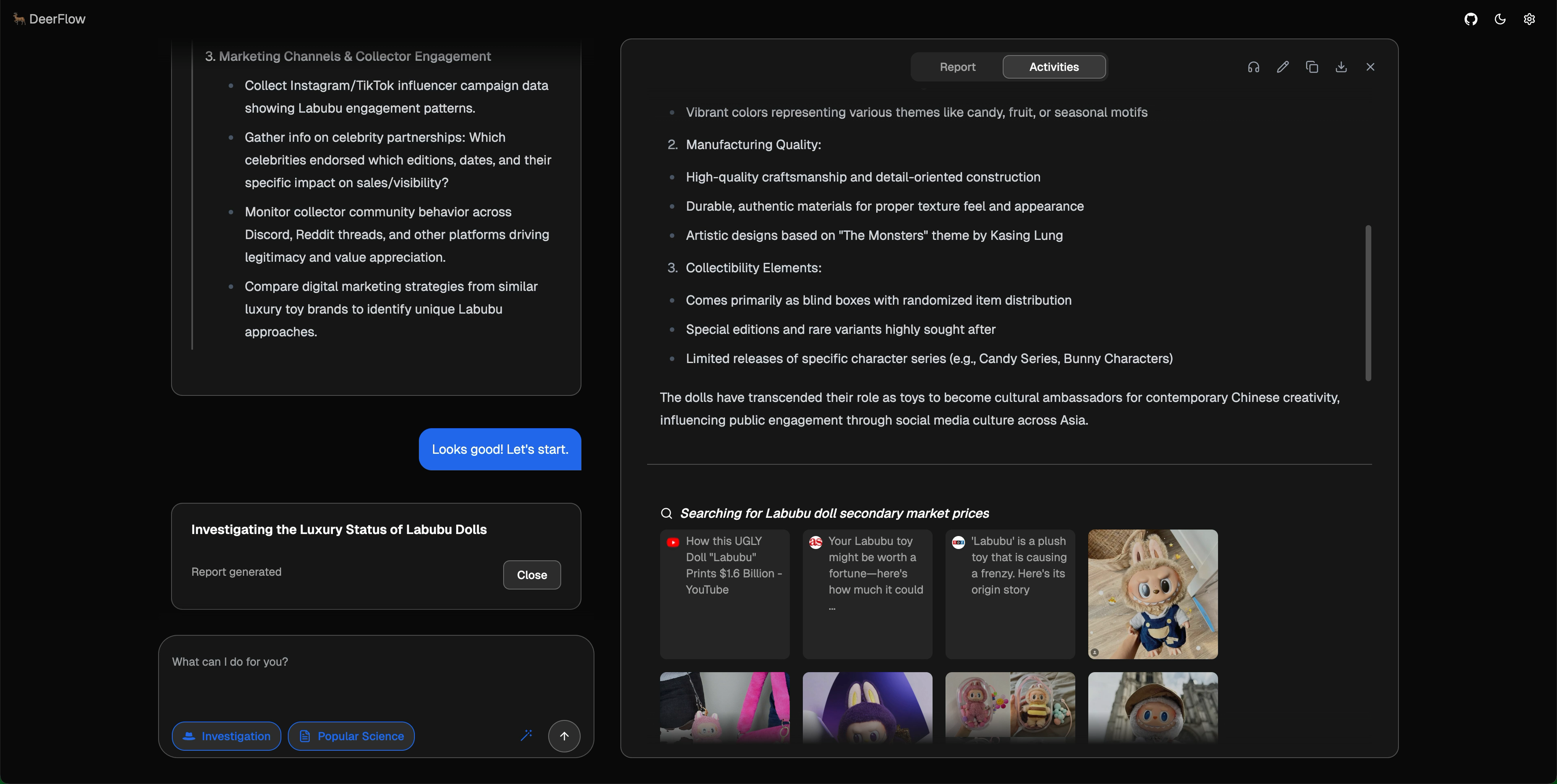

Once the process is complete, a detailed analysis report will be displayed. View research report
To audit the sources and steps taken, click the Activities tab. Review research activities

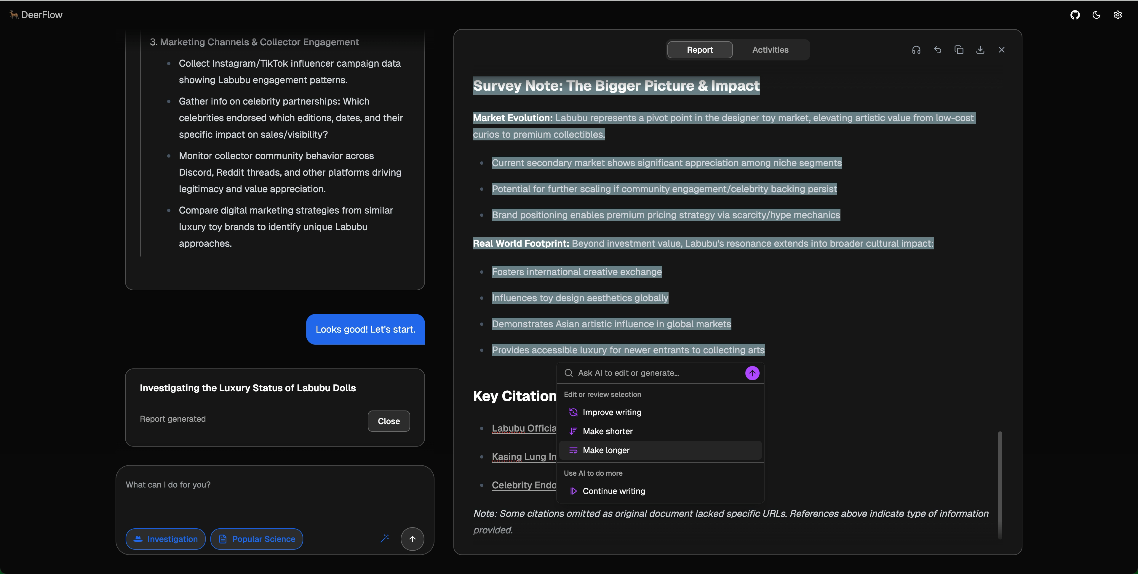

  1. Click edit in the top-right corner to enter editing mode.
  2. You can adjust formatting using Markdown or select a section and ask the AI to improve or expand it. Ask AI to edit the report
  3. Click undo in the top-right corner to exit editing mode.
  4. Click download to save the report to your local machine as a Markdown file.

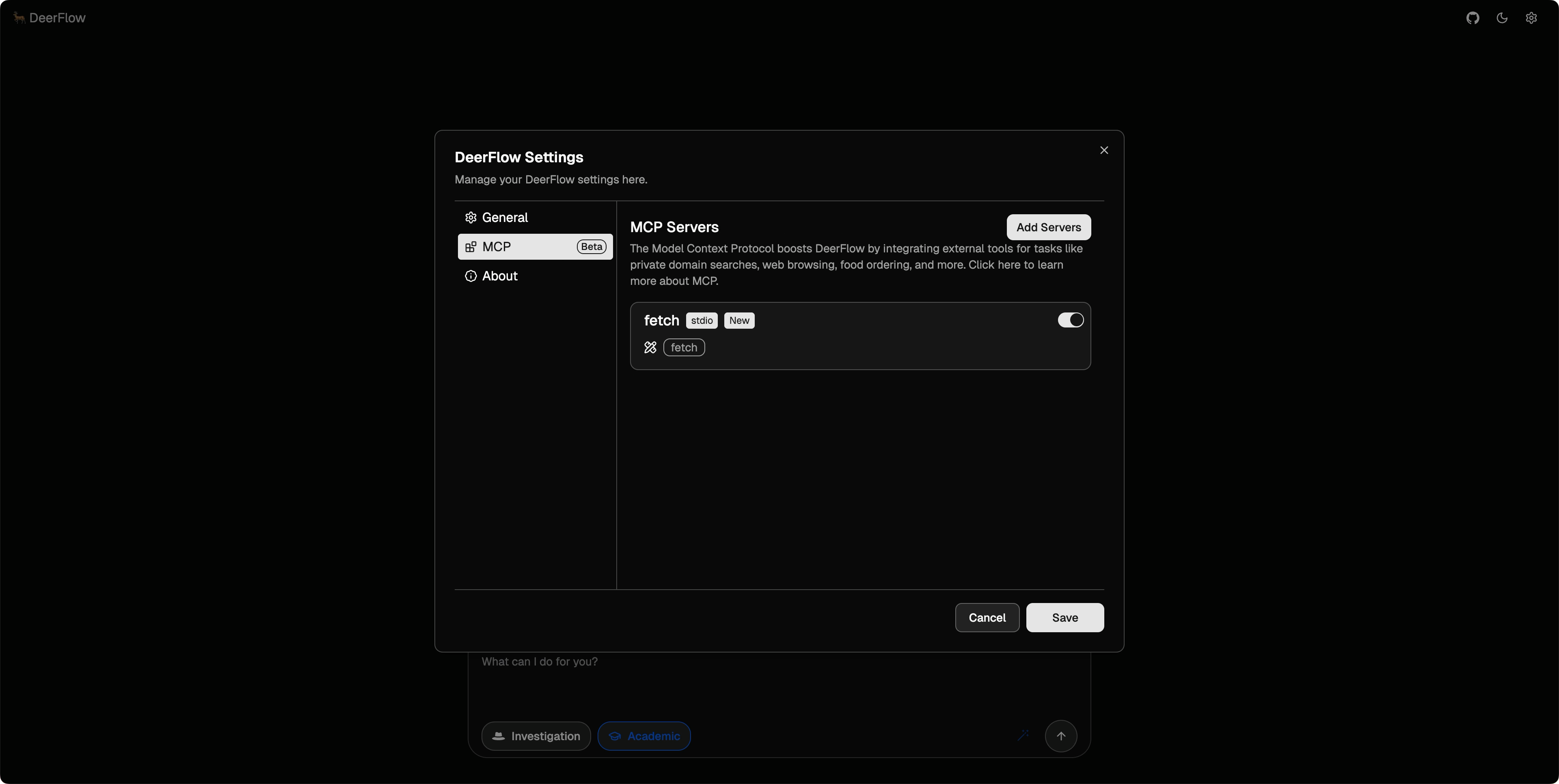

Add an MCP server ​
The Model Context Protocol (MCP) extends DeerFlow's capabilities by integrating external tools. For example, adding the Fetch server allows the agent to scrape and convert web content into Markdown for analysis.
  1. Open your DeerFlow app, and click settings to open the Settings dialog.
  2. Select the MCP tab and click Add Servers.
  3. Paste the JSON configuration for the server. The following example adds the fetch server:
    json
       "mcpServers": {
         "fetch": {
           "command": "uvx",
           "args": ["mcp-server-fetch"]
  4. Click Add. The server is automatically enabled and available for research agents. Add MCP server
