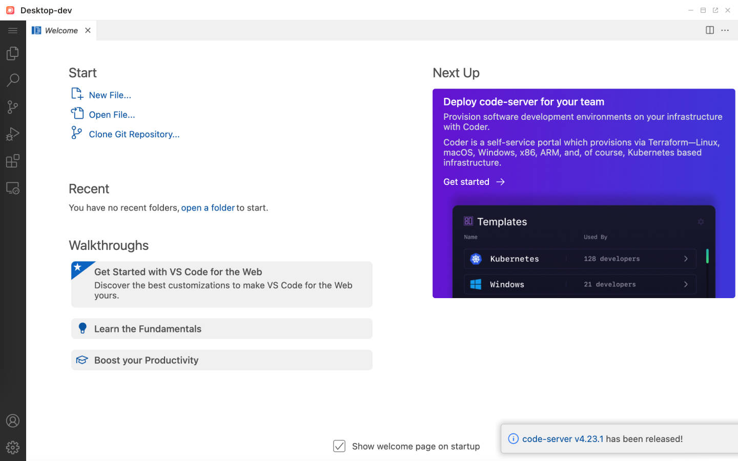

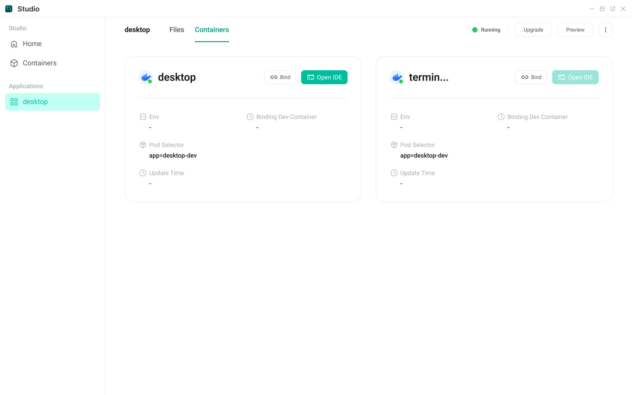

Install the system app from DevBox. Due to the installation mechanism, the desktop may not receive proper notifications. Consequently, you might need to manually refresh the page to see the icon.
Once the application is successfully installed and in the 'Running' state, you can access the default welcome page of VSCode. Simply click the 'Open IDE' button on the 'Containers' page.
ide
There is no need to bind in this case.

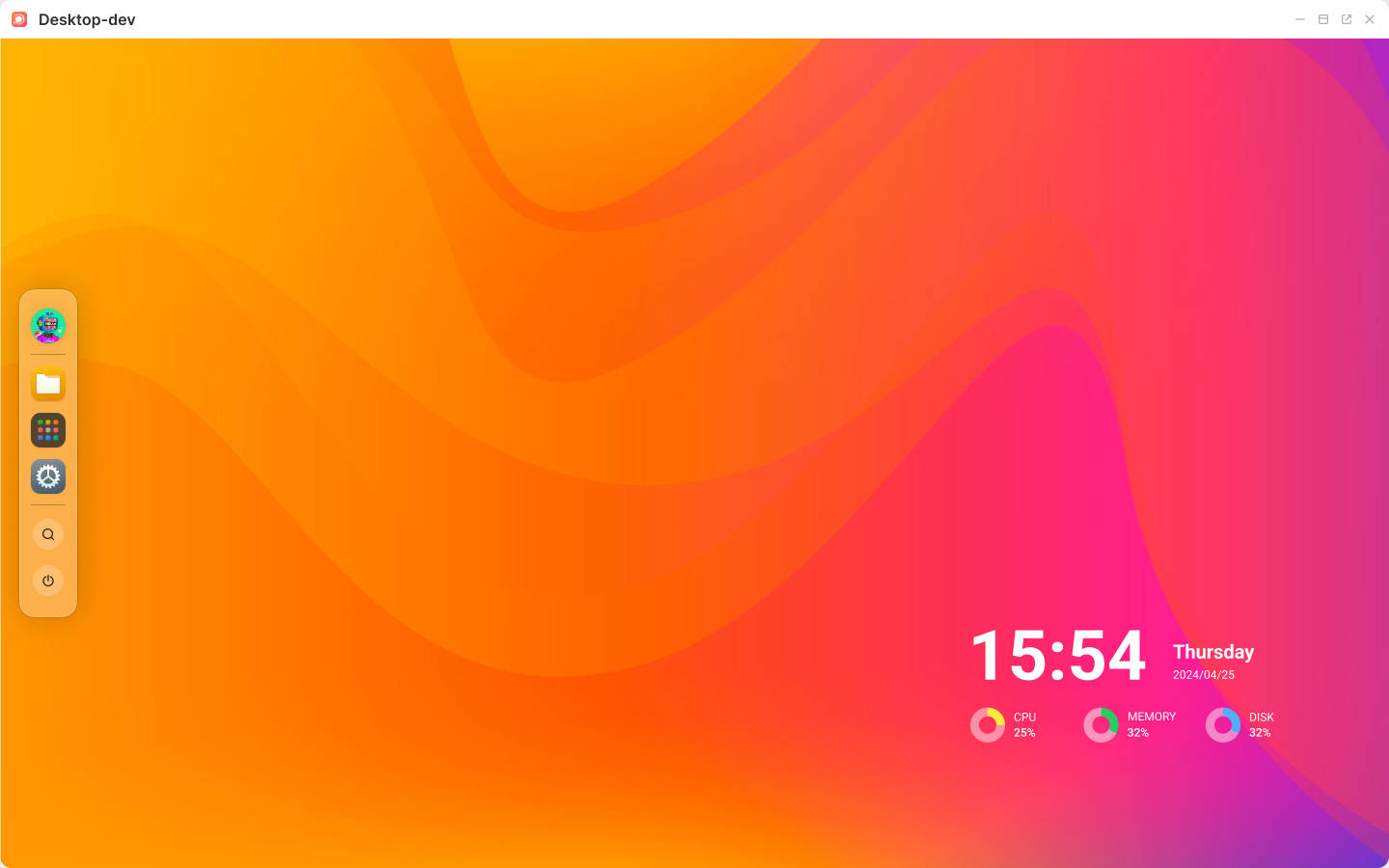

Preview ​
After install the application, you can preview it by clicking on the app icon on the Olares.
preview
