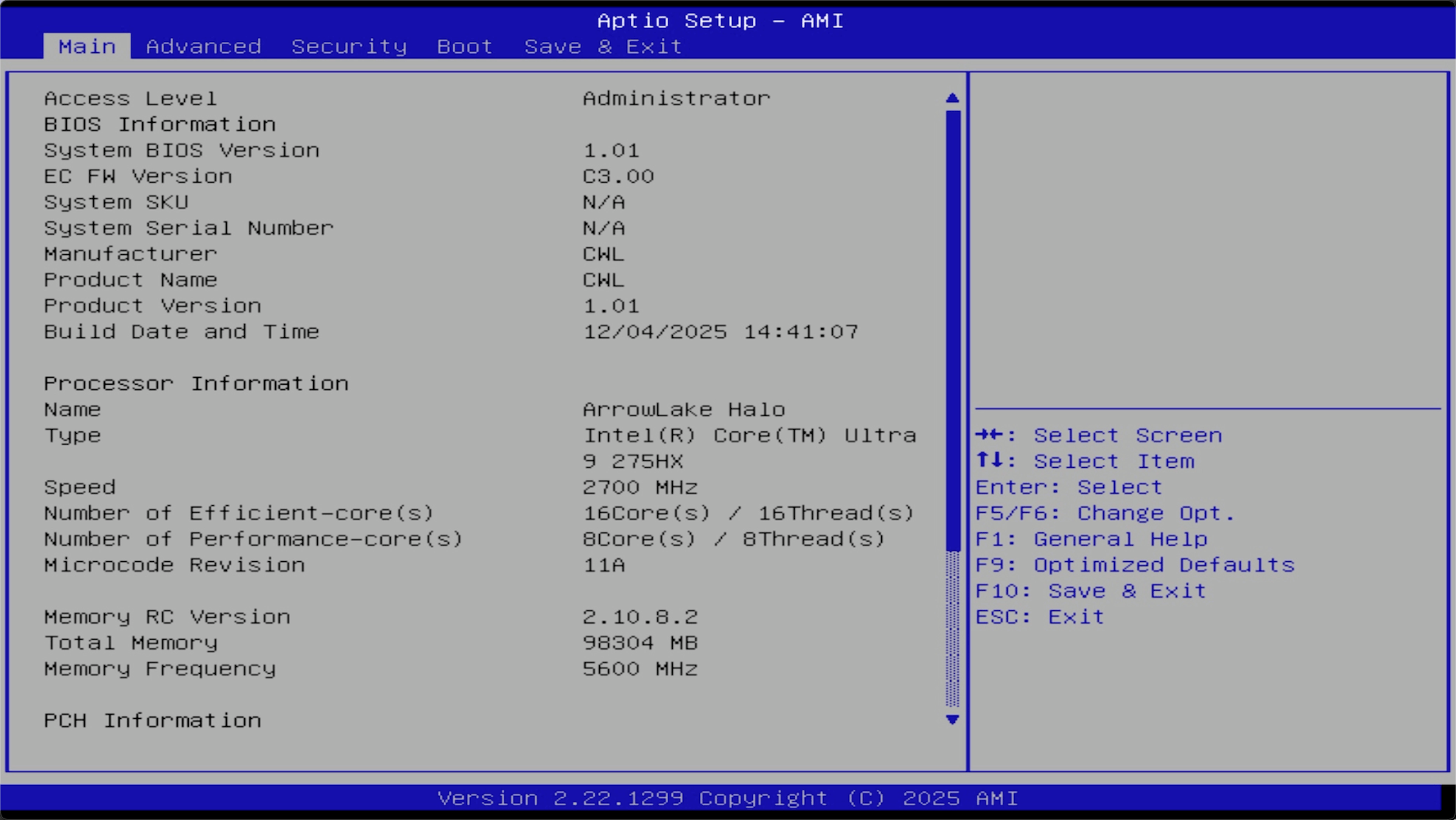

  3. When the Olares logo appears, immediately press the Delete key repeatedly to enter BIOS setup. BIOS setup

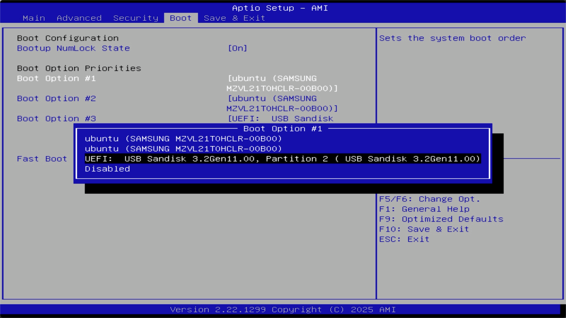

  4. Navigate to the Boot tab, set Boot Option #1 to the USB drive, and then press Enter. Set boot option

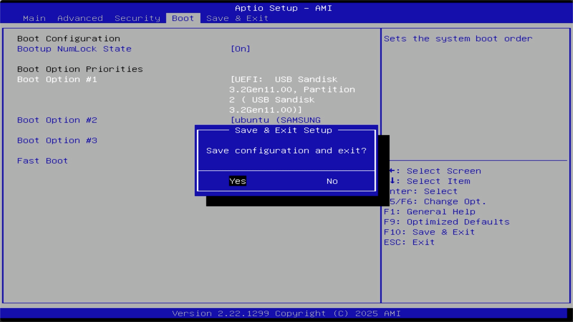

  5. Press F10, then select Yes to save and exit. Save and exit
Olares One will restart and boot into the Olares installer interface.

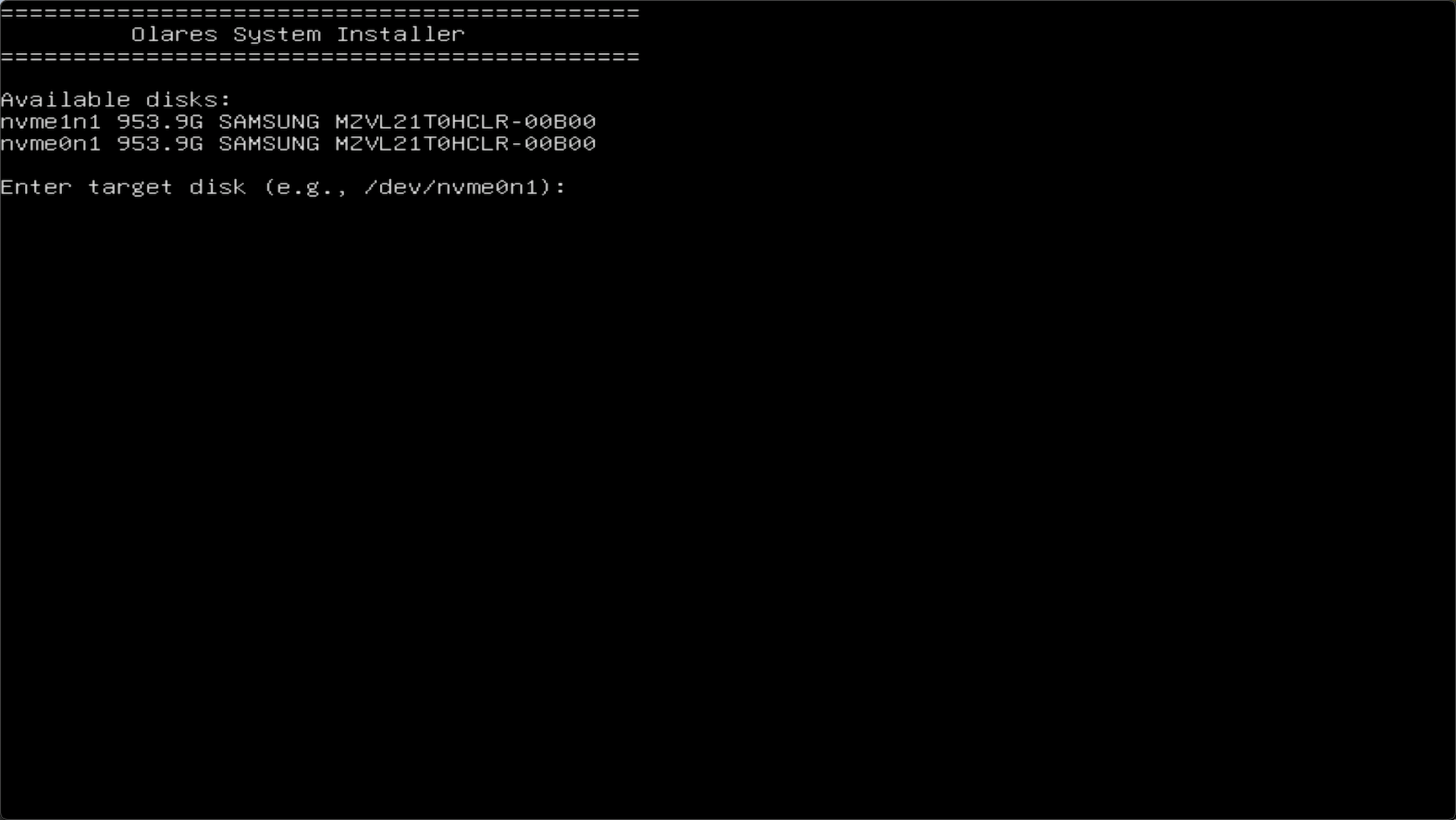

  2. When prompted for the installation target, the installer shows a list of available disks. Type /dev/ followed by the disk name (e.g. nvme0n1) from that list and press Enter. Select disk
    For example, to install to nvme0n1, enter:
    /dev/nvme0n1

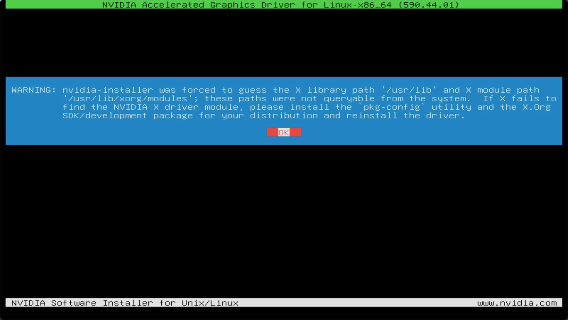

  3. When you see prompts about NVIDIA GPU drivers, press Enter to accept the default. Install NVIDIA drivers

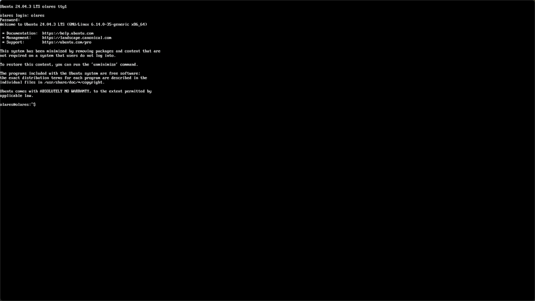

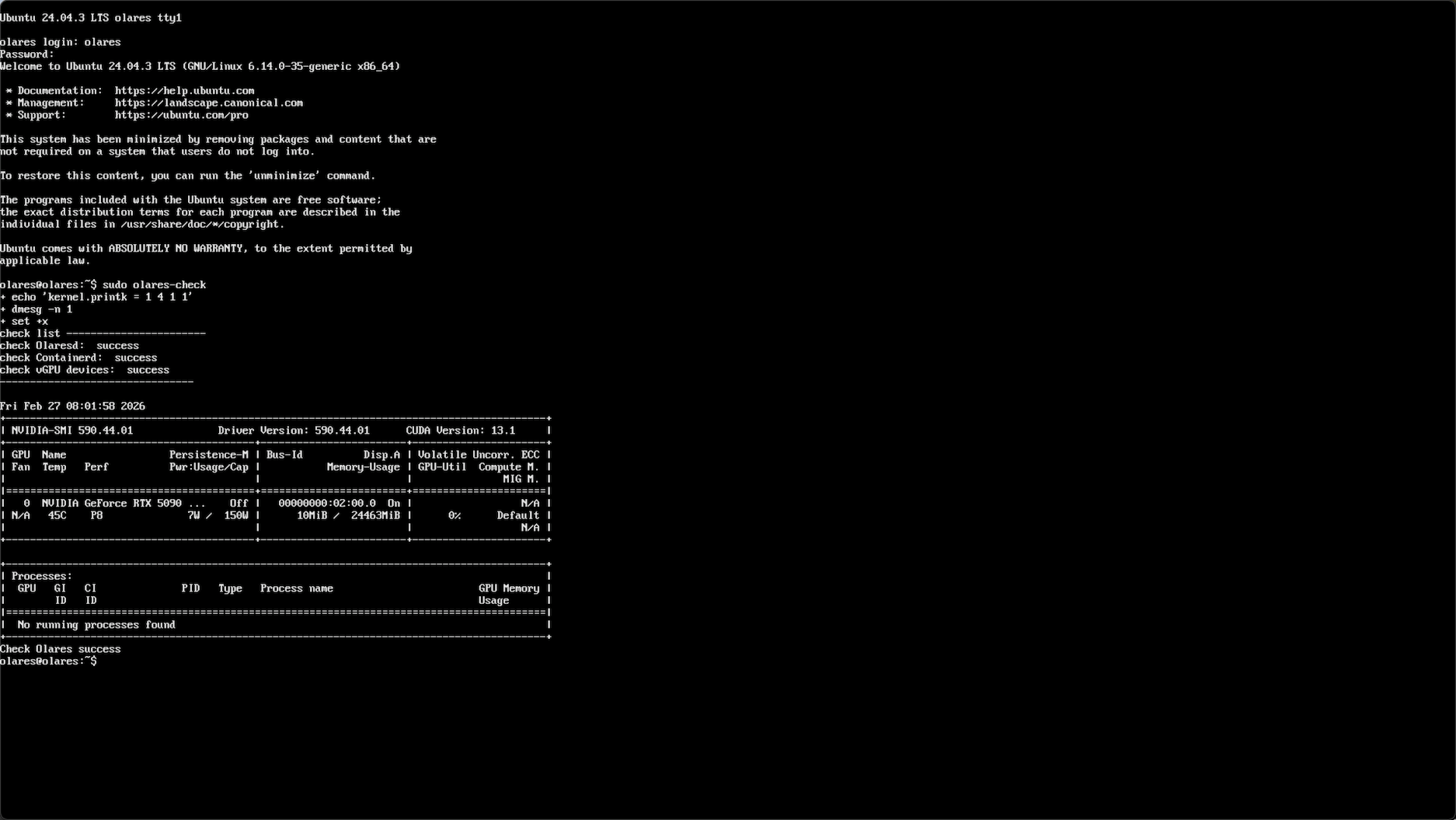

After the reboot, the system starts in a clean factory state and shows a text-based Ubuntu login prompt.
  1. Log in with the default credentials:
    • Username: olares
    • Password: olaresLog in
  2. (Optional) Run the following command to verify the installation:
    sudo olares-check
    Example output: Olares check
