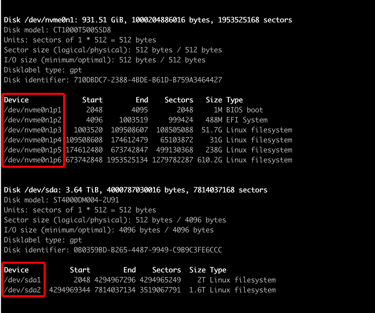

Step 1: Identify the drive ​
  1. Connect to your Olares One terminal via SSH or from the Control Hub.
  2. Run the following command to view detected drives:
    sudo fdisk -l
  3. Identify your target drive from the output. Each drive lists its partitions under the Device column, such as /dev/nvme1n1p1, /dev/nvme1n1p2, or /dev/sdb1.
    Partition list
  4. Note the target partition you intend to mount. For example: /dev/nvme1n1p1.

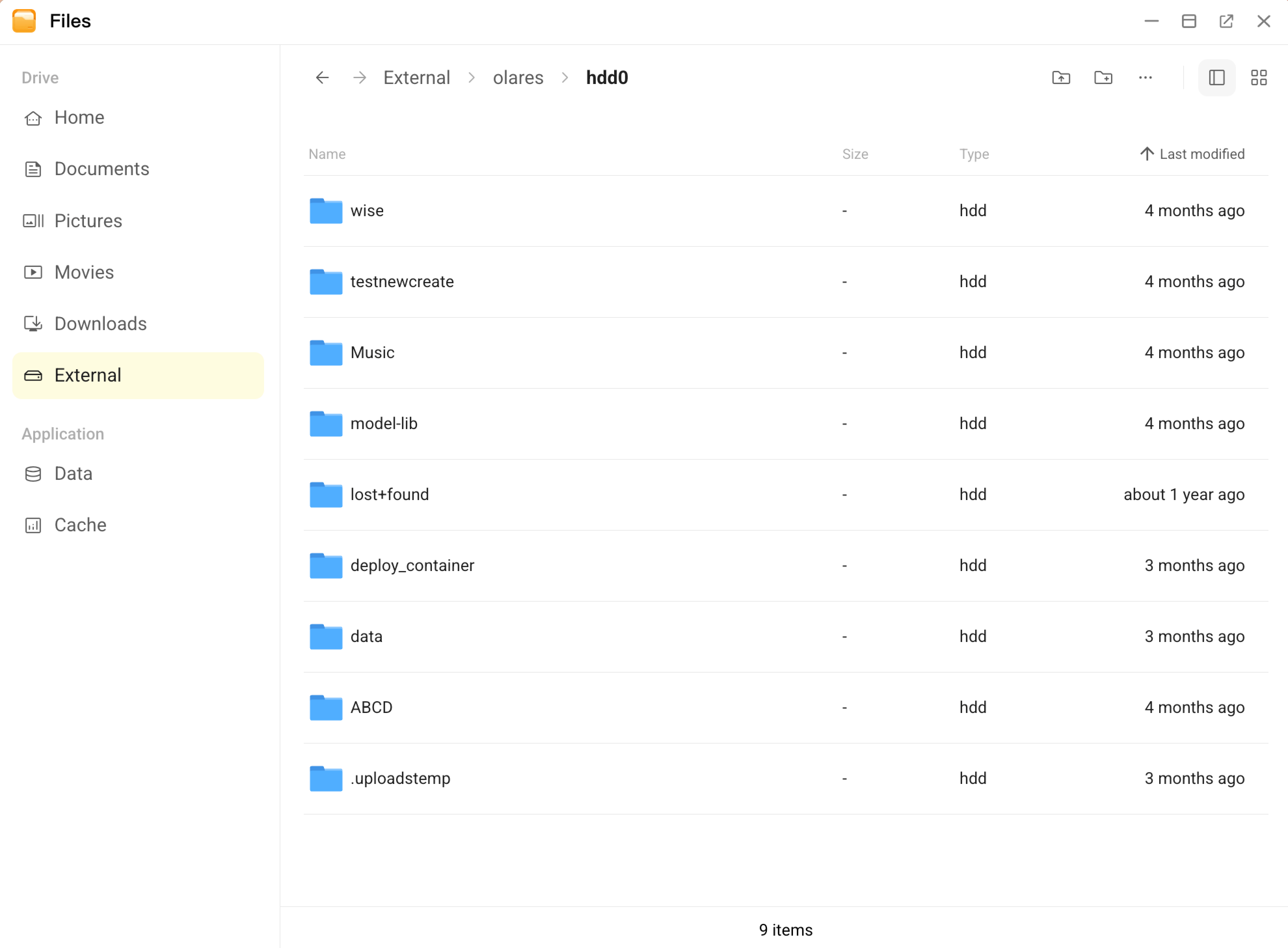

  3. Navigate to the External directory in Files to verify the mount. You should see the new folder content.

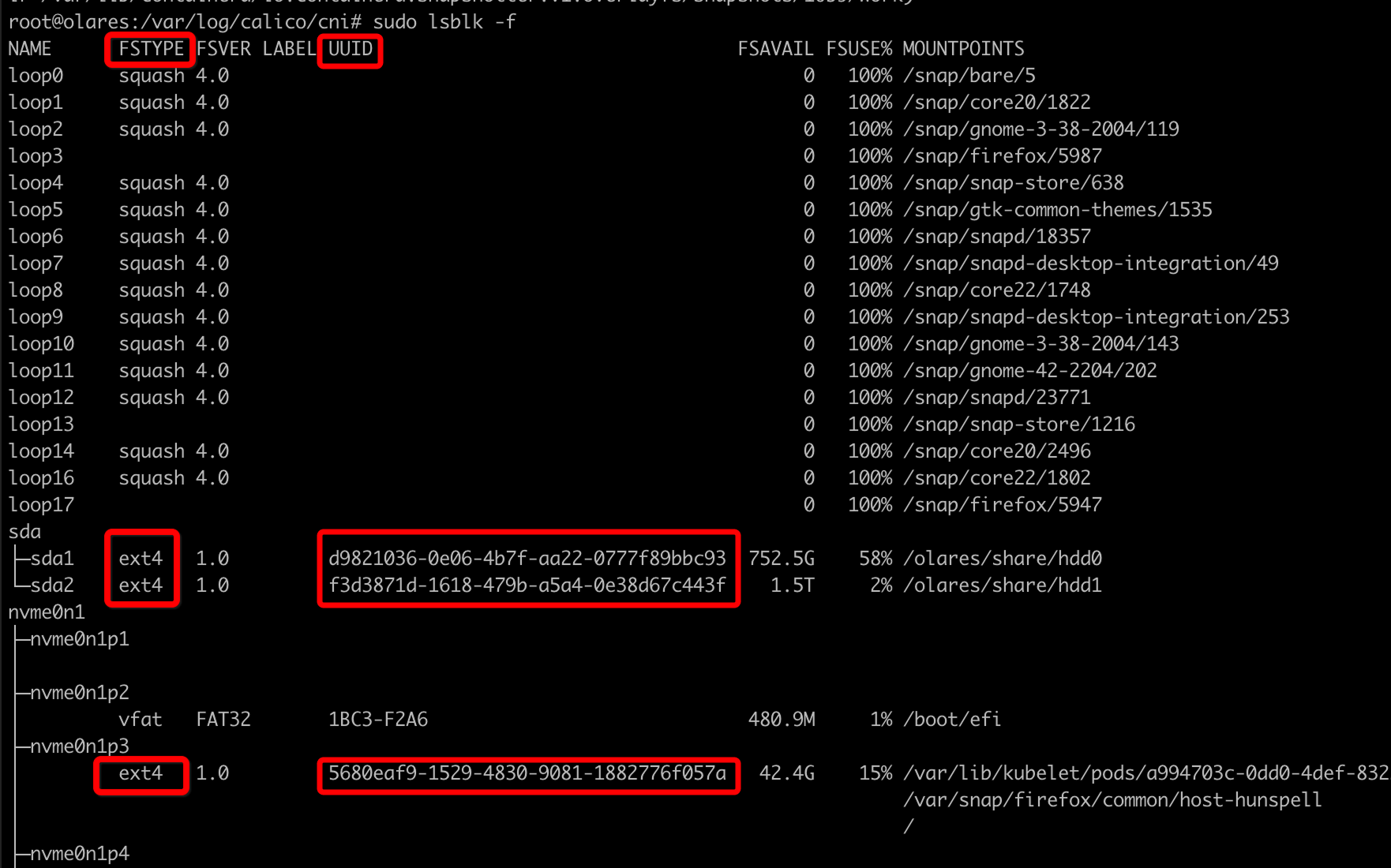

  1. Get the UUID.
    Use UUID to identify device
    Using the UUID is safer than using device names (like /dev/sdb1), which can change if you plug drives into different ports.
    a. Run the following command:
    lsblk -f
    b. Note down following information:
    • FSTYPE: File system type (e.g., ext4, xfs).
    • UUID: Unique identifier of the partition.
    Check mount result
