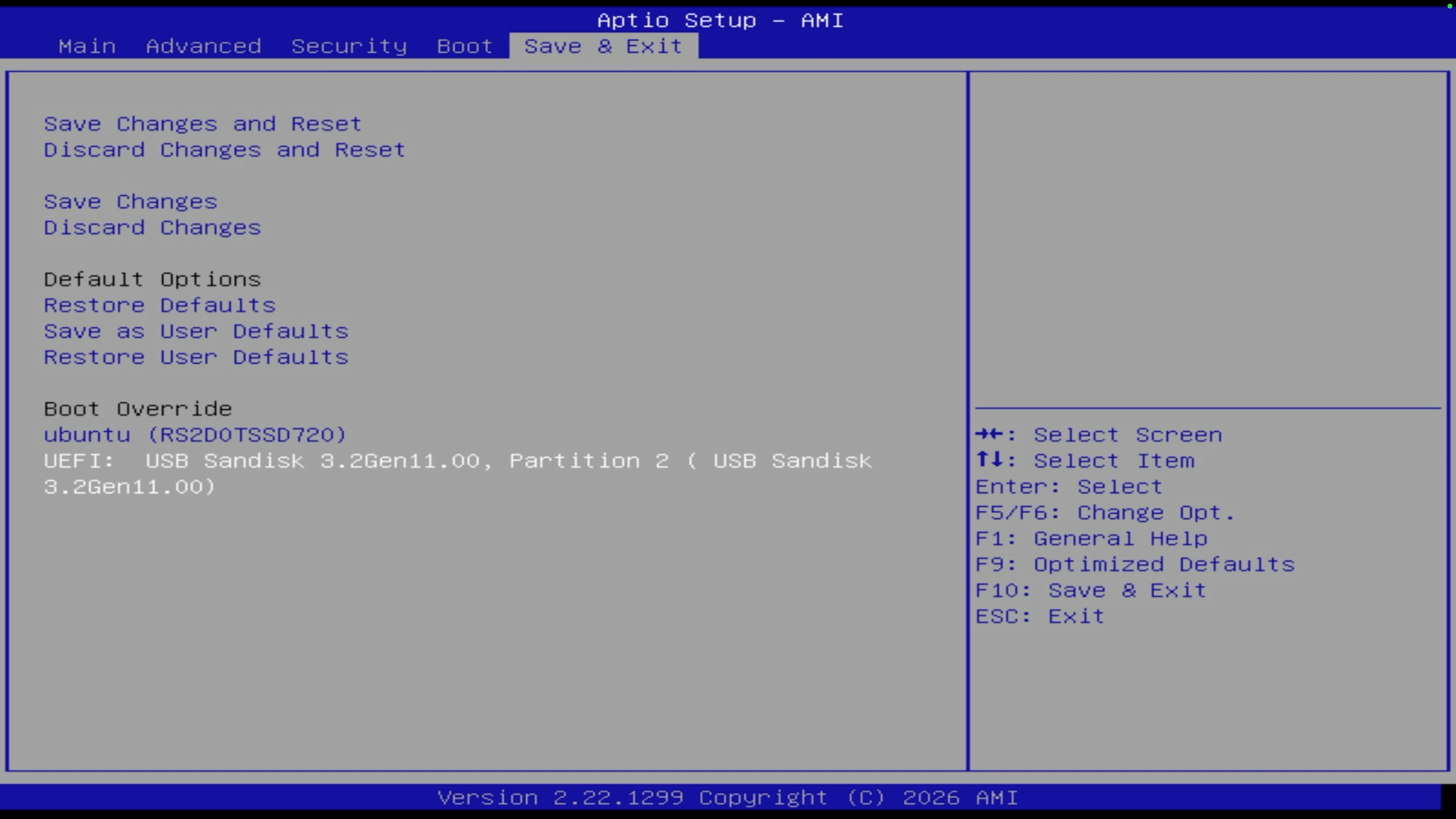

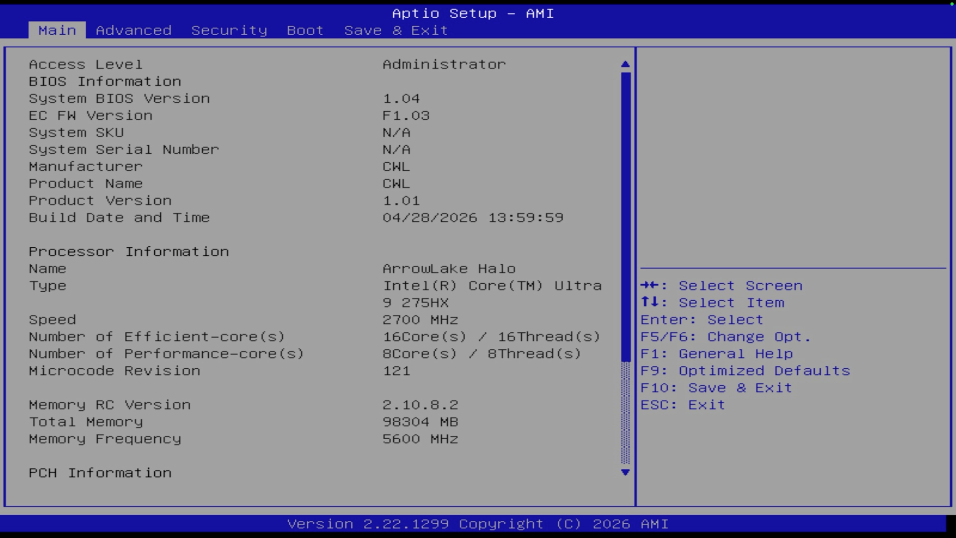

  3. When the Olares logo appears, press the Delete key repeatedly to enter the BIOS setup.
    BIOS setup menu
  4. Go to the Save & Exit tab.
  5. Under the Boot Override section, select your USB drive from the list, and then press Enter.
    Select Ubuntu USB on Boot menu in BIOS
    The system restarts and boots from the USB drive into the Ubuntu Server installation interface.

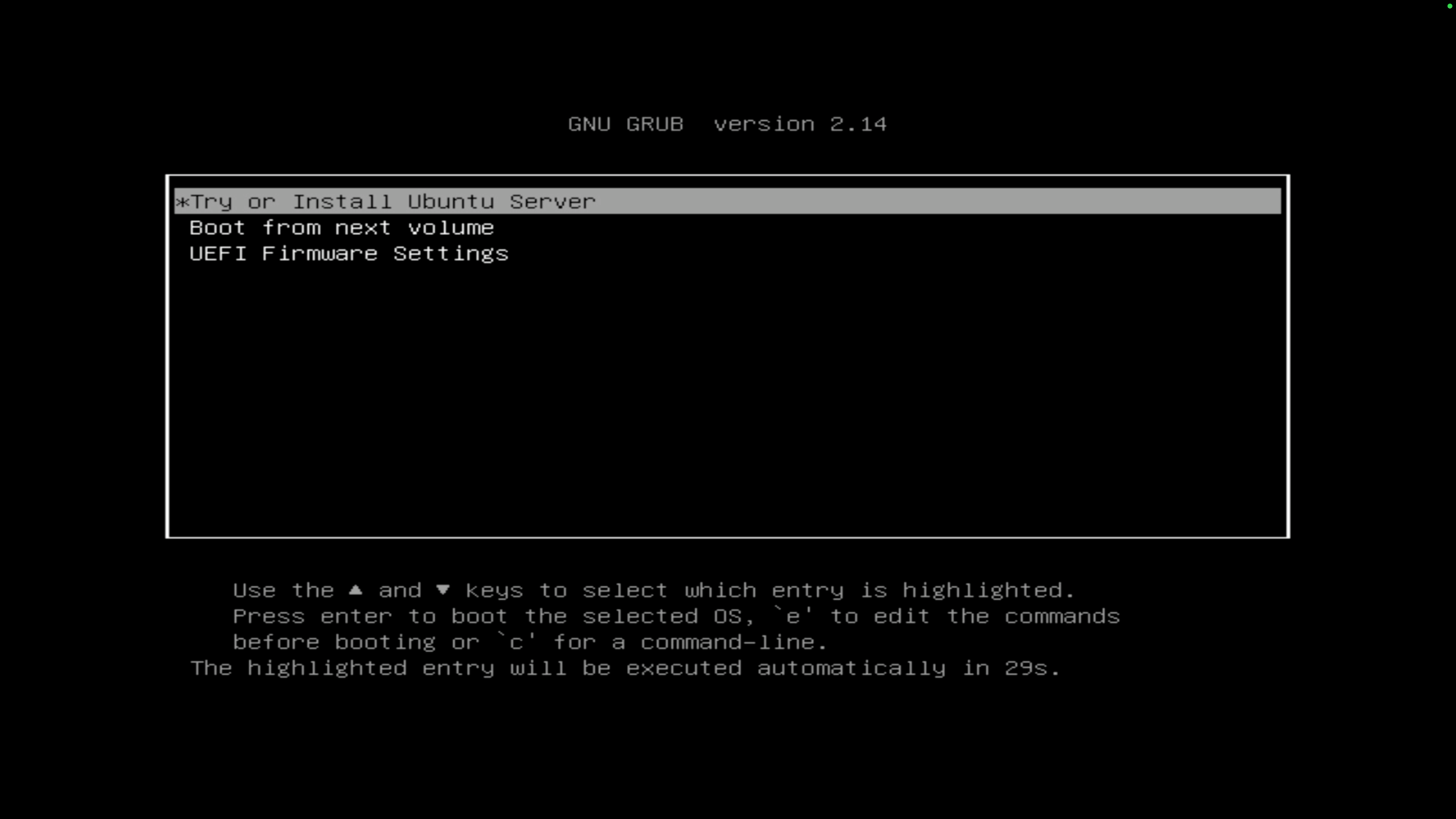

  1. In GNU GRUB, select Try or Install Ubuntu Server. Wait for the initial loading sequence to finish and the language selection screen to appear.
    Ubuntu install type

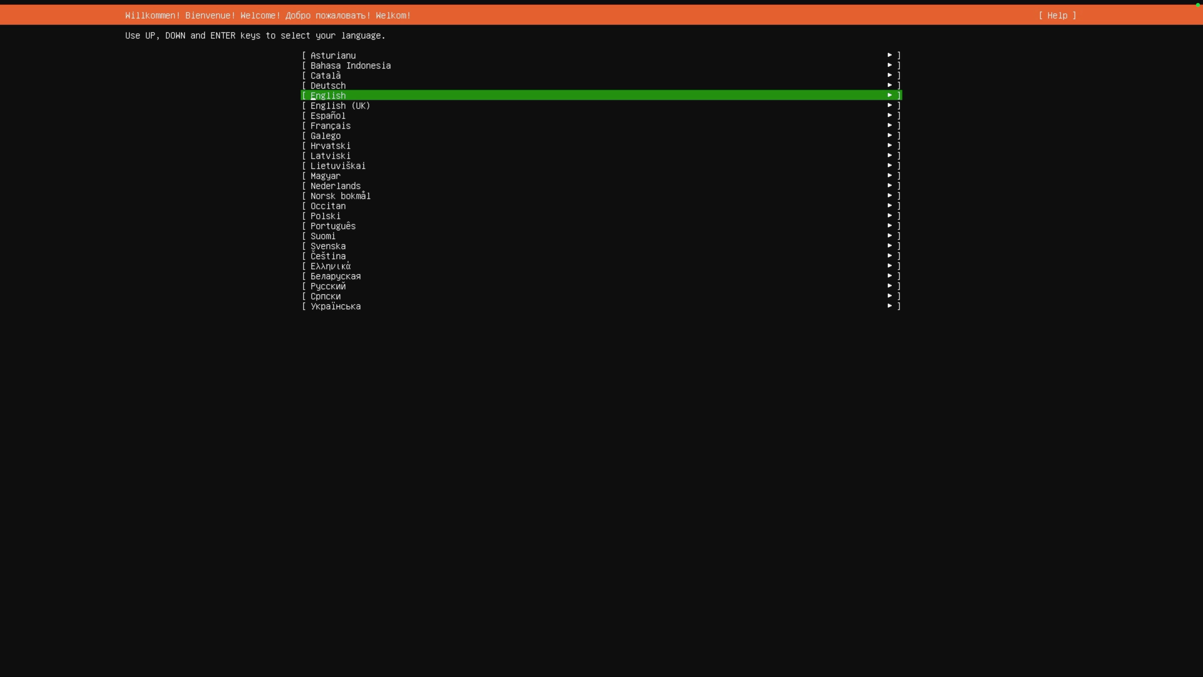

  2. Select your language, and then press Enter.
    Ubuntu language selection

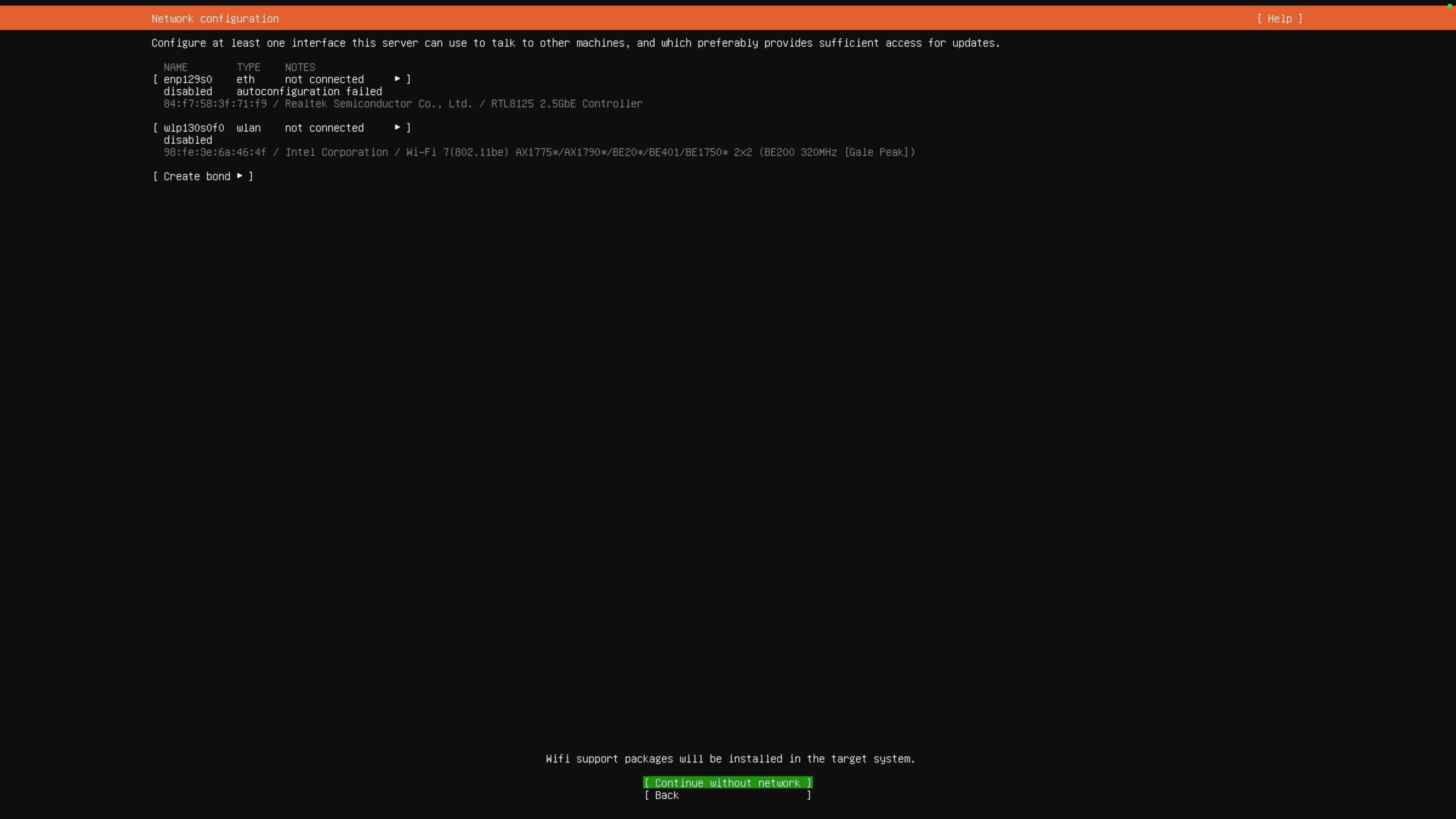

  5. On the Network configuration screen, skip network configuration for now by selecting Continue without network at the bottom, and then press Enter.
    Connecting to the network triggers automatic background downloads for patches and dependencies. This can significantly delay the installation and might cause the installer to hang due to network fluctuations. Skipping this ensures a rapid, completely local installation from the pure ISO image.
    Ubuntu network config

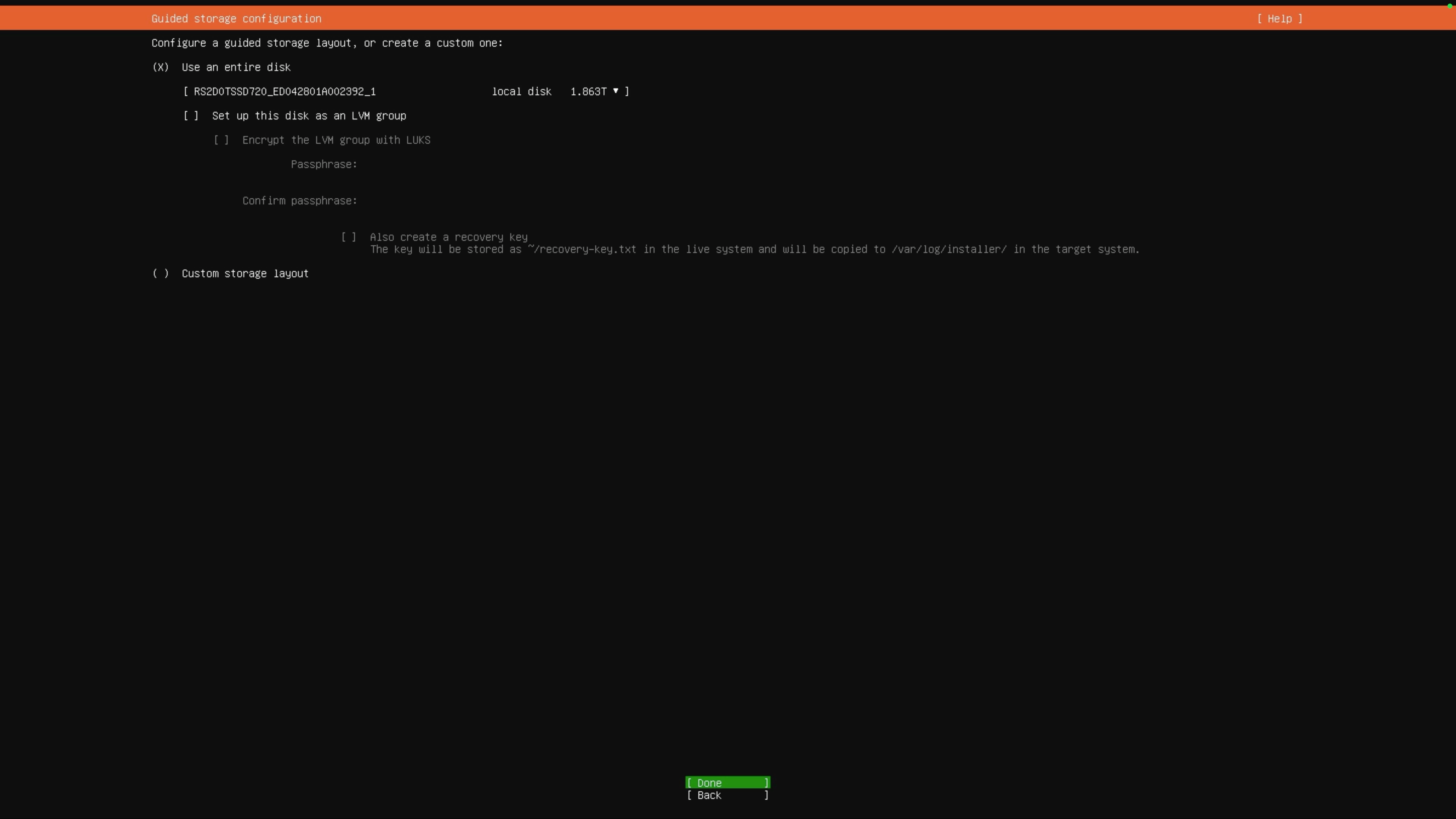

  8. On the Guided storage configuration screen:
    a. Ensure Use an entire disk is selected, and the primary disk containing Olares OS is displayed in the dropdown list below.
    b. Go down to Set up this disk as an LVM group and clear the selection using the Space key.
    Disabling LVM forces the installer to automatically create stable, straightforward standard ext4 partitions. This eliminates unnecessary complexity and ensures a clean, traditional partition layout.
    c. Go to the bottom of the page, select Done, and then press Enter.
    Ubuntu guided storage configuration

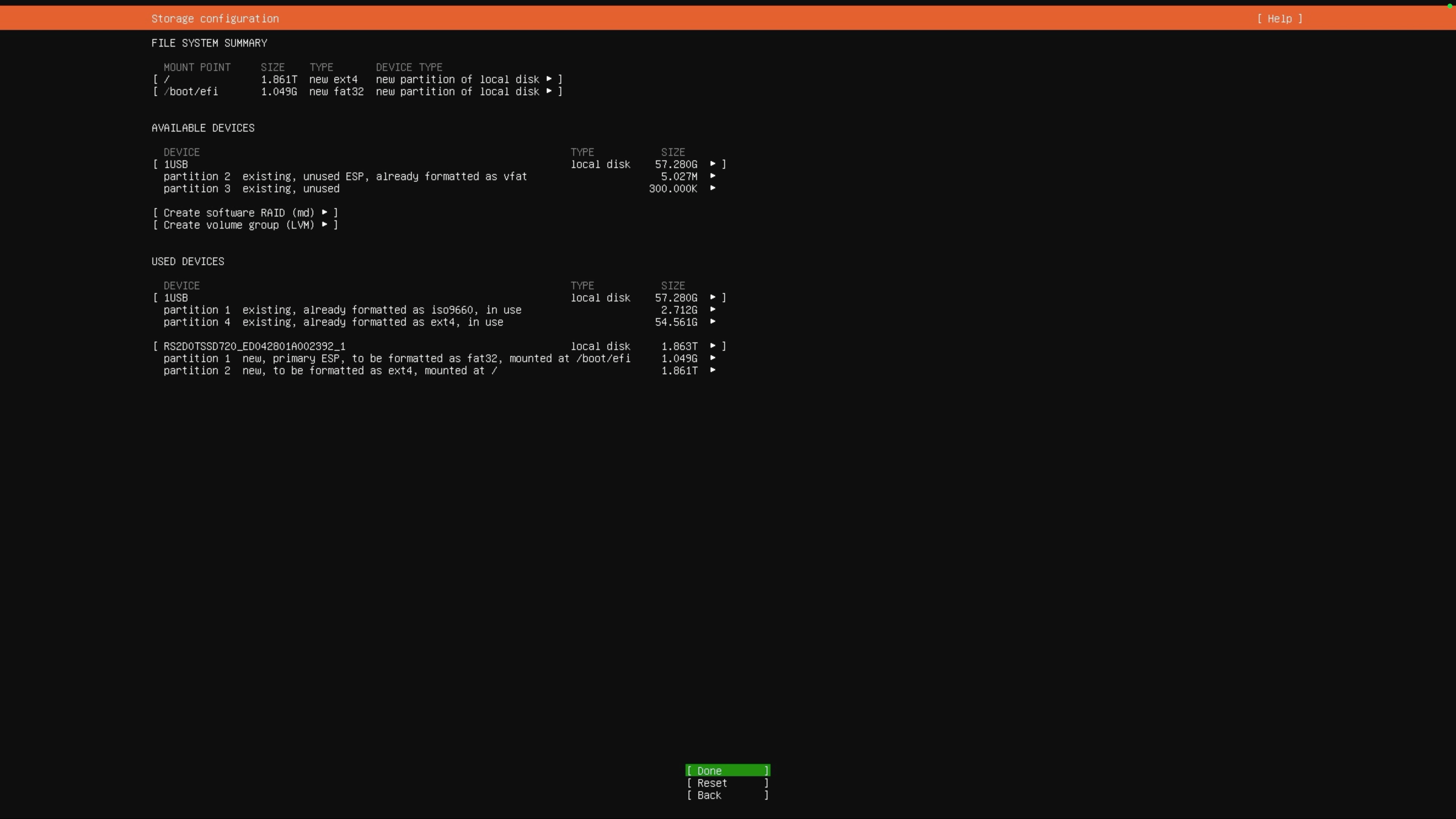

  9. Verify the details on the Storage configuration summary screen. Under USED DEVICES, ensure the primary drive is in the "to be formatted" status, and then press Enter.
    Ubuntu storage configuration summary

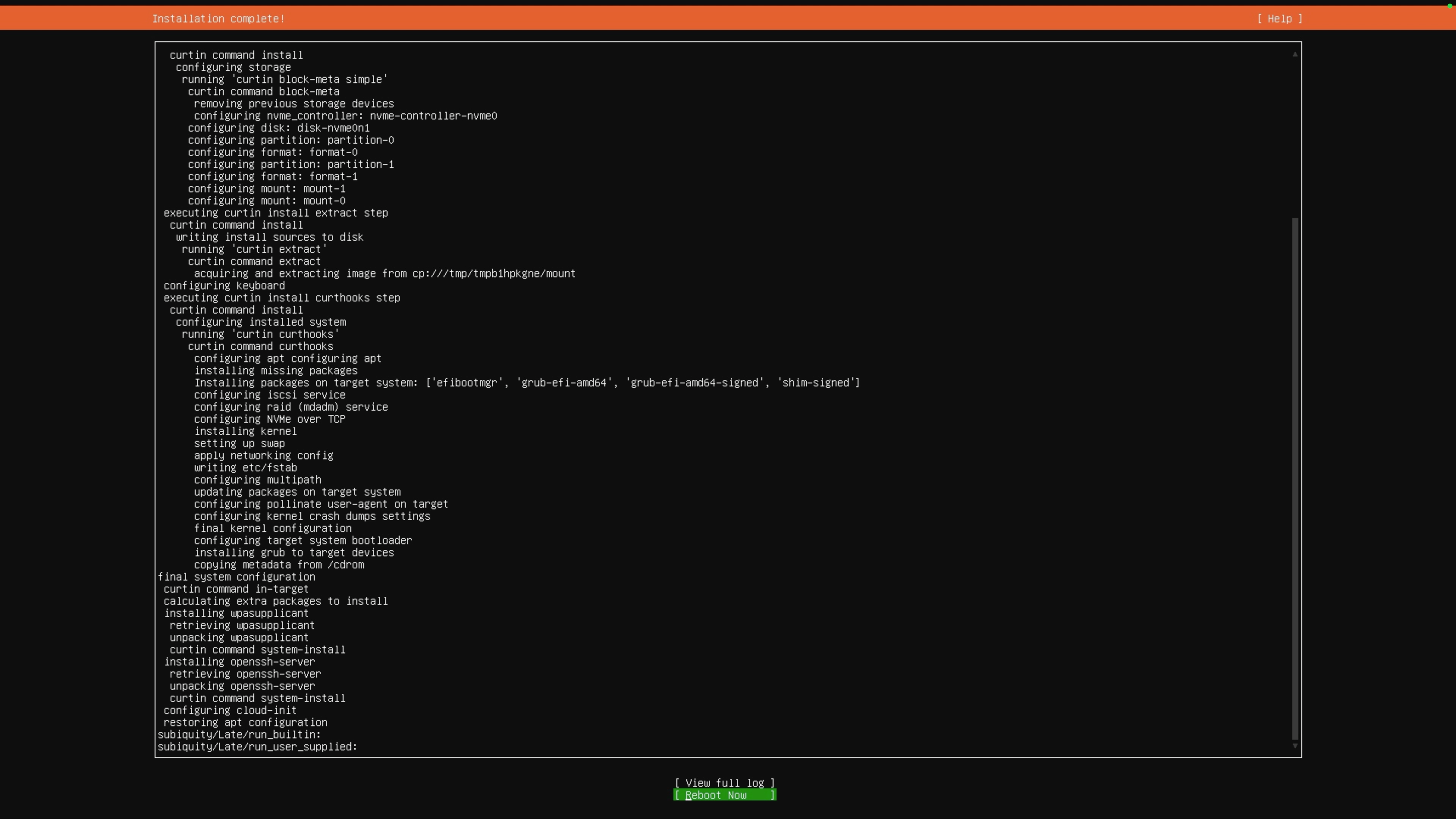

  14. The system begins deployment. Wait for the top banner to display Installation complete.
    Ubuntu installation complete
  15. Select Reboot Now at the bottom, and then press Enter.

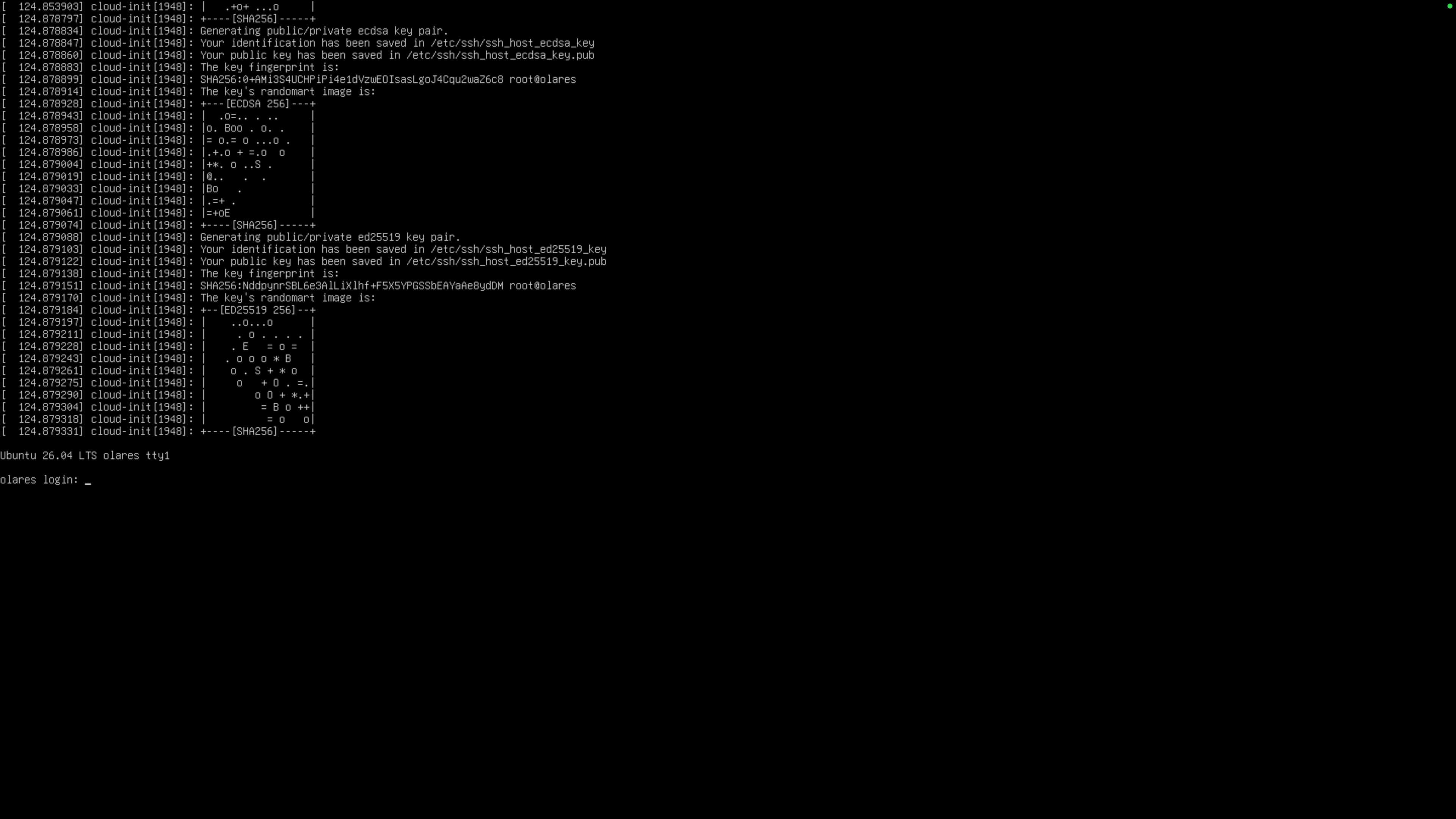

  16. Remove the installation USB drive and press Enter when prompted. The system restarts automatically into your fresh Ubuntu Server environment.
    Ubuntu launch
  17. Log in using the account credentials you set previously.
