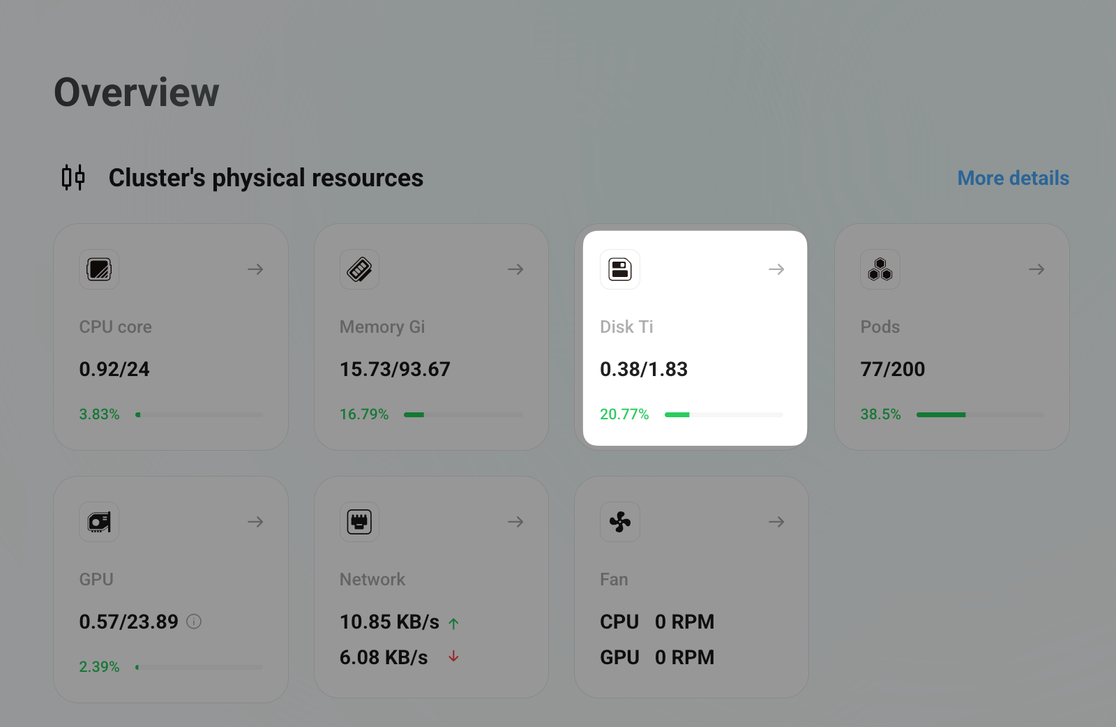

In UI ​
Open Dashboard from Launchpad and confirm that total system storage capacity has increased.
Check disk volume in Dashboard
