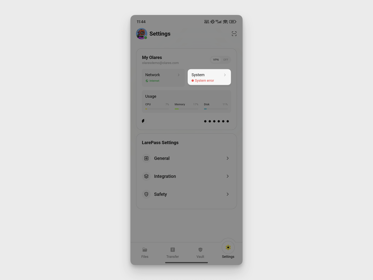

"System error" in LarePass ​
Use this guide when the System section in LarePass displays "System error". There can be multiple underlying causes for this message, so follow the steps below to collect diagnostic information and then share the results with the Olares team.
This guide uses Olares One as an example. If you installed Olares on your own hardware, the diagnostic steps are the same, but the way you access the terminal might differ.
System error in LarePass
Condition ​
  • The System section in LarePass shows System error instead of Running.
  • The Olares desktop might be inaccessible.
Cause ​
The "System error" message usually means one or more system pods are not running normally. When this happens, LarePass cannot retrieve system status.

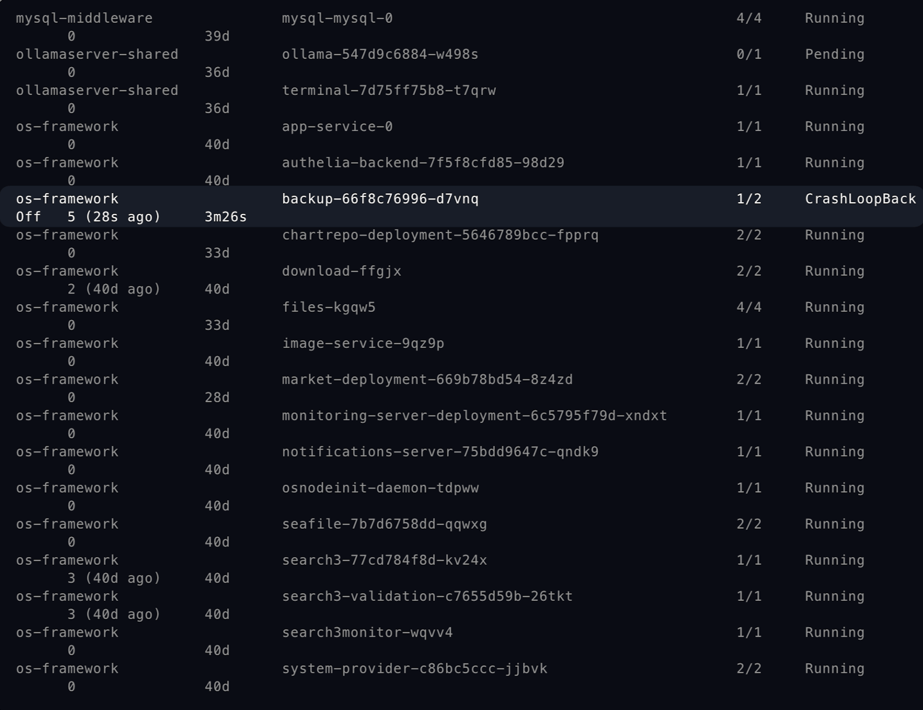

  1. Run the following command to get the status of all pods across all namespaces:
    kubectl get pods -A
  2. Check the STATUS column for any pods that are not in the Running state.
  3. Note the NAMESPACE and NAME of each problematic pod. Locate problematic pod

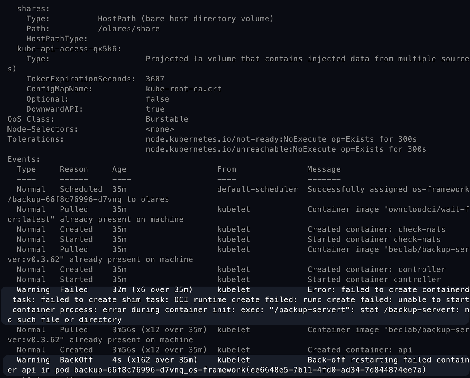

Step 5: Inspect the pod error ​
  1. Run the following command, replacing <namespace> and <pod-name> with the values you noted in the previous step:
    kubectl describe pod <pod-name> -n <namespace>
    For example:
    kubectl describe pod backup-66f8c76996-d7vnq -n os-framework
  2. Scroll down to the Events section to find the detailed error message. Pod event details
