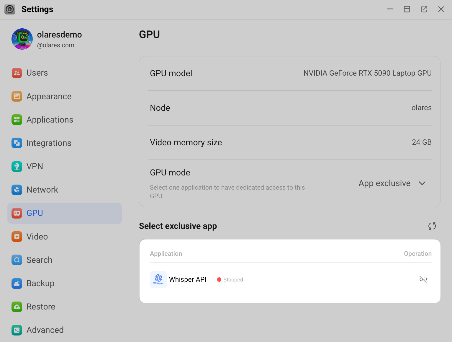

  1. Open Settings > GPU and check which app is currently shown in the Select exclusive app section.
    App shown in App exclusive mode

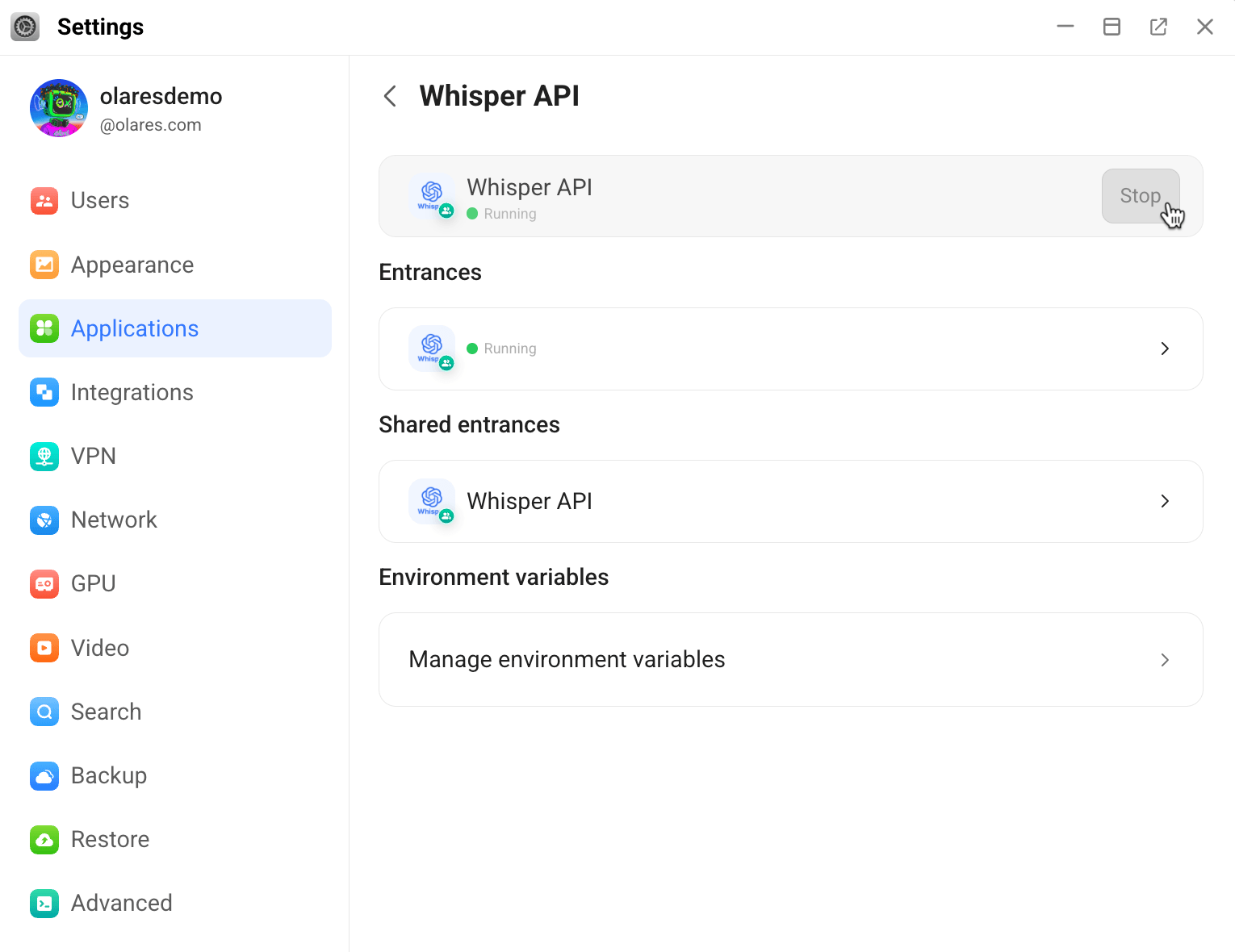

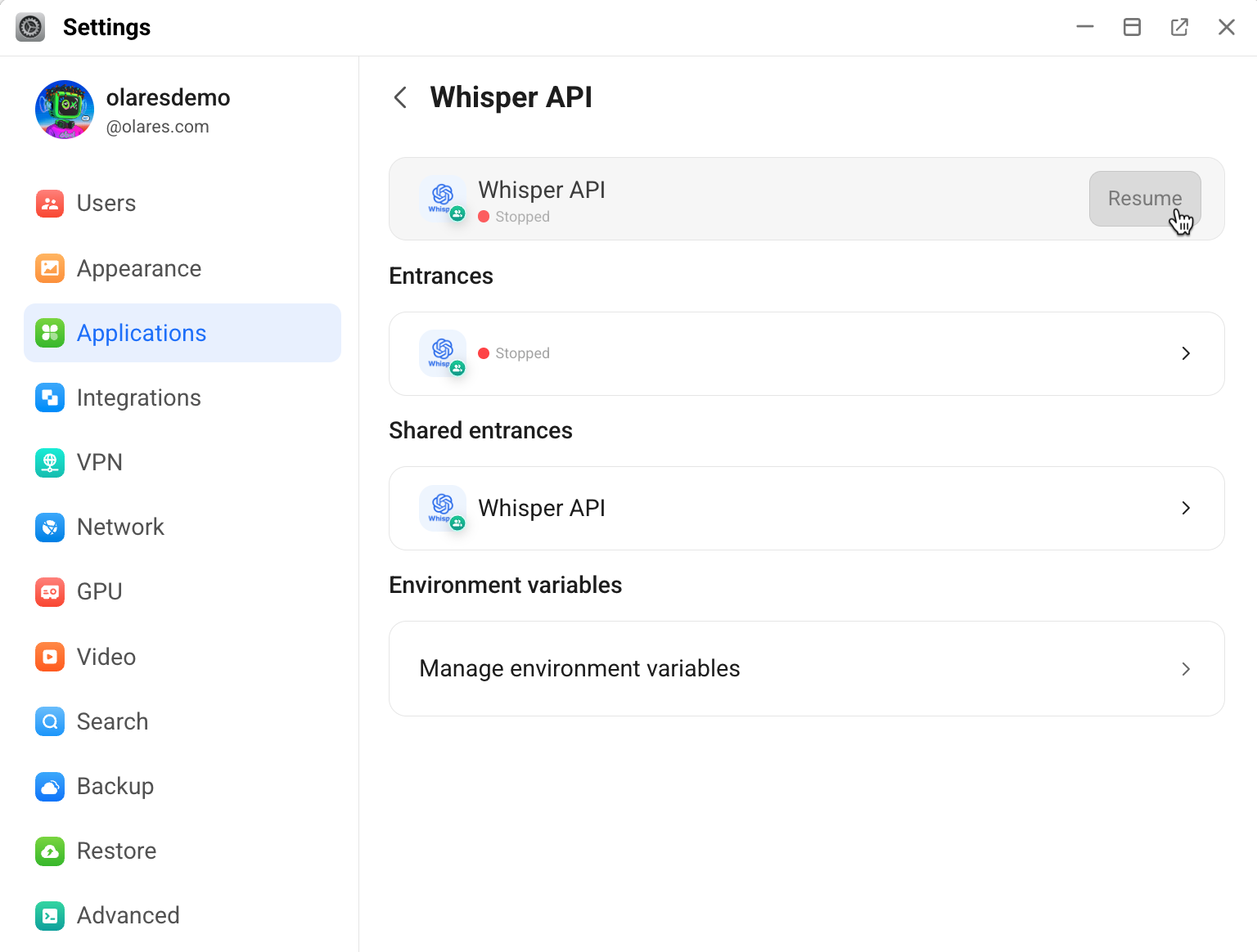

  2. Go to Settings > Applications, find the same app, and then click Resume.
    Resume the app
  3. Wait a few moments for the app to start, and then click Stop.

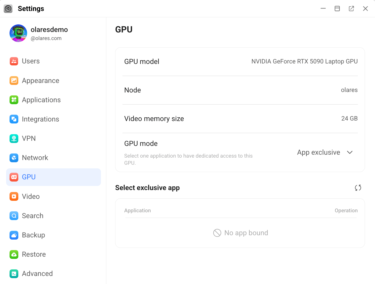

  4. Go back to Settings > GPU, and then click link_off to remove the app again.
  5. Refresh the list and verify that the app no longer appears in the Select exclusive app section.
    Check App exclusive mode again
