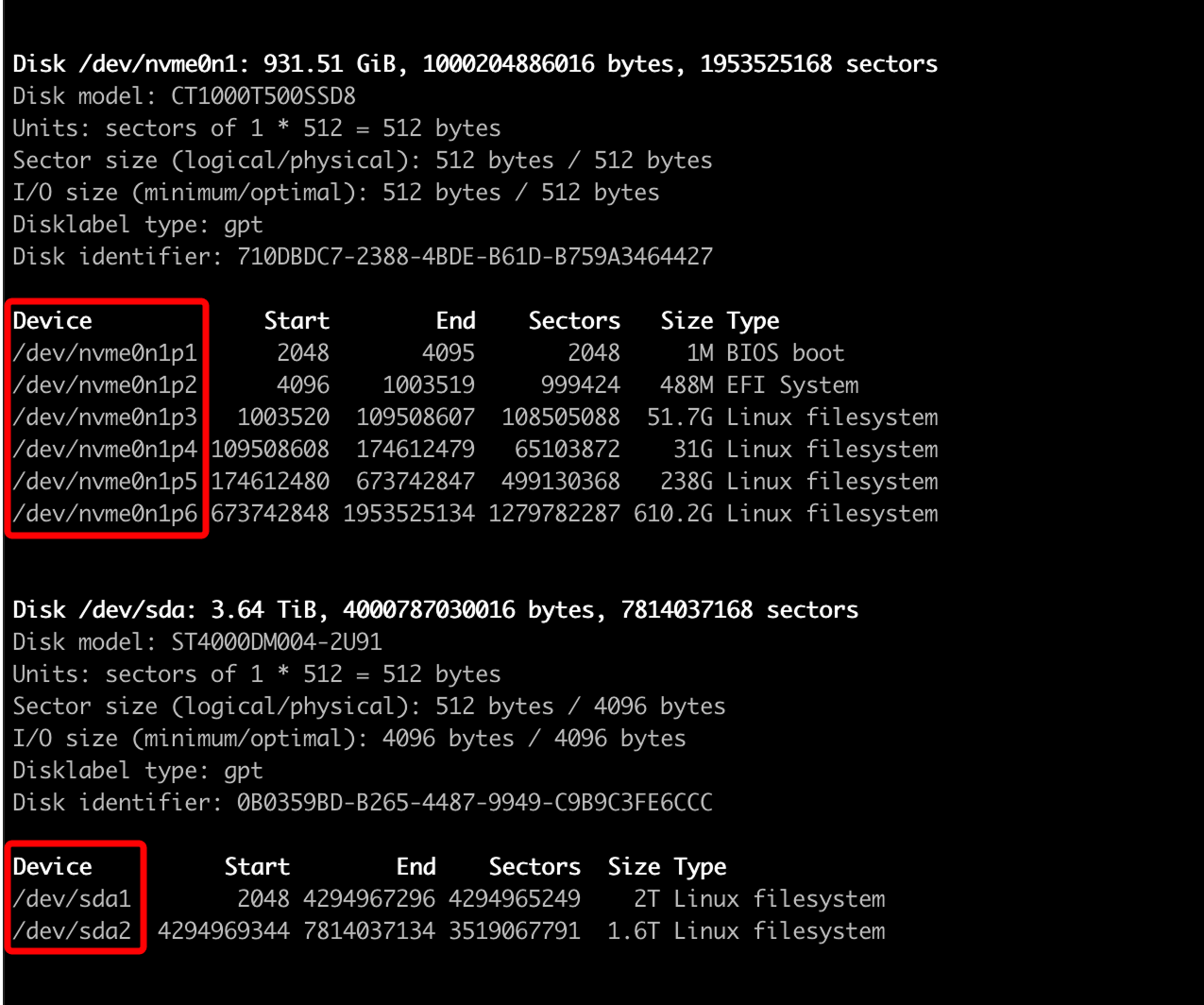

  1. Insert the hard drive into the host machine.
  2. Run the following command to view detected drives:
    fdisk -l
  3. Identify the target drive type and device name from the output:
    • NVMe SSD: typically appear as /dev/nvme0n1, /dev/nvme1n1, etc.
    • SATA or HDD: typically appear as /dev/sda, /dev/sdb, etc.
    Each drive lists its partitions under the Device column, such as /dev/nvme1n1p1, /dev/nvme1n1p2, or /dev/sdb1. Partition list
  4. Confirm the target partition to mount (e.g., /dev/nvme1n1p1).

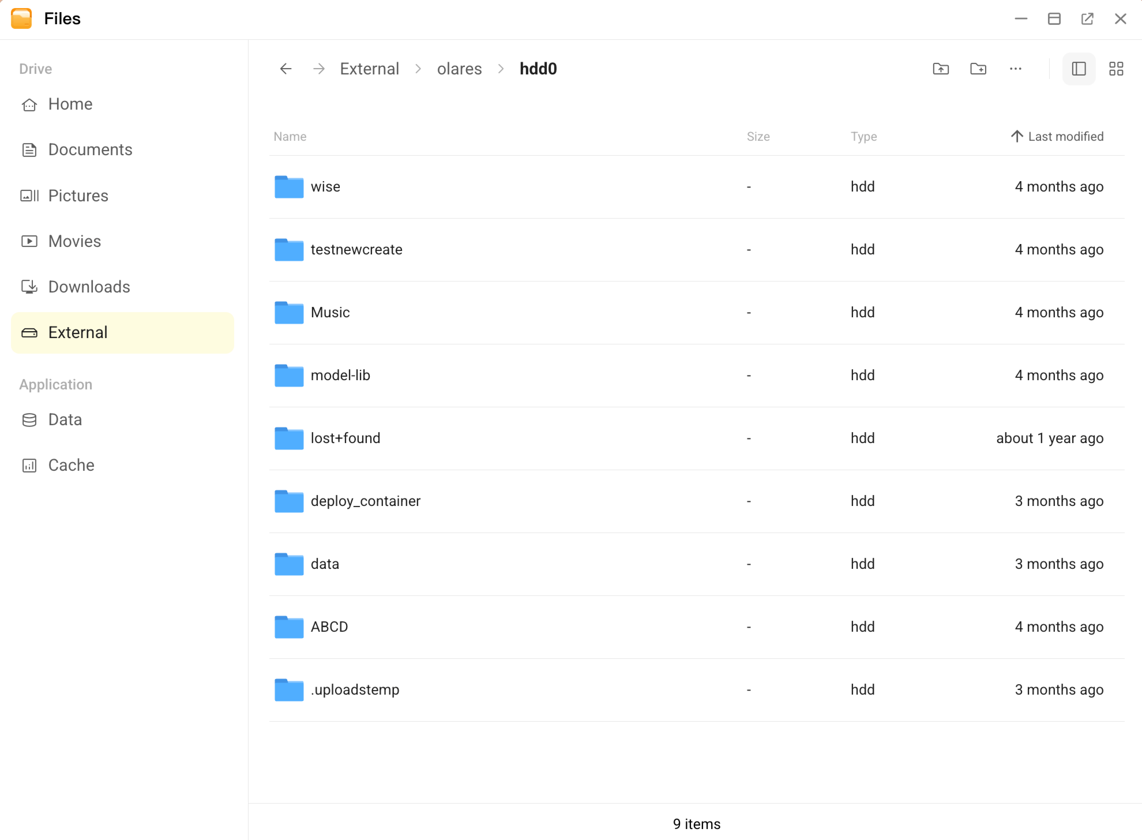

    sudo mount /dev/nvme1n1p1 /olares/share/hdd0
  3. Verify the mount result:
    After successful mounting, you can access the partition from Files > External.

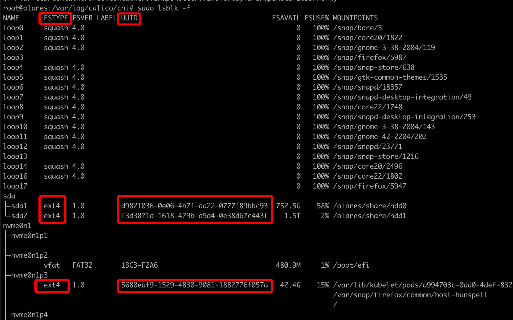

  1. Run the following command to list all drives and find the target partition:
    lsblk -f
    Record the following information:
    • FSTYPE: File system type (e.g., ext4, xfs).
    • UUID: Unique identifier of the partition.
