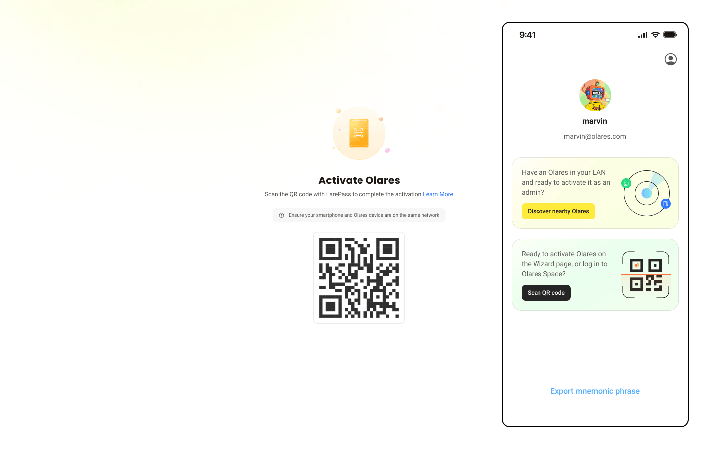

Activate after one-line script installation ​
If you installed Olares via the one-line script and completed the initial setup in the wizard:
Activate Olares
  1. Open LarePass app.
  2. Tap Scan QR code to scan the QR code on the Wizard page.
  3. Follow the on-screen instructions on LarePass to reset the login password for Olares.
After successful activation, the LarePass app will automatically return to the home screen, and the Wizard will redirect you to the login page.

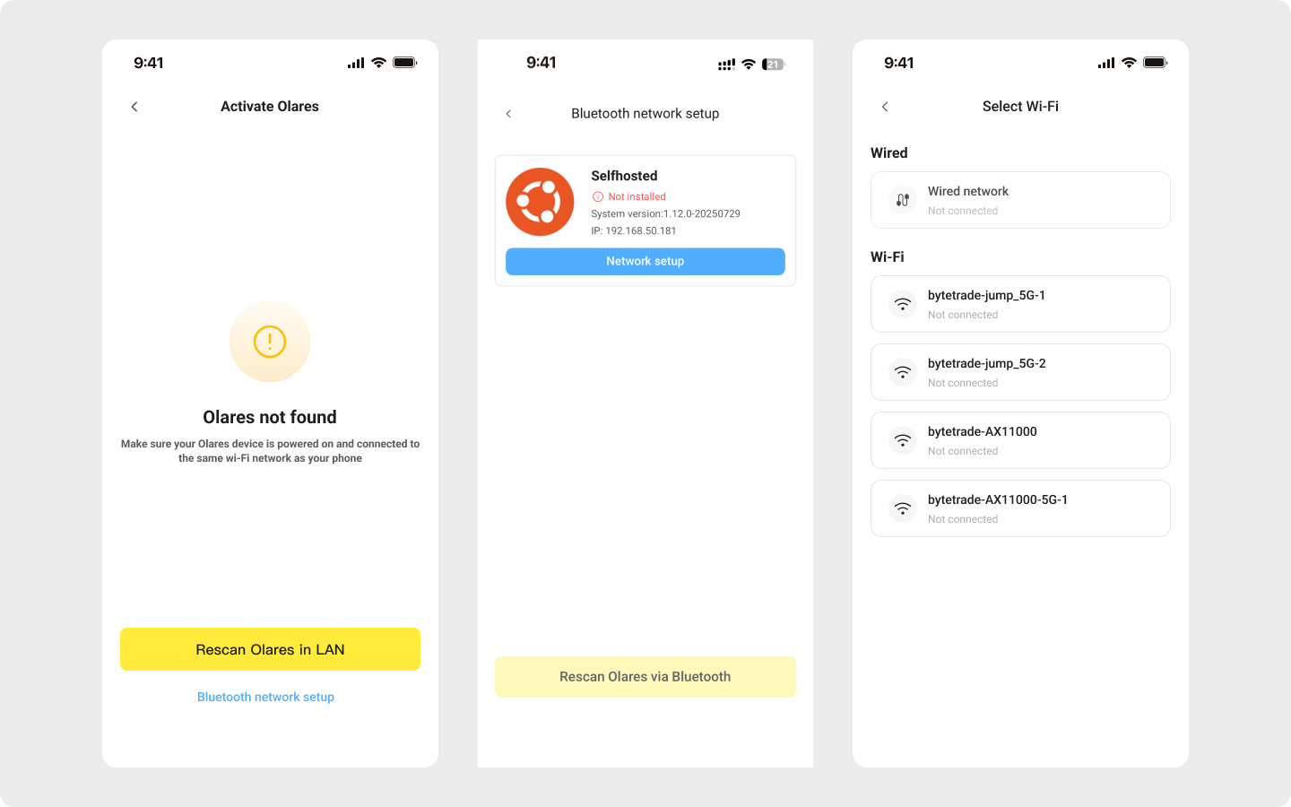

Activate Olares using Bluetooth ​
Use this method if LarePass cannot find your Olares device. This can happen if Olares is not on a wired network or if your phone is on a different network.
By using Bluetooth, you can connect Olares directly to your phone's current Wi-Fi network and continue the activation process. Bluetooth network
  1. On the Olares not found page, tap Bluetooth network setup. LarePass will use your phone's Bluetooth to scan for the nearby Olares device.
  2. When your device appears in the list, tap Network setup.
  3. Select the Wi-Fi network your phone is currently connected to. If the network is password-protected, enter the password and tap Confirm.
  4. Olares will begin connecting to the Wi-Fi network. Once the process is complete, a success message will appear. If you return to the Bluetooth network setup page, you'll see that Olares' IP address has changed to your phone's Wi-Fi subnet.
  5. Go back to the device scan page and tap Discover nearby Olares to find your device and proceed with activation.

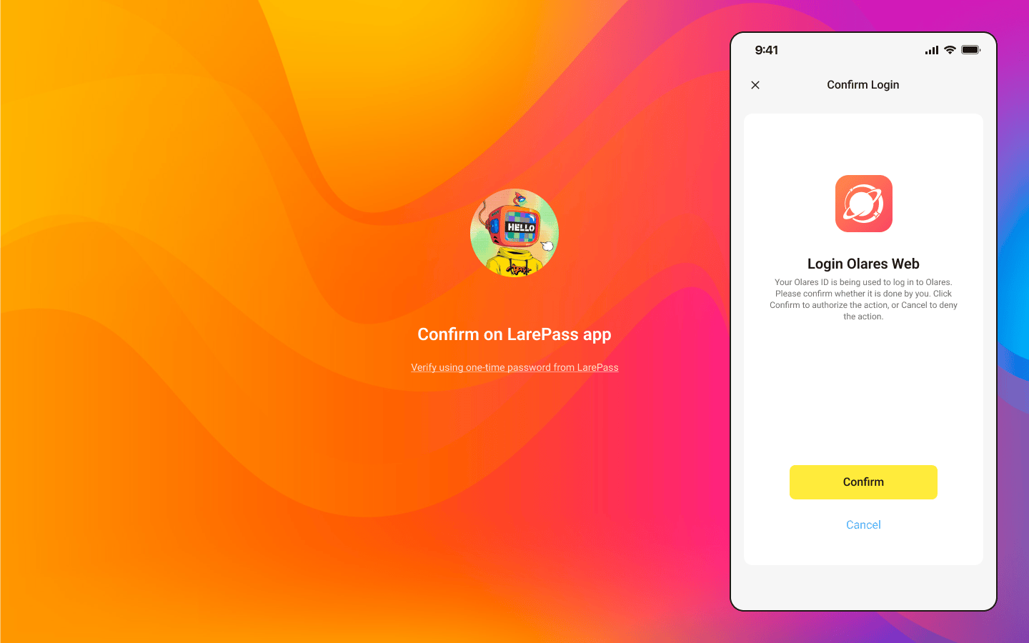

When you log in to Olares, you will be promoted to complete the two-factor verification. You can either confirm the login directly in LarePass app or manually enter a 6-digit verification code.
  • To confirm login on LarePass: 2FA
    1. Open the login notification on your phone.
    2. In the message, click Confirm to complete the login process.

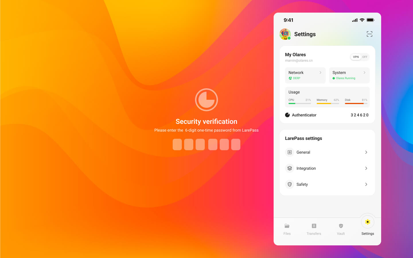

  • To manually enter the verification code: OTP
    1. On the Wizard page, select Verify using one time password from LarePass.
    2. Open LarePass on your phone and go to Settings.
    3. In the My Olares card, tap the authenticator to generate a one time verification code.
    4. Return to your Wizard page and enter the code to complete the login.
After successful verification, you'll be redirected to the Olares desktop.
