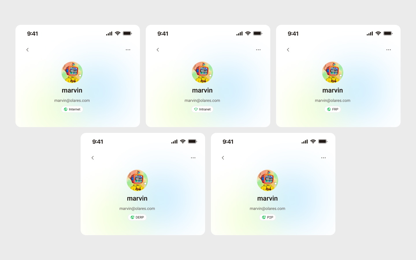

Understand connection status ​
LarePass displays the connection status between your device and Olares, helping you understand or diagnose your current network connection.
Connection status
StatusDescription
InternetConnected to Olares via the public internet
IntranetConnected to Olares via the local network
FRPConnected to Olares via FRP
DERPConnected to Olares via VPN using DERP relay
P2PConnected to Olares via VPN using P2P connection
Offline modeCurrently offline, unable to connect to Olares
When accessing private entrances from an external environment through VPN, if the status shows "DERP", it indicates that the VPN cannot directly connect to Olares via P2P and must use Tailscale's relay servers. This status may affect connection quality. If you constantly encounter this situation, please contact Olares support for assistance.

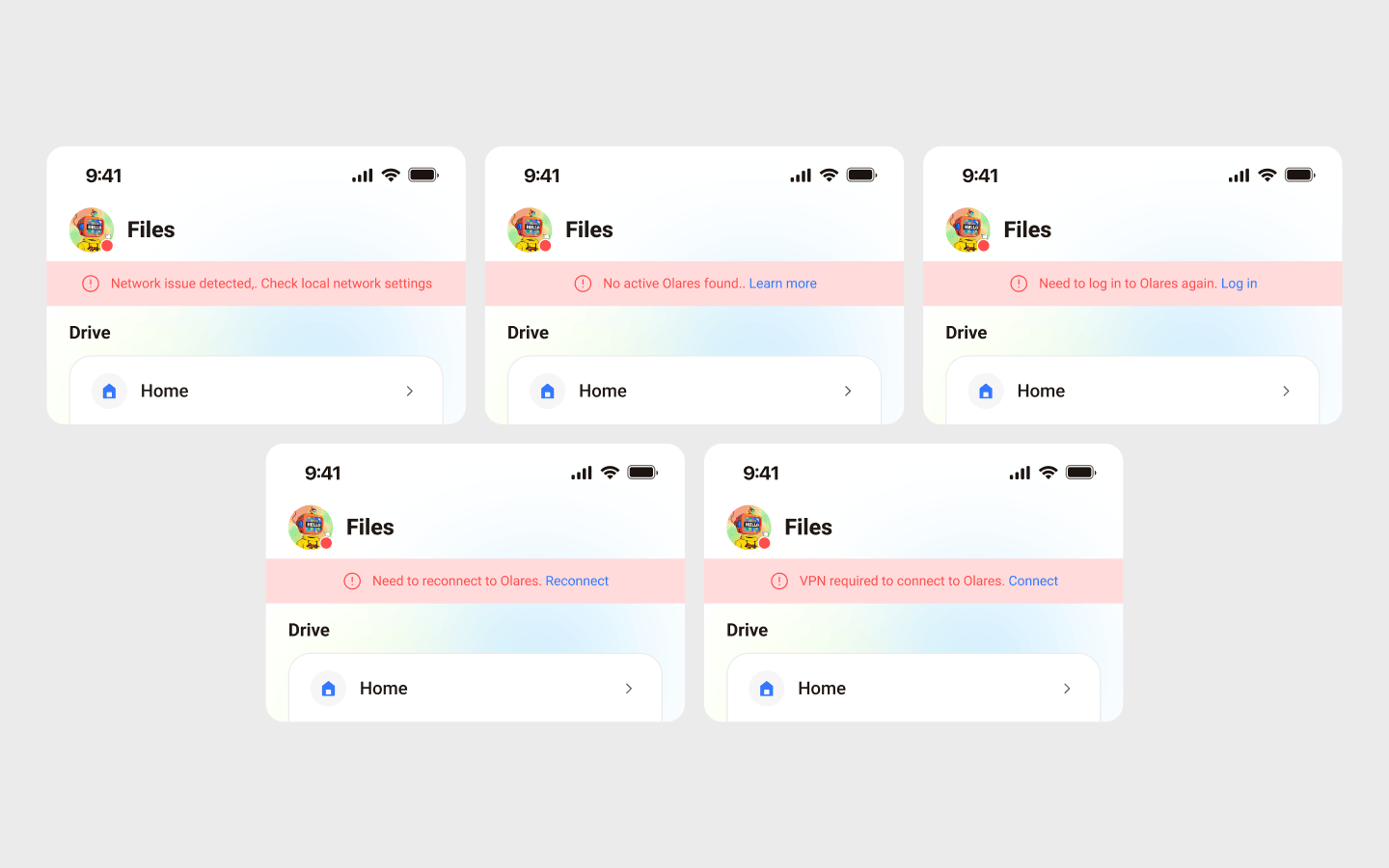

Troubleshoot connection issues ​
If you encounter connection problems, LarePass will display diagnostic messages to help you resolve the issue. Here are some common scenarios and how to address them:
Abnormal status
Status messagePossible cause and recommended actions
Network issue detected. Check local network settings.Local network issue
1. Wait for automatic reconnection.
The system will detect network recovery
and sync data.
2. Check your local network settings if
the issue persists.
VPN required to connect to Olares.VPN not enabled
Click the notification banner and follow
prompts to enable VPN connection.
Need to log in to Olares again.Session expired or authentication issue
prompts to log in.
Need to reconnect to Olares.Connection interrupted or timed out
prompts to log in. After re-login, Vault
data will sync and merge with the server.
No active Olares found.Temporary network issue or Olares is restarting
or shutting down
Wait for automatic recovery. This
usually resolves shortly.
Olares instance no longer exists
1. Click the notification banner and follow
prompts to reactivate Olares, enable offline
mode or ignore notification.
2. Contact Olares Admin if the issue persists.
