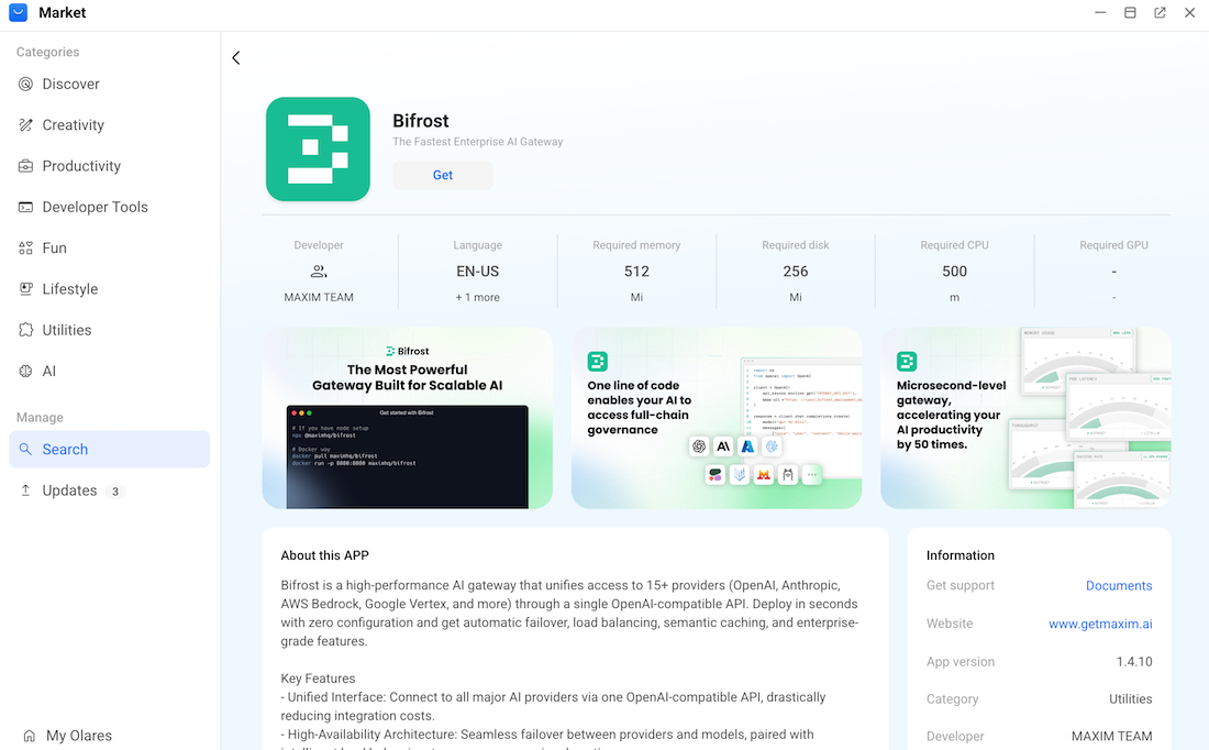

Install Bifrost ​
  1. Open Market and search for "Bifrost".
    Bifrost in Market

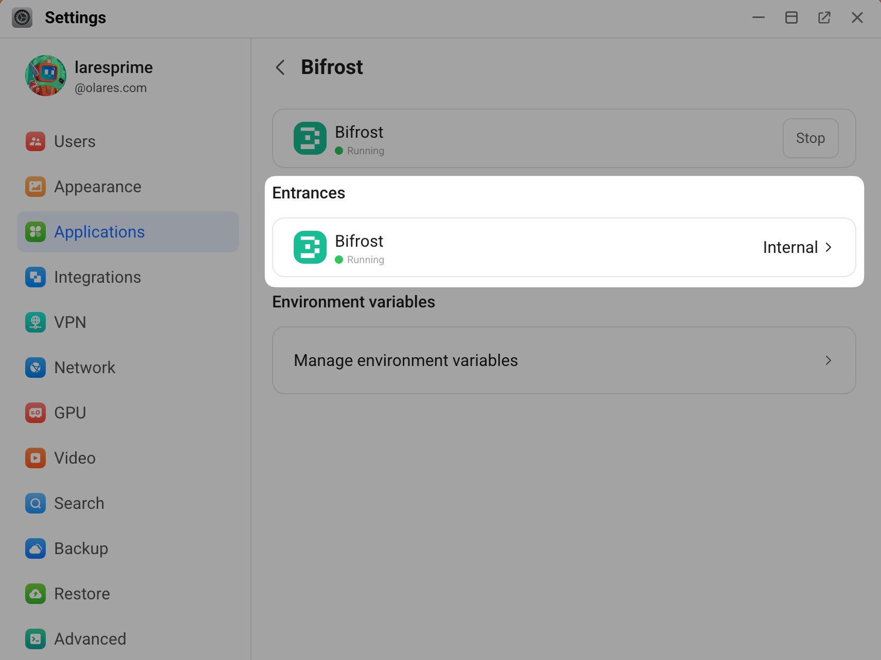

  1. Open Settings, go to Applications > Bifrost > Entrances > Bifrost, and then copy the endpoint URL. For example:
    plain
    https://44039dc0.laresprime.olares.com
    Bifrost endpoint in Settings
  2. When you configure a client, always append /v1 to this Bifrost endpoint URL. For example:
    plain
    https://44039dc0.laresprime.olares.com/v1
The /v1 suffix is required for OpenAI-compatible clients. Without it, requests fail.

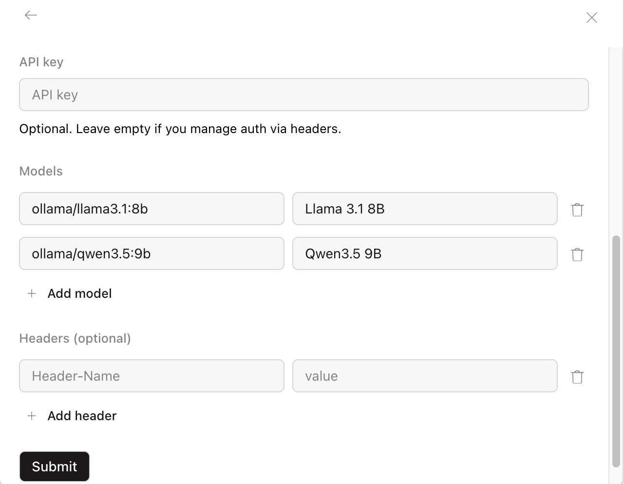

  3. Add one row per model. Click Add model to insert more rows as needed, and specify each row as follows:
    • Model ID: Use the format ollama/<model-name>, where <model-name> is the exact model name on the backend.
      • For an Ollama model, use the name shown in Ollama. For example, ollama/llama3.1:8b.
      • For a single-model app, use the model name shown on the app page. For example, ollama/qwen3.5:9b. Model name on the model app page
    • Display name: Any friendly label, such as Llama 3.1 8B or Qwen3.5 9B. Add models in OpenCode
    • You must append /v1 to the Bifrost URL. Without it, OpenCode returns an error.
    • You must include the ollama/ prefix on model IDs. Without it, API calls fail.
    • The model name you enter must exactly match the name of the downloaded model in your Ollama instance. To find the exact names of your downloaded models, run ollama list in the Ollama terminal.

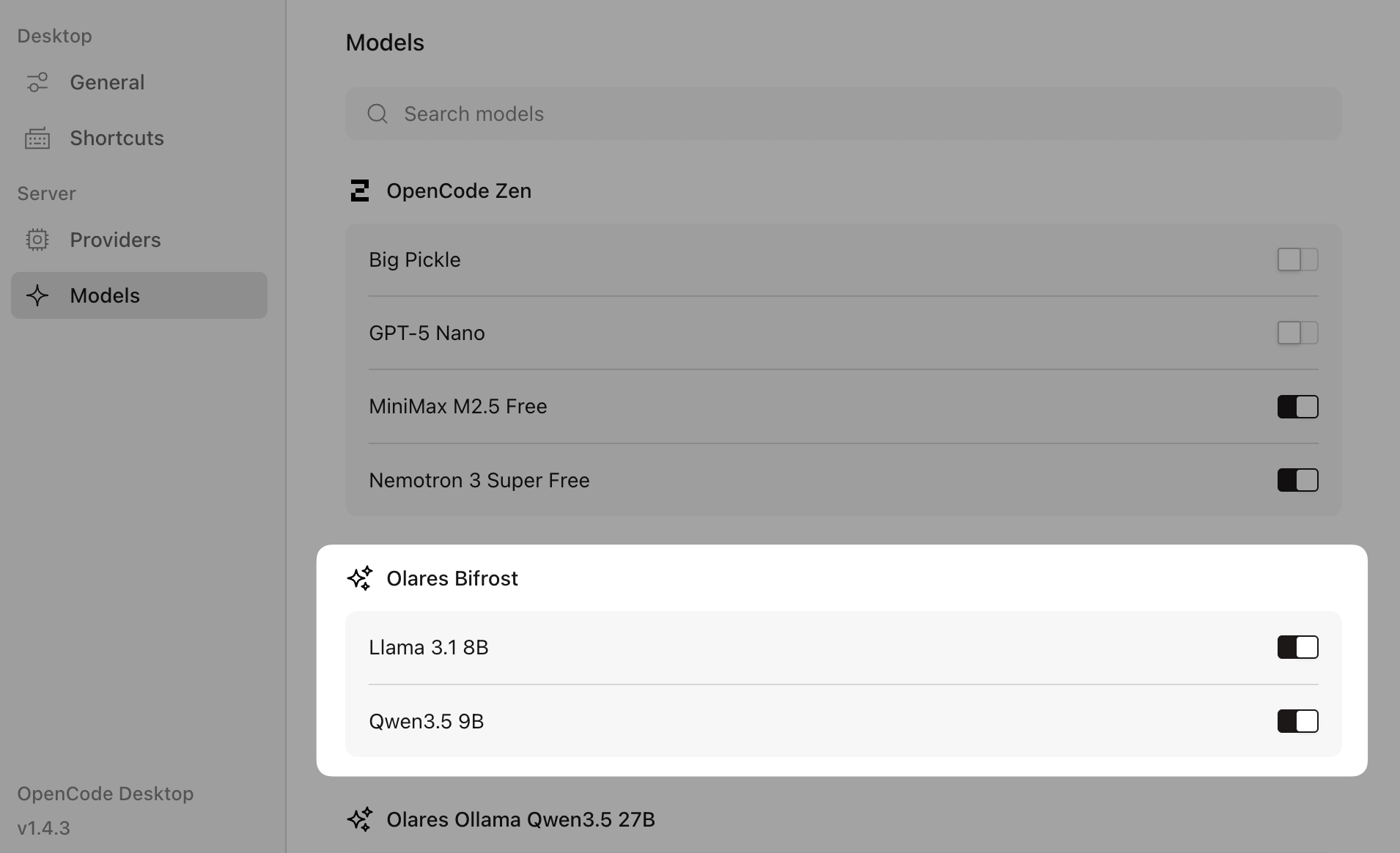

  5. Return to OpenCode, and then go to Settings > Models > Olares Bifrost.
  6. Verify the models you added are enabled.
    Added models enabled in OpenCode

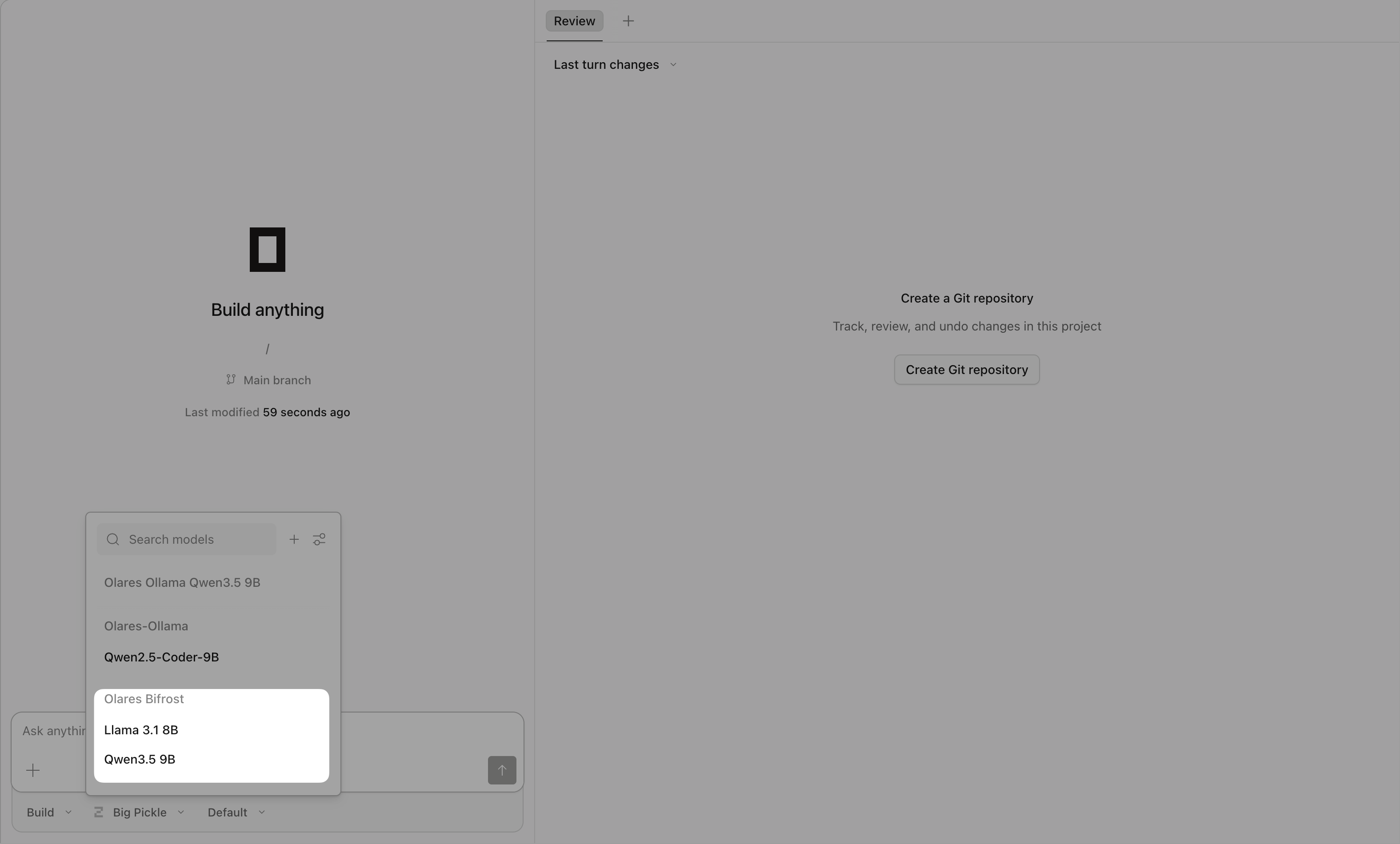

  1. Start a new session in OpenCode, and select one of the Bifrost-managed models to begin a chat.
    Chat in OpenCode

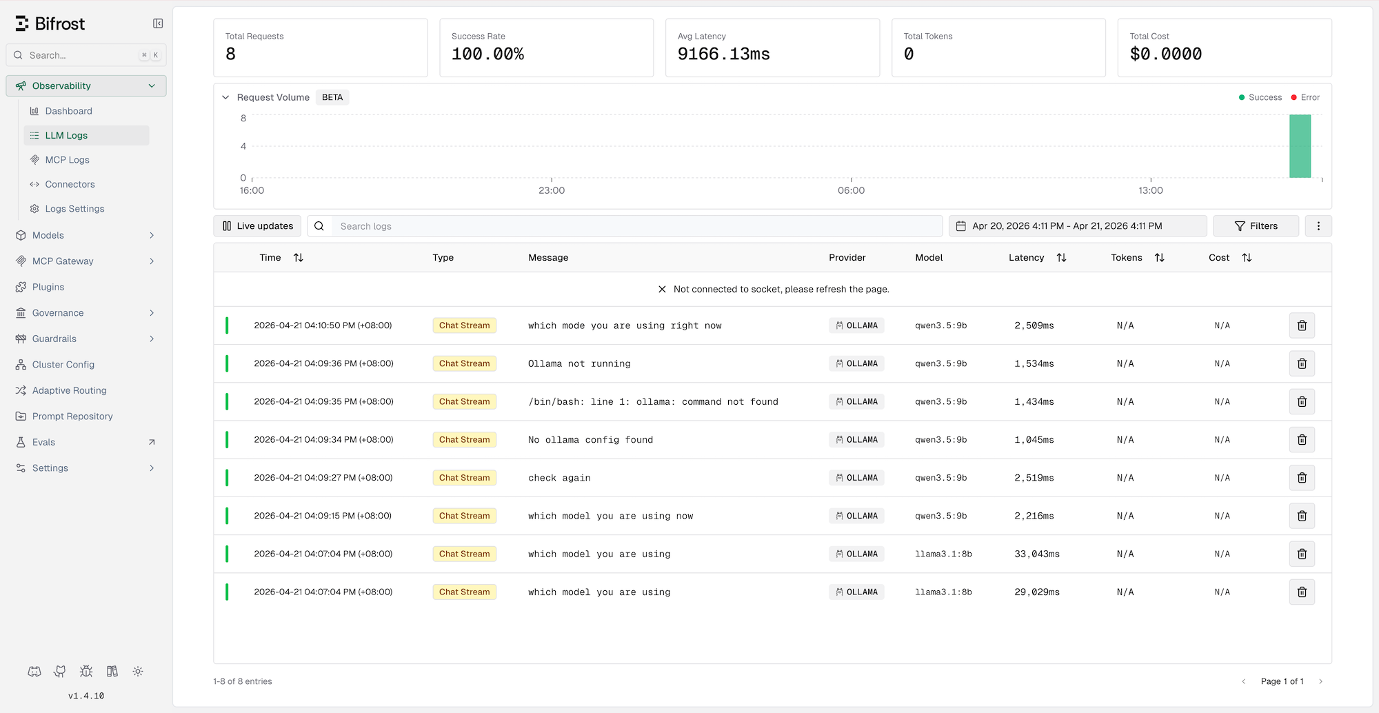

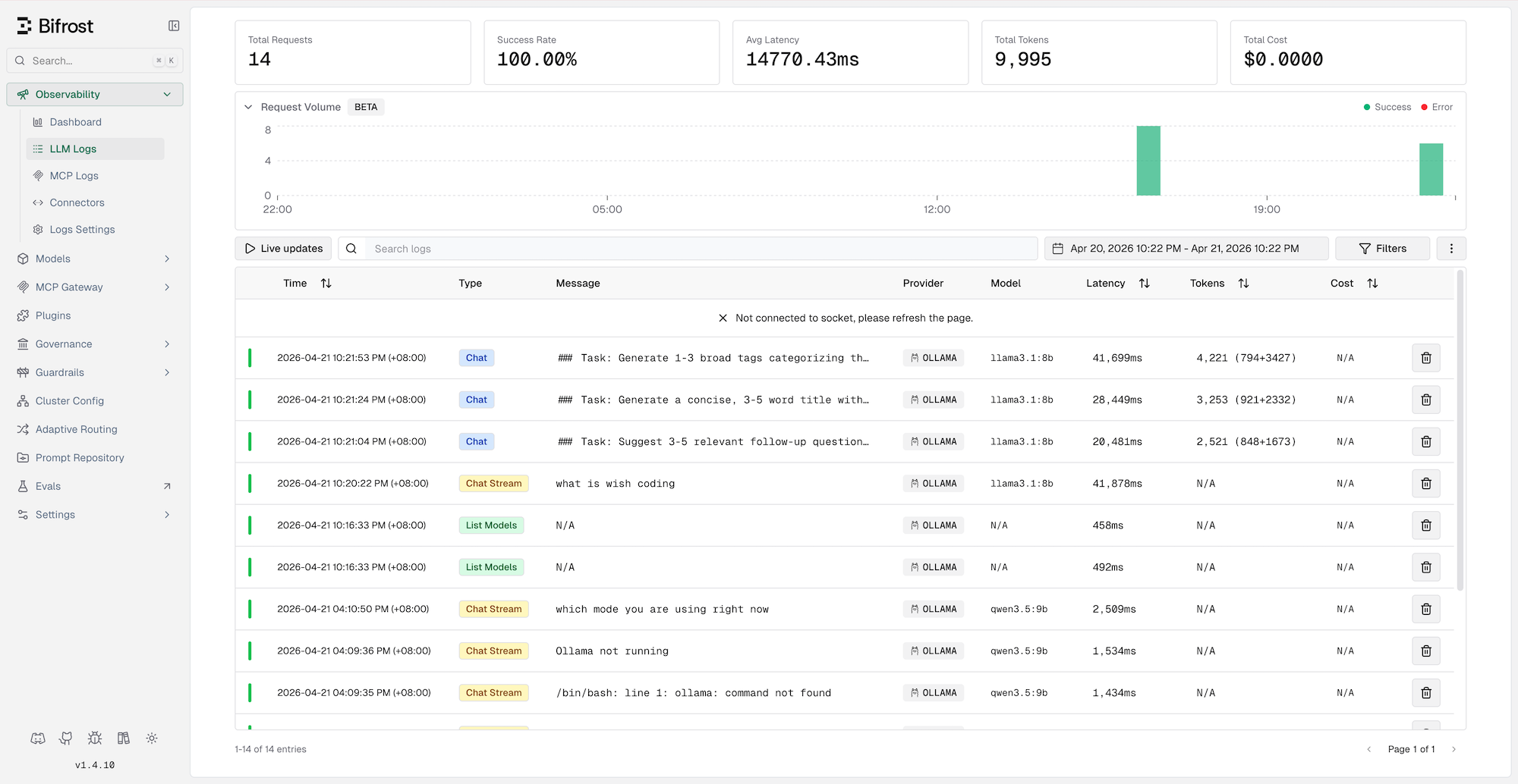

  2. Open Bifrost, and then go to Observability > LLM Logs.
    Each request you send appears as a log entry, which confirms that Bifrost routes the traffic successfully.
    Bifrost LLM logs

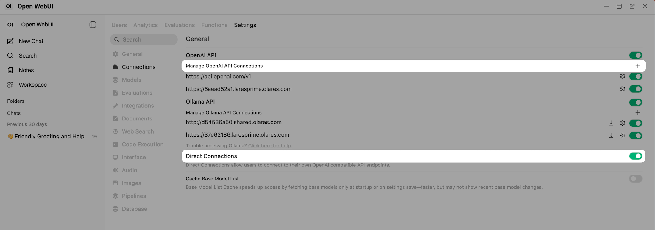

  1. In Open WebUI, click your user avatar, and then select Admin Panel.
  2. Click the Settings tab, and then select Connections.
  3. Enable Direct Connection, and then click add on the right of Manage OpenAI Connections.
    Direct connection toggle

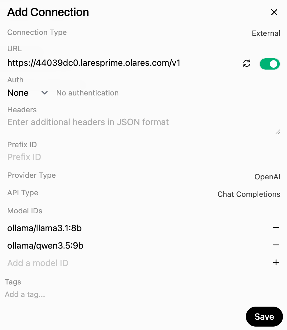

  4. In the Add Connection window, specify the following settings:
    • URL: Paste the Bifrost endpoint URL with /v1 appended.
    • Auth: Select None.
    • Add a Model ID: Enter each model ID in the ollama/<model-name> format, and then click add to add it. For example:
      • ollama/llama3.1:8b
      • ollama/qwen3.5:9b
    Open WebUI connection form
  5. Click refresh to verify the connection, and then click Save.

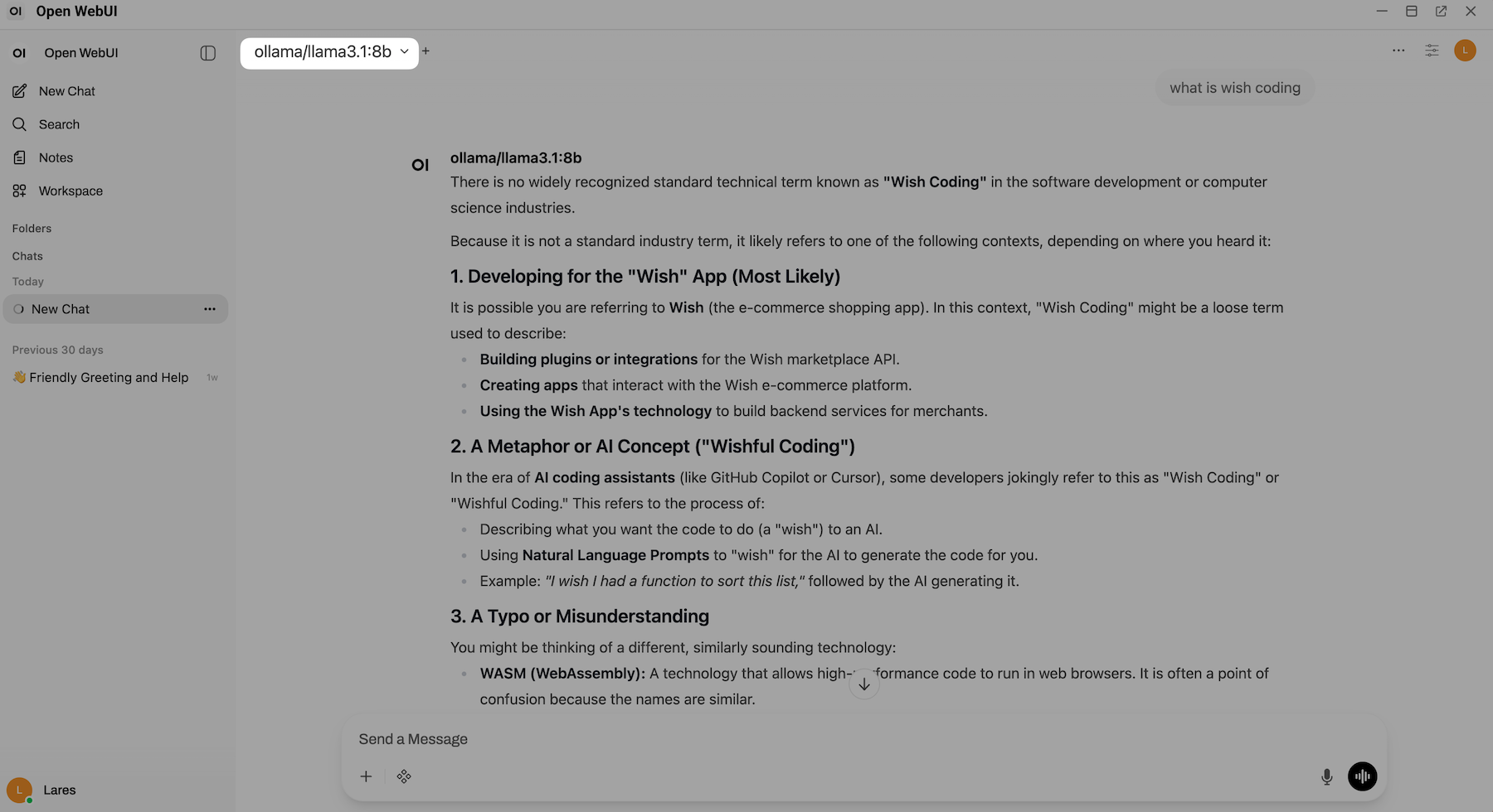

  1. In Open WebUI, go to the New Chat page.
  2. Select one of the configured models, and then start a conversation.
    Open WebUI chat
  3. Open Bifrost, and then go to Observability > LLM Logs.
    Bifrost log for Open WebUI
