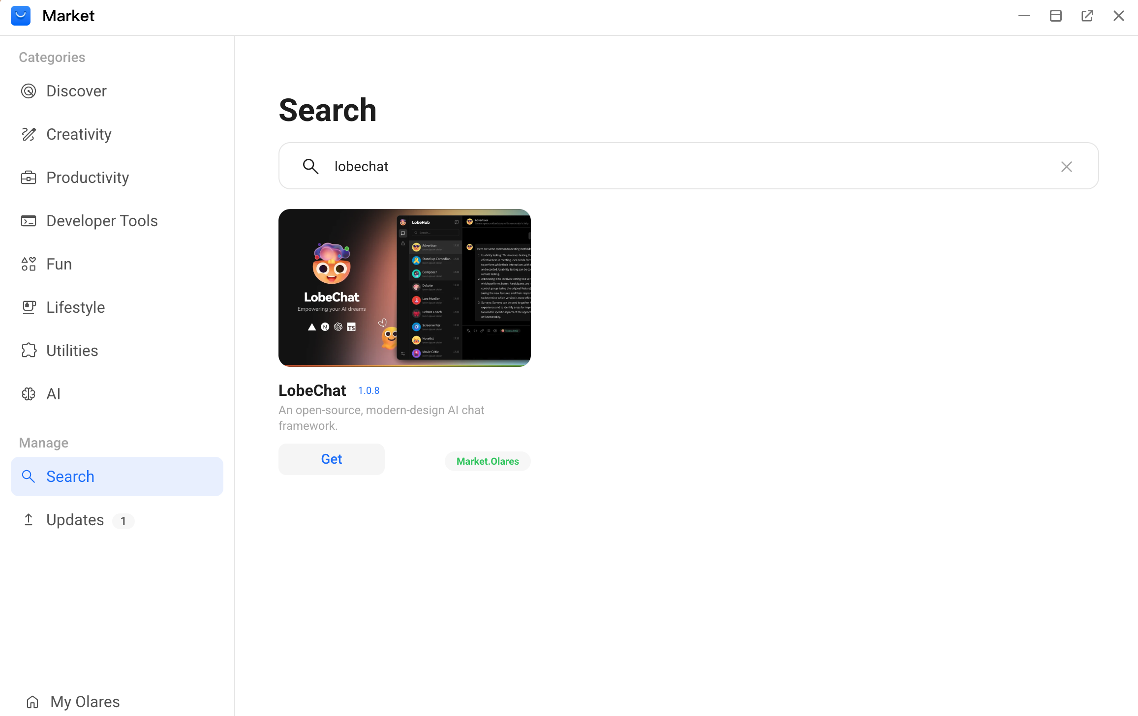

  1. From the Olares Market, search for "LobeChat".
    Search for LobeChat from Market

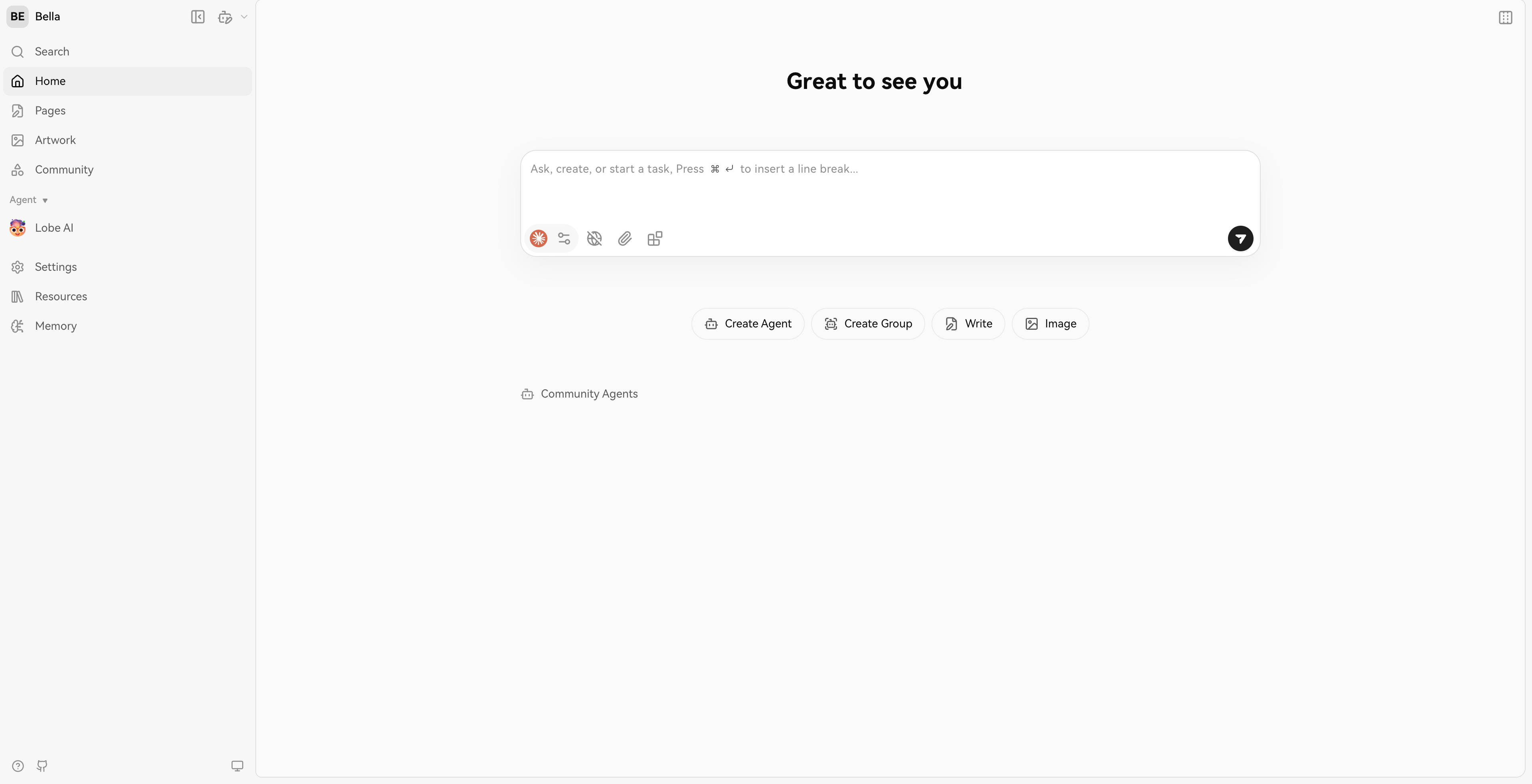

  2. Enter your email address, and then follow the prompts on the page to create a LobeHub account and sign in.
    LobeHub home page

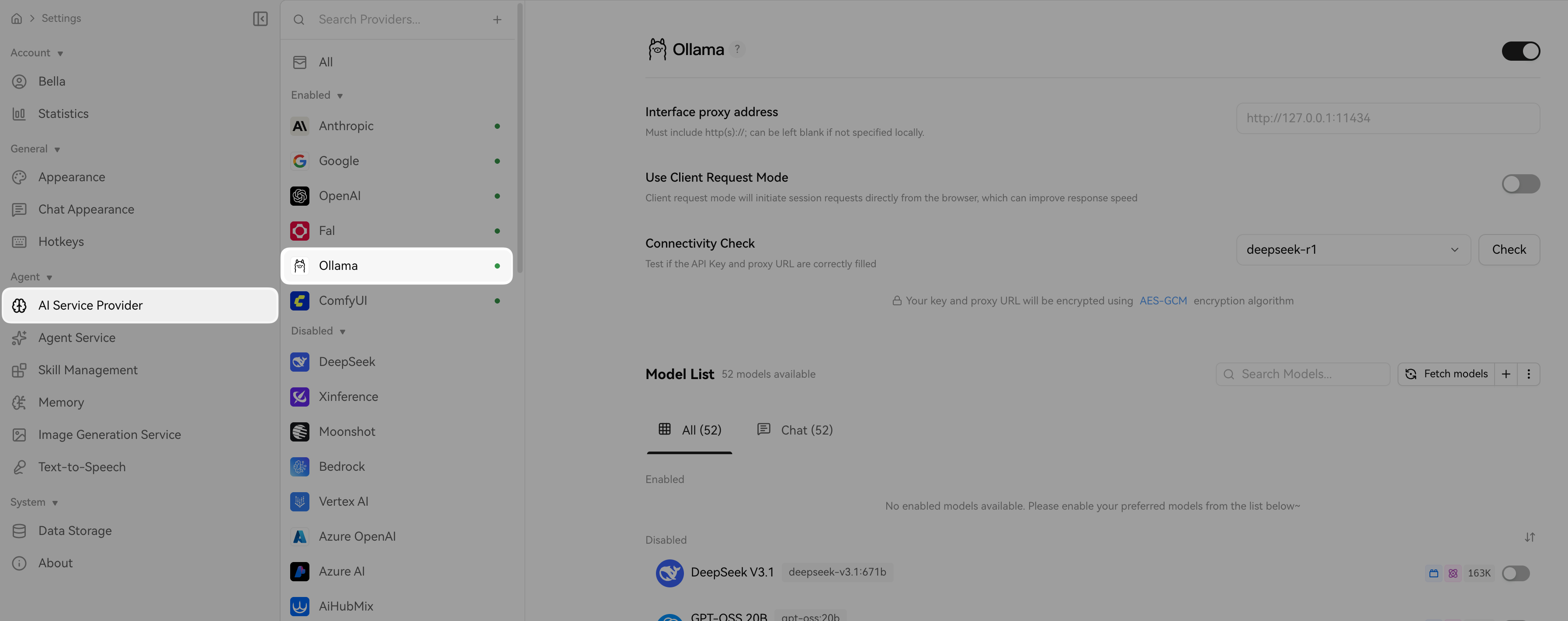

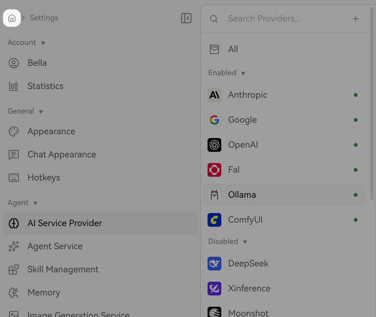

  1. From the left sidebar, go to Settings > AI Service Provider > Ollama.
    Configure Ollama in LobeHub

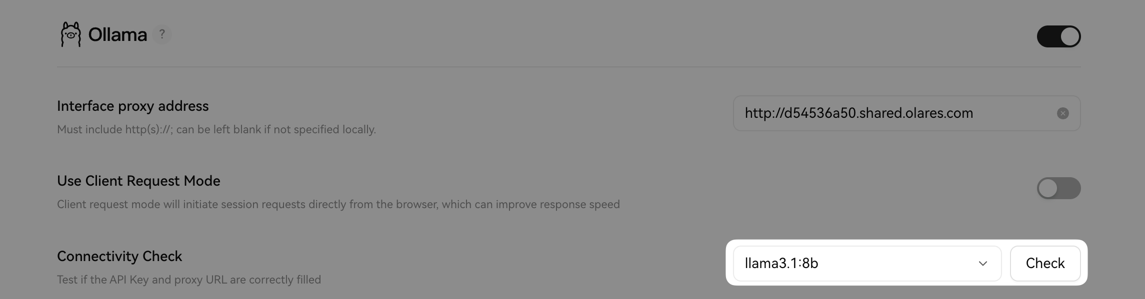

    c. Return to LobeHub, and then enter the endpoint address in the Interface proxy address field.

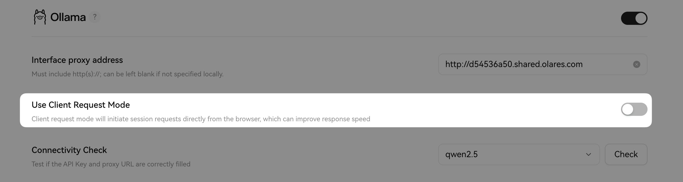

  3. Disable the Use Client Request Mode option.
    Do not enable the Use Client Request Mode option when running local models. This mode is designed for remote API calls and might cause connection errors.

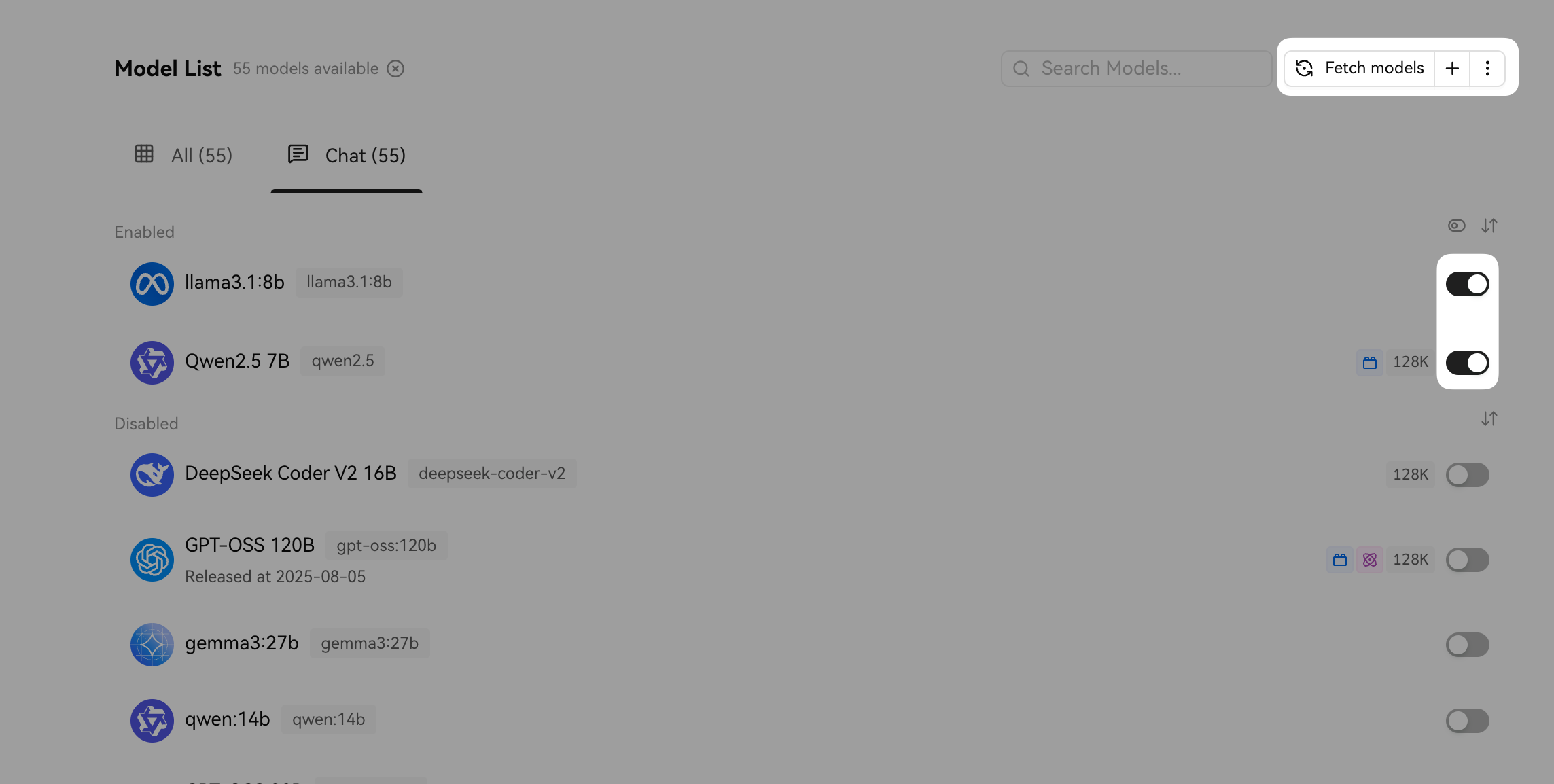

  4. In the Model List section, click Fetch models to pull the list of supported models, and then click toggle_off to enable the models you want to use.
    Fetch model list and enable models

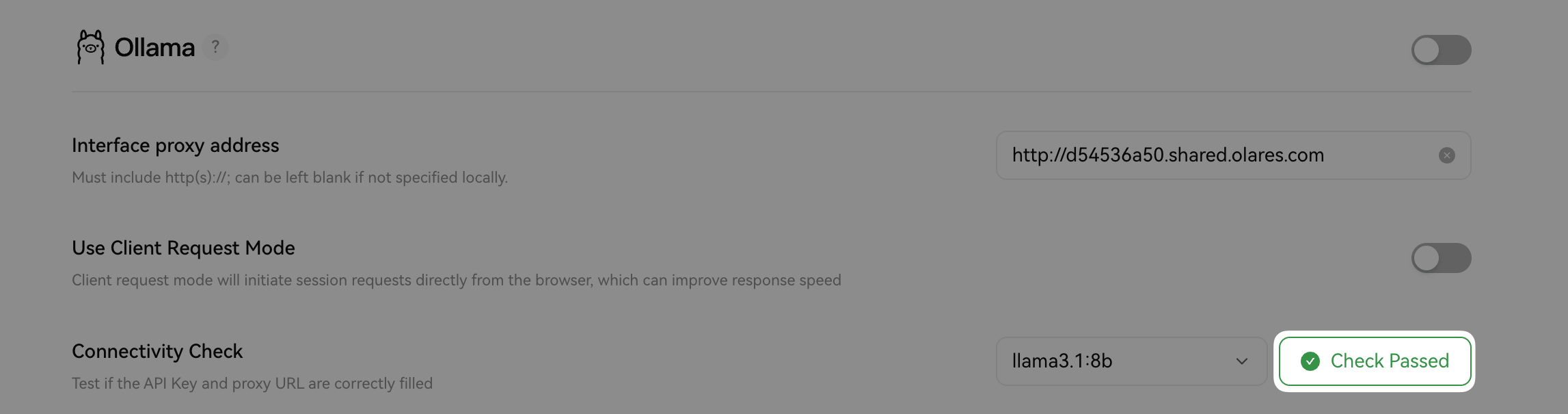

  5. In the Connectivity Check section, select the model you just enabled from the list, and then click Check to verify the connection. If the model is large, it might take a little longer to load.
    Connectivity check
    The button changes to Check Passed, indicating that the proxy address is correct.
    Connectivity check success
  6. Click the home icon at the upper-left corner to return to the LobeHub home page.
    Return to home page

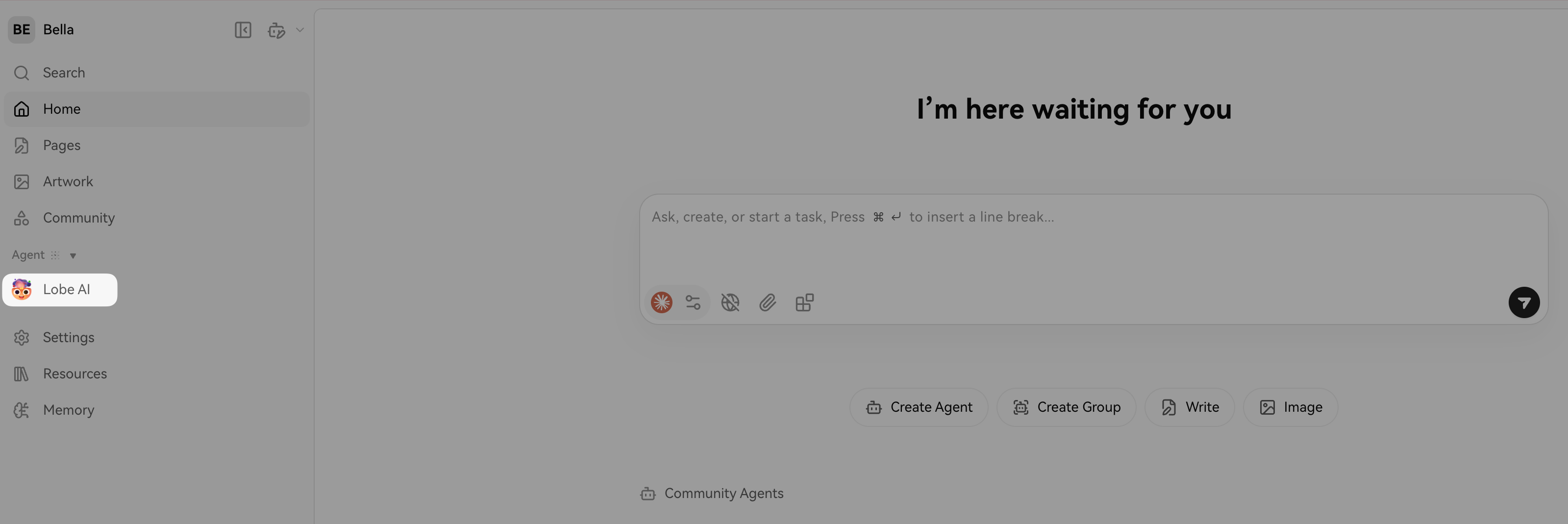

  1. From the left sidebar, click Lobe AI.
    Click Lobe AI

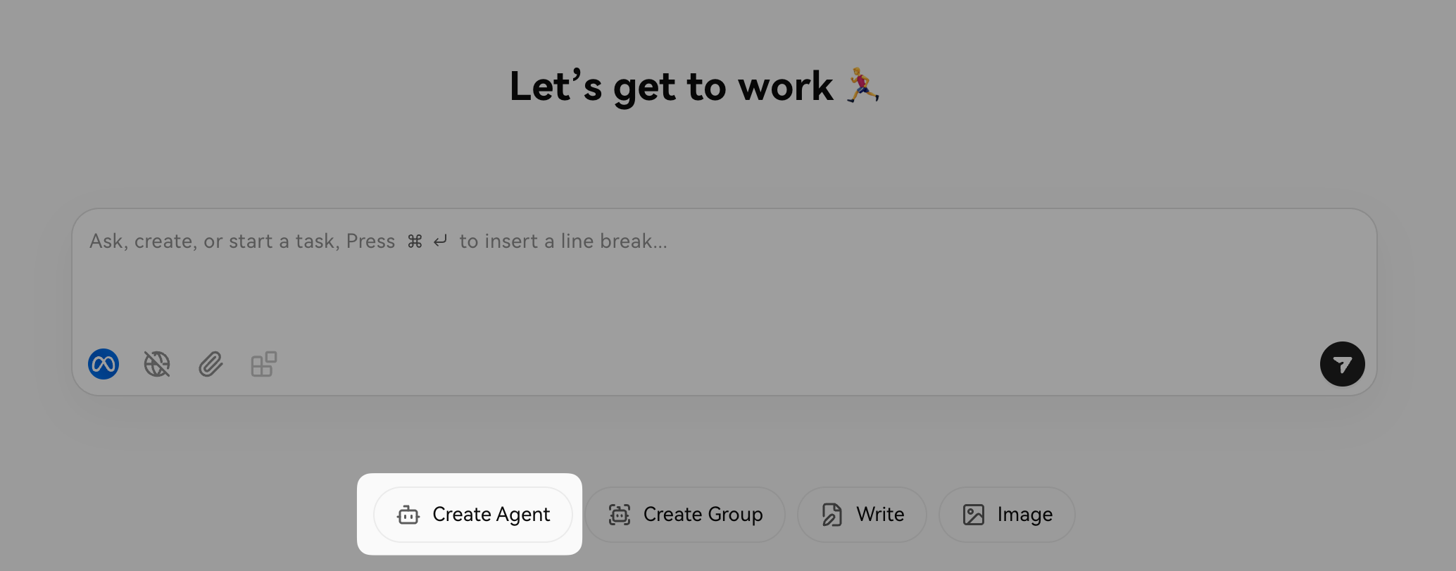

  1. On the home page, click Create Agent under the chat box.
    Create Agent button

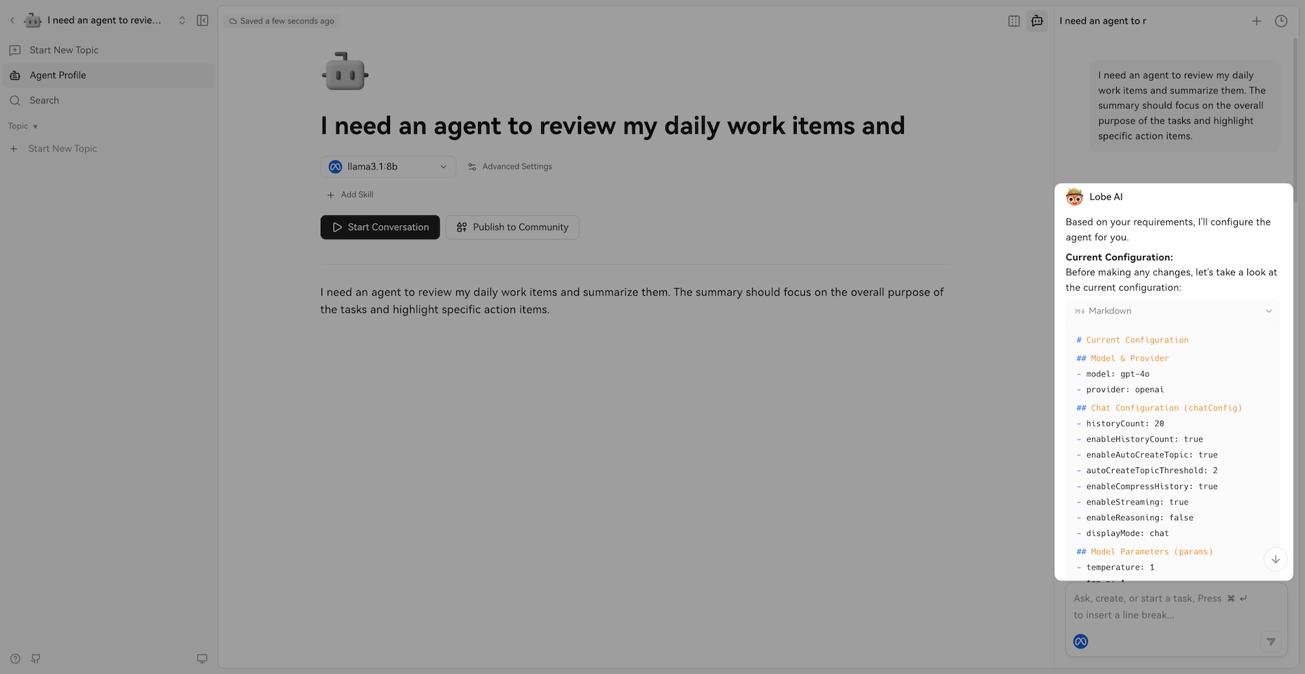

  4. Press Enter. The profile page of the new agent opens, and you can see the Agent Builder starts configuring your agent automatically.
    Agent builder
  5. Use the chat interface on the lower right to interact with the Agent Builder. As you provide more details or refine your requirements, the Agent Builder automatically drafts and updates accordingly.

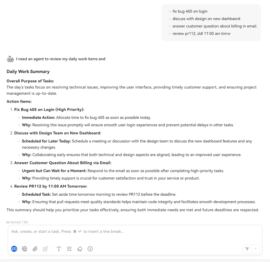

  7. Provide your text in the chat, and then you can get the refined results. For example,
    - fix bug 405 on login
    - discuss with design on new dashboard
    - answer customer question about billing in email.
    - review pr112, ddl 11:00 am tmrw
    You get the output:
    Sample output by agent builder

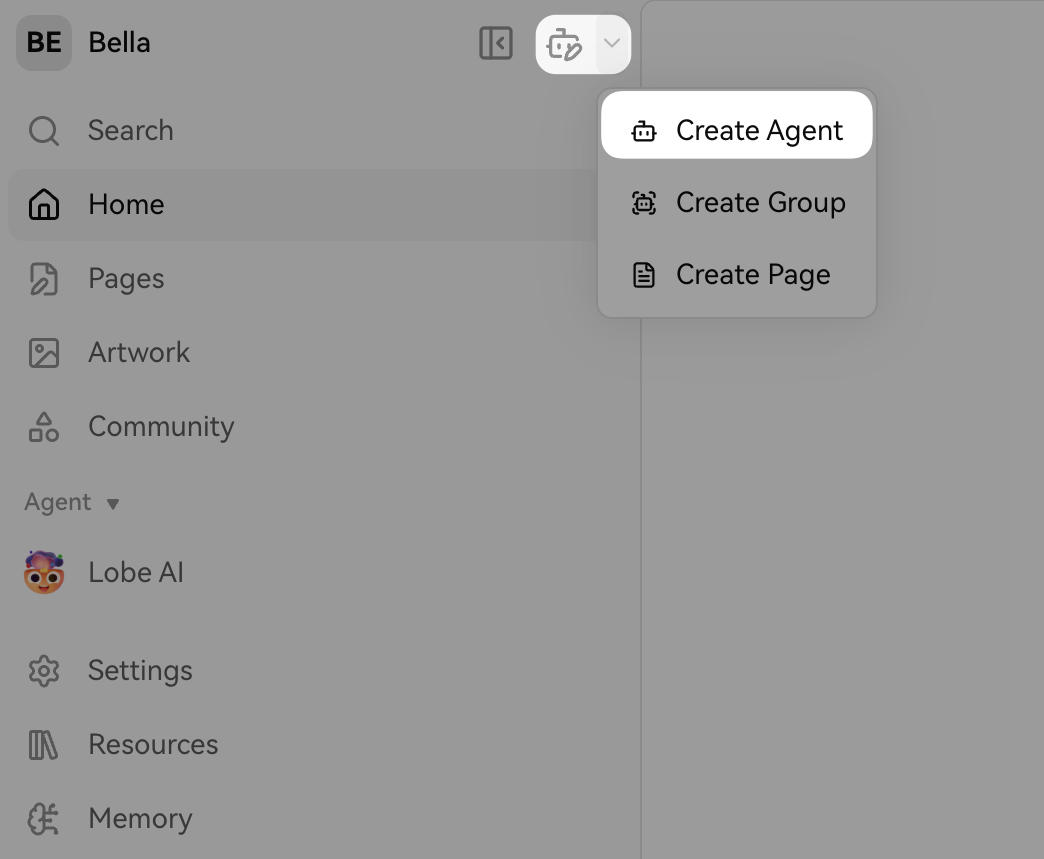

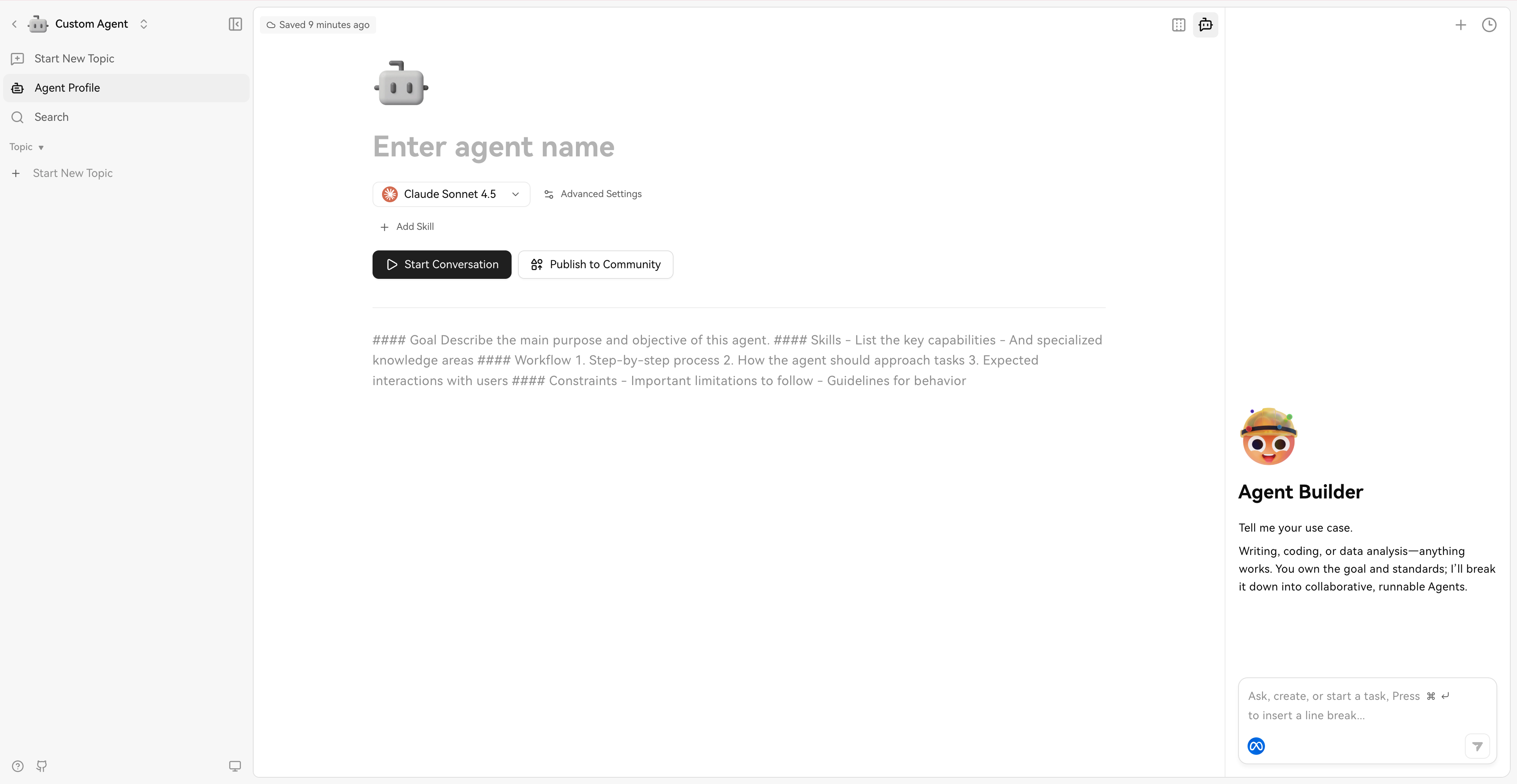

  1. On the home page, click the robot icon in the upper left corner, and then select Create Agent.
    Create custom agent
    The Agent Profile page opens.
    Custom agent profile
  2. Click the default robot avatar to select a new icon for your agent.
  3. Enter the agent name. For example, SEO Copywriter.
  4. Select the language model. For example, qwen 2.5.
  5. Click + Add Skill to equip the agent with additional tools. For example, select Web Browsing for gathering SEO data.

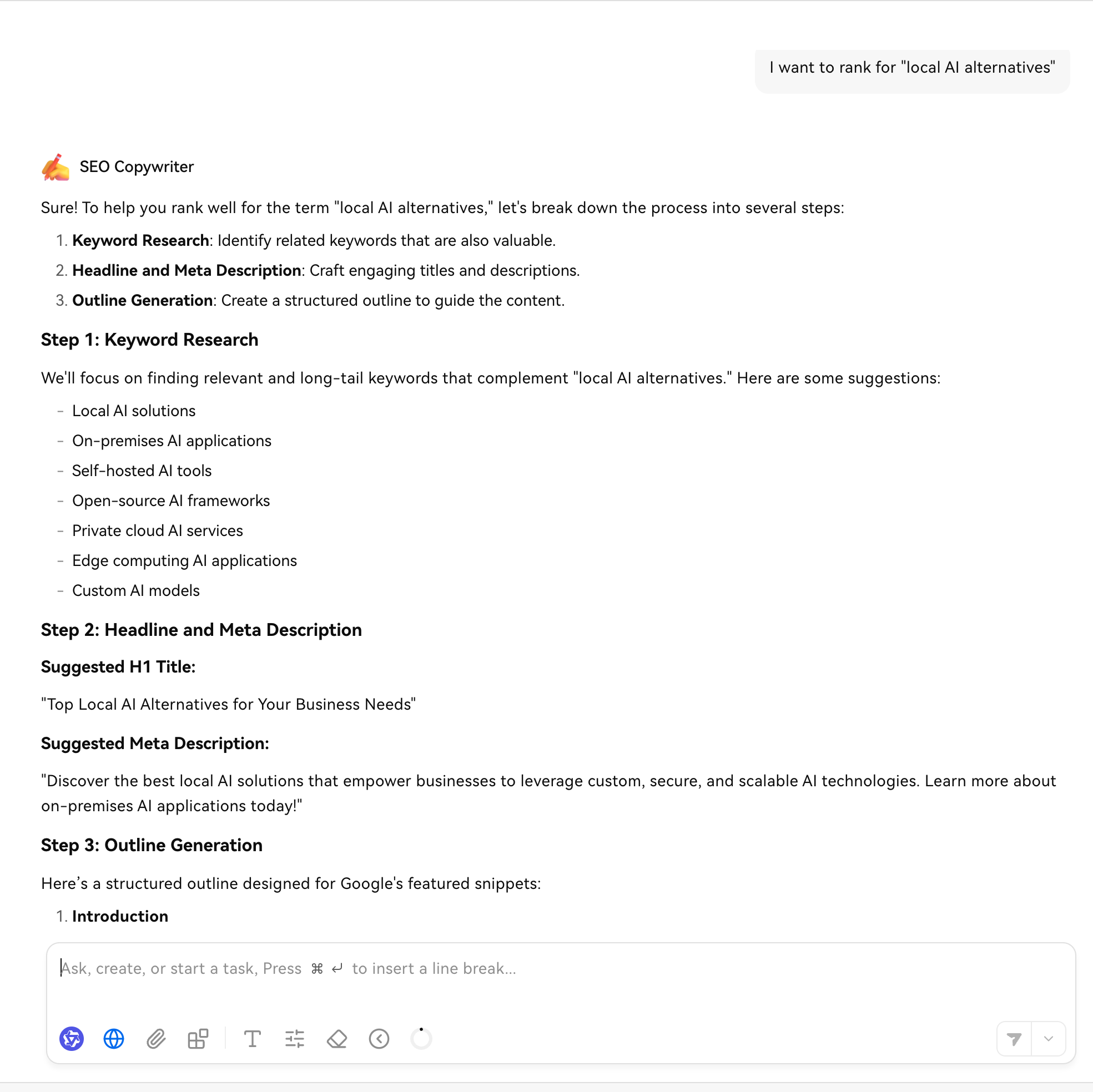

  7. Click Start Conversation to use it. For example, type the following request:
    I want to rank for "local AI alternatives"
  8. Review the proposal and output, and then iterate with it until you are satisfied with the results.
    Custom agent result sample

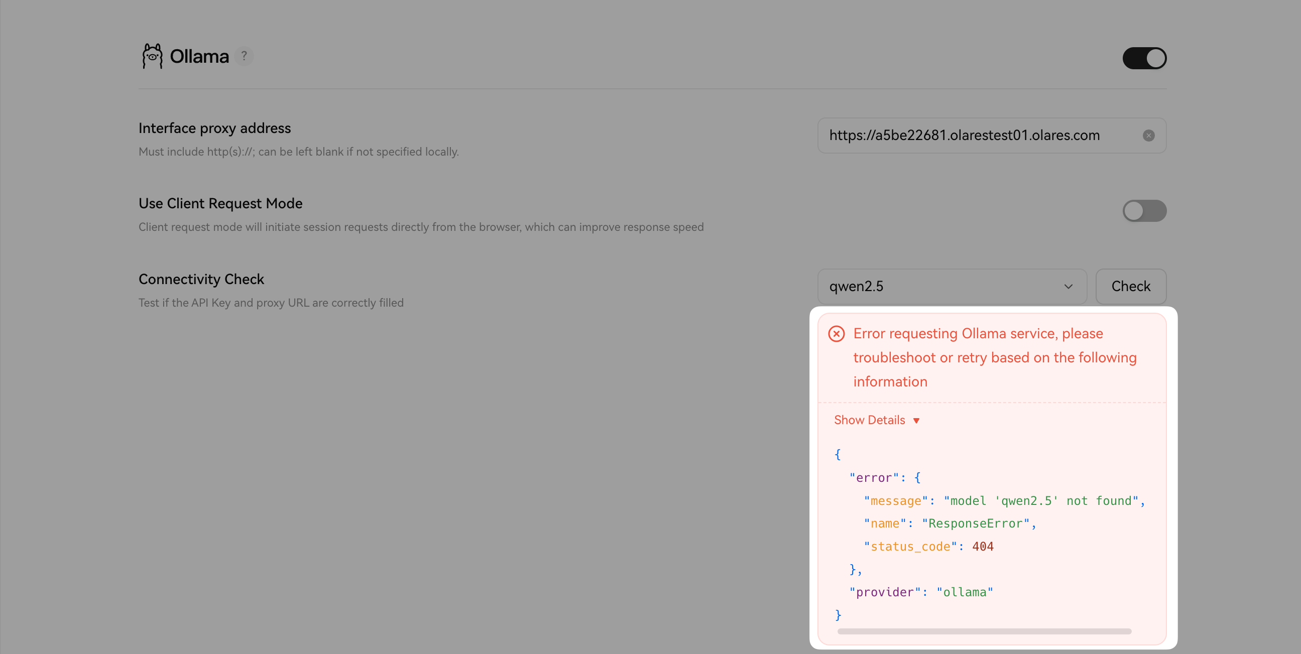

Why did the connection check fail when I connected to Ollama? ​
If you encounter the Error requesting Ollama service error, troubleshoot as follows and retry:
Connectivity error
  1. Ensure the specific model you are using is downloaded using Ollama.
  2. Ensure the Use Client Request Mode option on the Ollama settings page is disabled.
    Disable the use client request mode option
