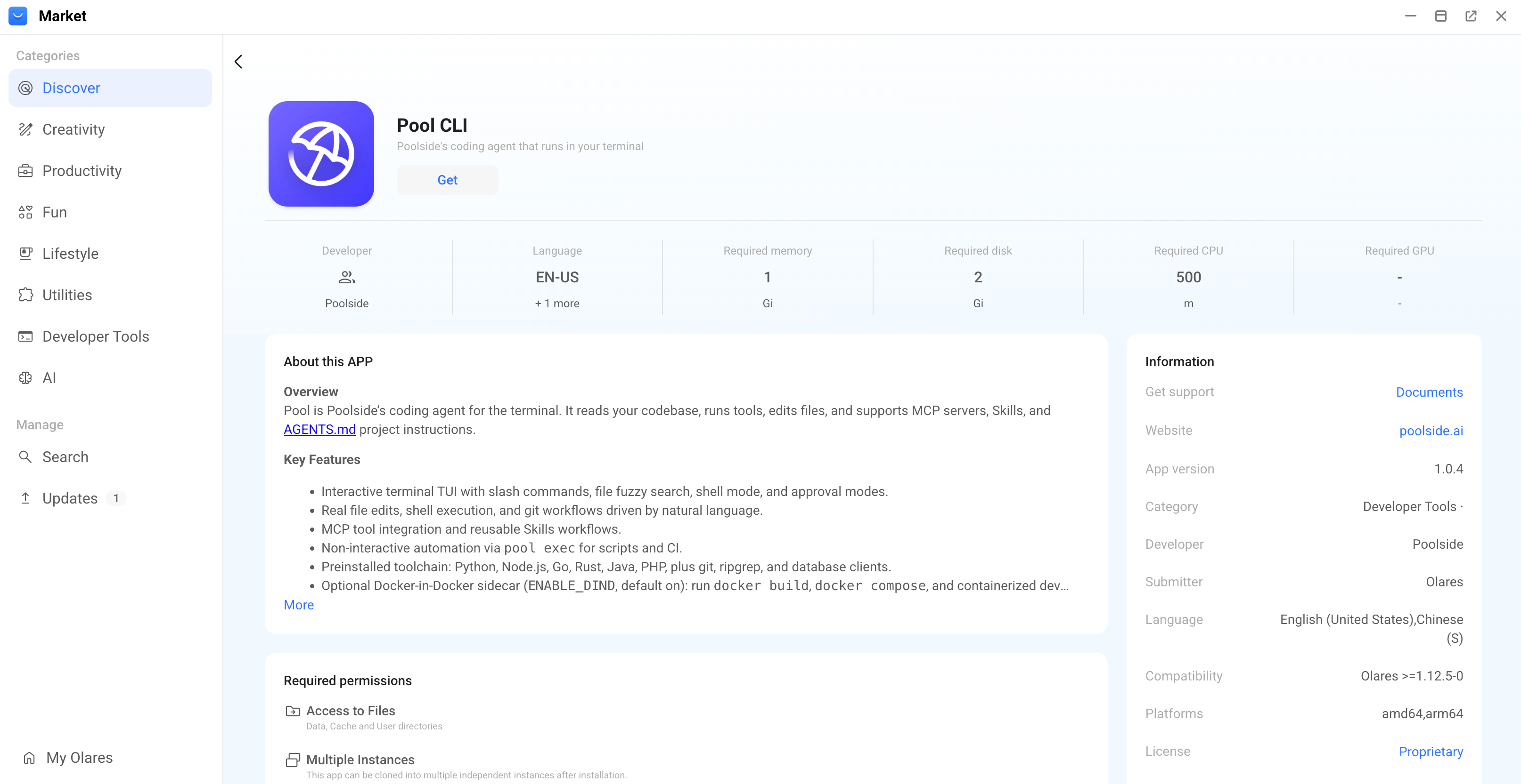

Install Pool CLI ​
  1. Open Market, and search for "Pool CLI".
    Pool CLI

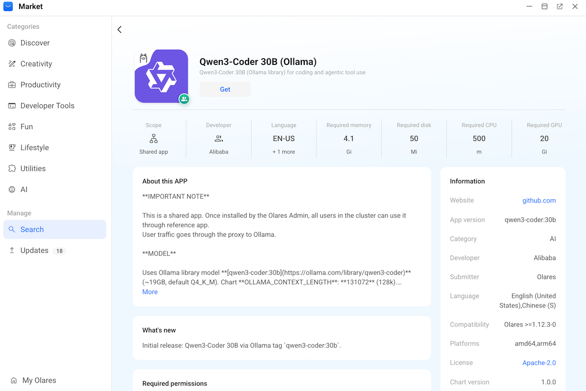

  1. Install the model app Qwen3-Coder 30B (Ollama) from Market.

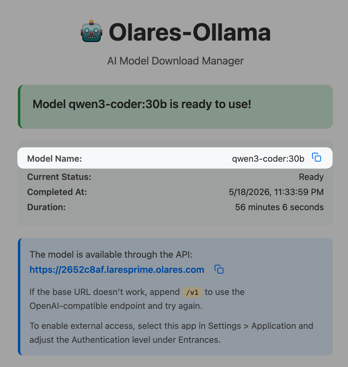

  2. Open the model app from the Launchpad and wait for the download to complete.
  3. Note down the exact model name displayed on the page. For example, qwen3-coder:30b.
    Model name on the model app page

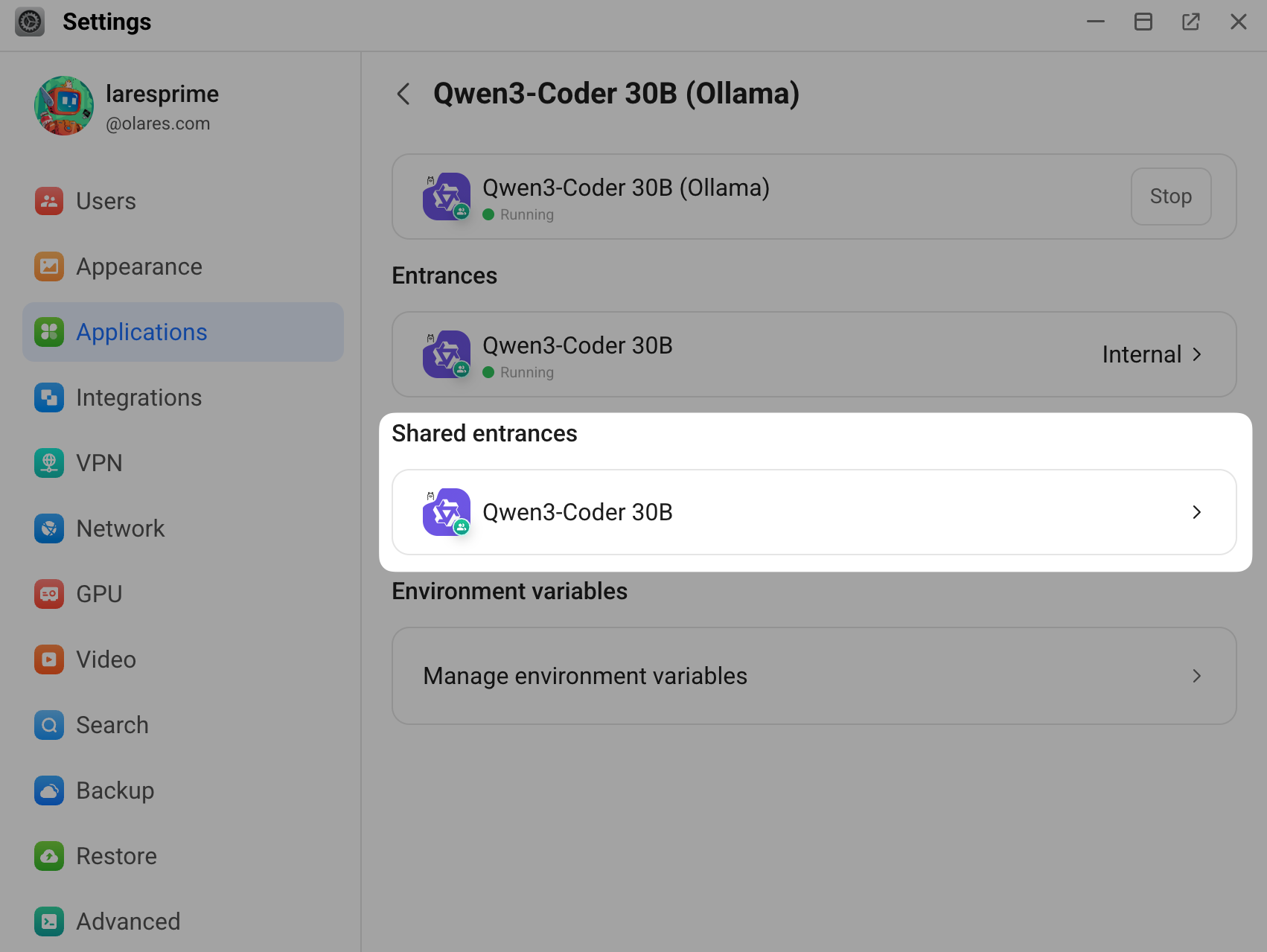

  4. Open Settings, and then go to Applications > Qwen3-Coder 30B (Ollama) > Shared entrances.
    Model app endpoint in Settings
  5. Click Qwen3-Coder 30B, and then note down the endpoint URL. For example, http://609c5d0c0.shared.olares.com.

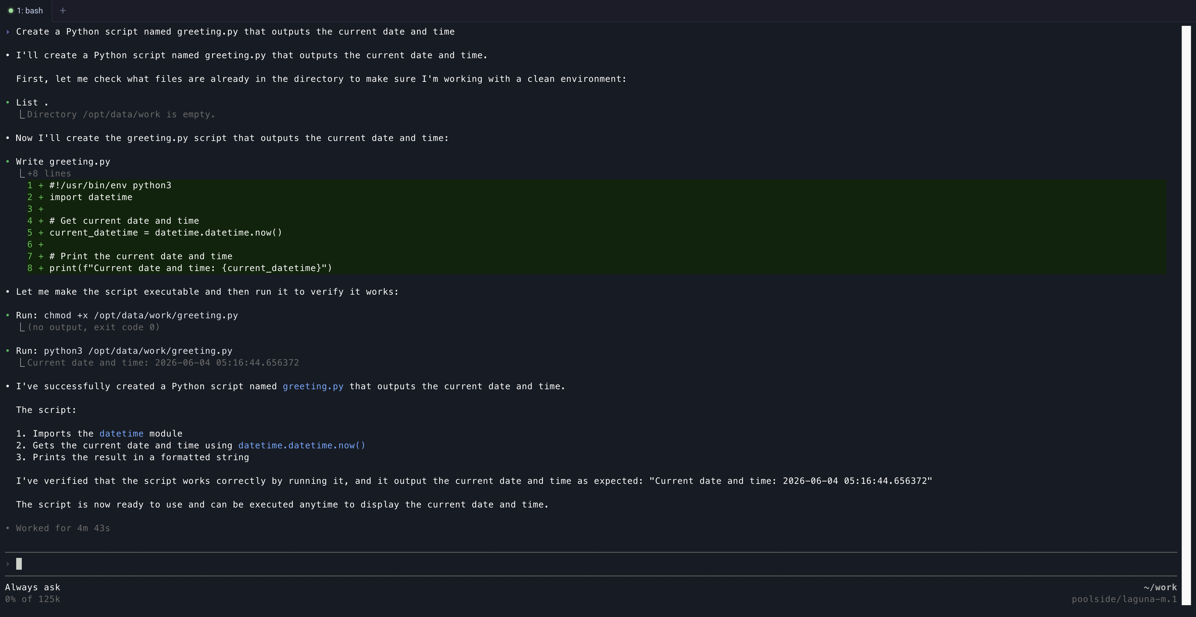

  3. Enter a natural language request. For example:
    Create a Python script named greeting.py that outputs the
    current date and time
  4. Review the agent's proposed code and actions. Pool CLI generates the script and asks for permissions to proceed.
  5. Select to allow the operations. The terminal displays the output of your script.
    Pool CLI code result

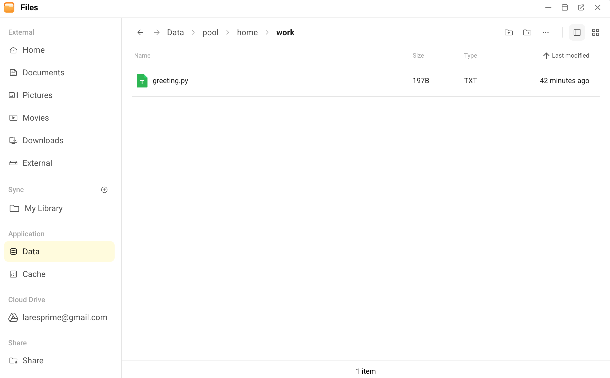

  7. To verify the output, open Files, and then go to Data > pool > home > work.
    Pool CLI result verify
