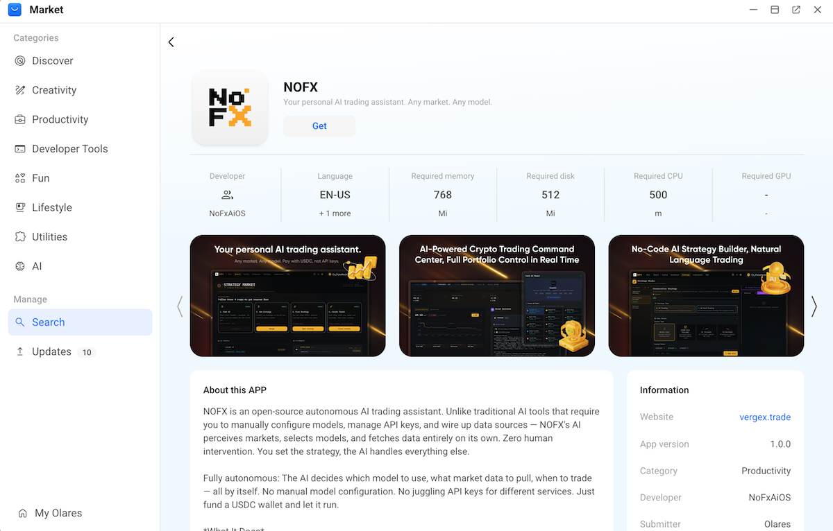

Install NOFX ​
  1. Open Market and search for "NOFX".

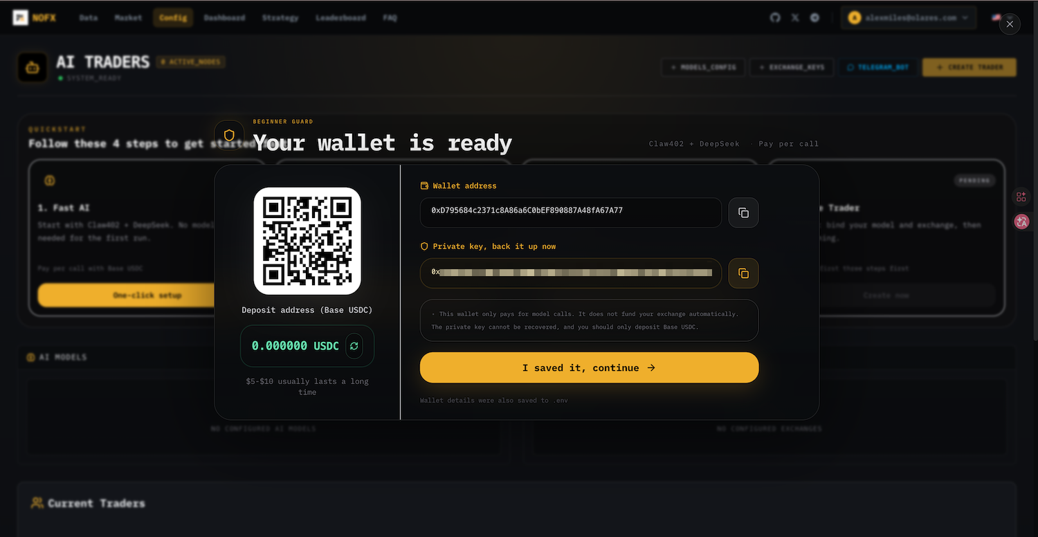

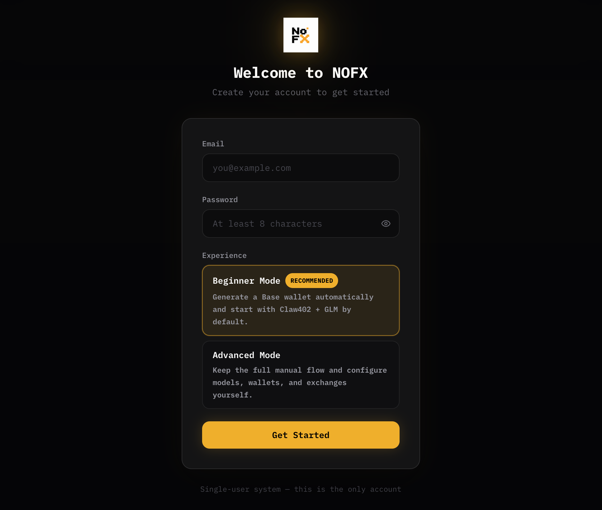

  1. Open NOFX from the Launchpad. On first launch, register with your email and password.
    NOFX sign-up screen
  2. After you sign up, NOFX generates a wallet address and the corresponding private key. Store the private key in a secure location and never share it with anyone.
    NOFX wallet generated
  3. Click I saved it, continue.

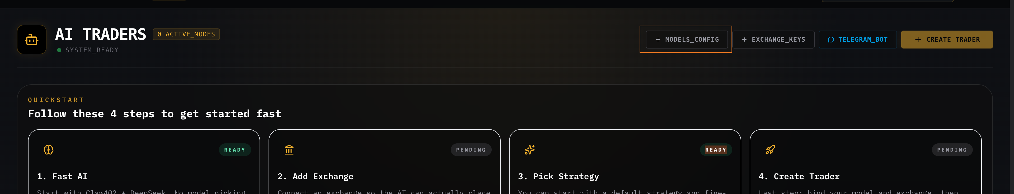

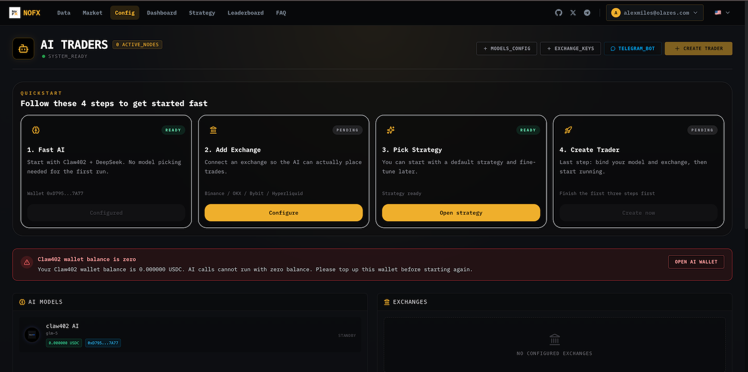

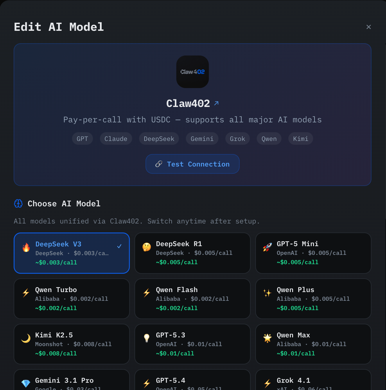

  4. On the Config page, click OPEN AI WALLET.
    Open AI Wallet

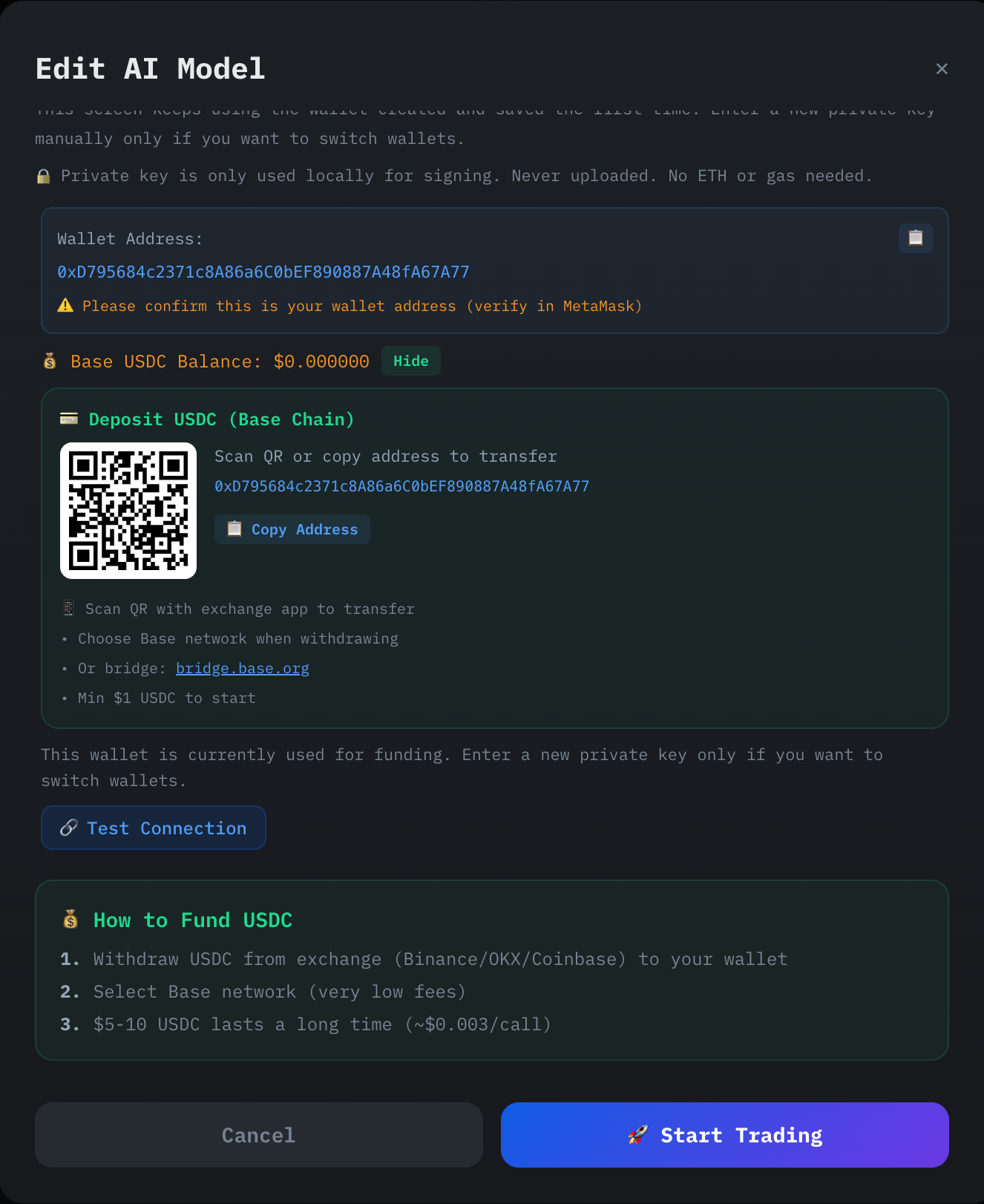

  5. In the Edit AI Model window, scroll down to the Deposit USDC (Base Chain) section, and then deposit USDC into the wallet. Start with about 10 USDC to test the flow before depositing the amount you plan to use for live strategies.
    Use USDC on the Base chain
    Only USDC on the Base chain is recognized. If your USDC is on another chain, use the wallet's swap feature to bridge it to Base first.
    Deposit screen

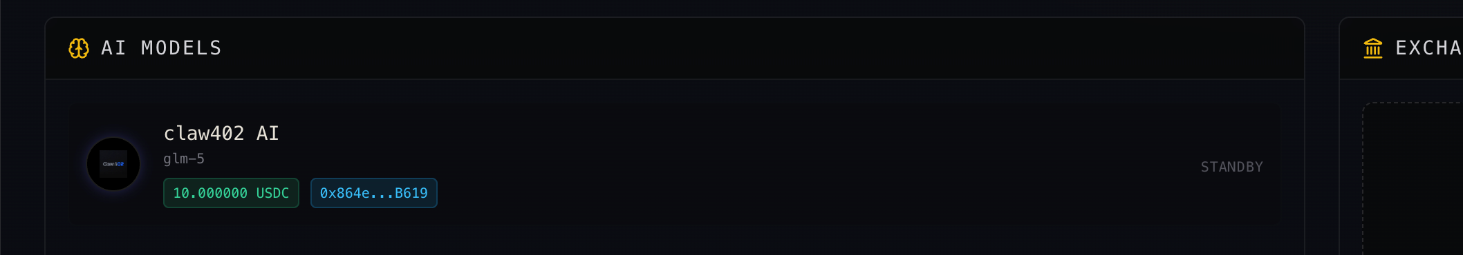

  6. After the deposit transaction completes, refresh the page to update the balance. If the balance does not update, click Test Connection to check the connectivity.
    Once funded, your balance appears in the AI MODELS section.
    AI Models with wallet
  7. Click OPEN AI WALLET again, select an AI model to use, scroll down to the bottom of the window, and then click Start Trading.
    Select model

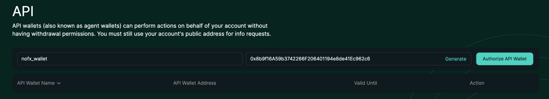

  1. Open the Hyperliquid web interface at https://app.hyperliquid.xyz, and then log in to your account.
  2. On the top menu bar, go to More > API.
  3. Create a new API wallet.
    Hyperliquid API page
  4. Authorize the API wallet by signing the prompt with your main Hyperliquid wallet.
  5. Copy the API wallet address and private key, and store them in a secure location. You need these credentials for the next step.

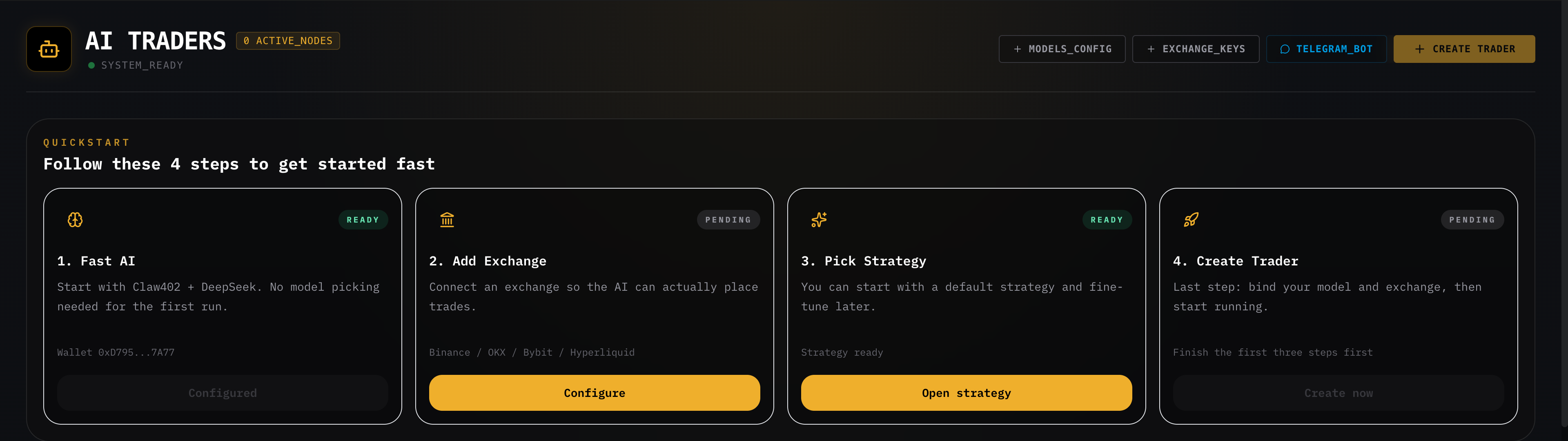

  1. In NOFX, go to the Config page.

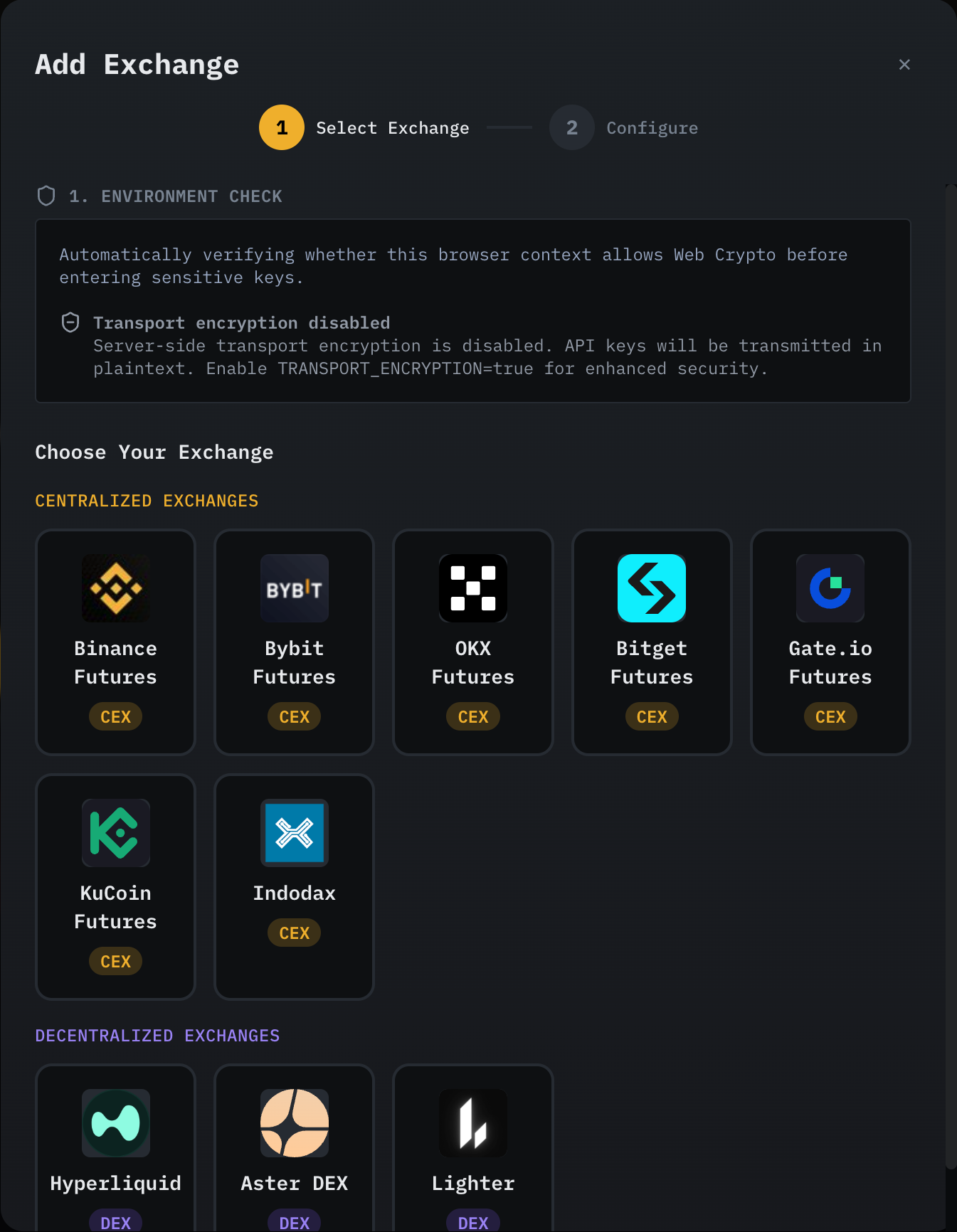

  2. On the Add Exchange card, click Configure.
  3. On the Select Exchange screen, choose Hyperliquid.
    Select Hyperliquid

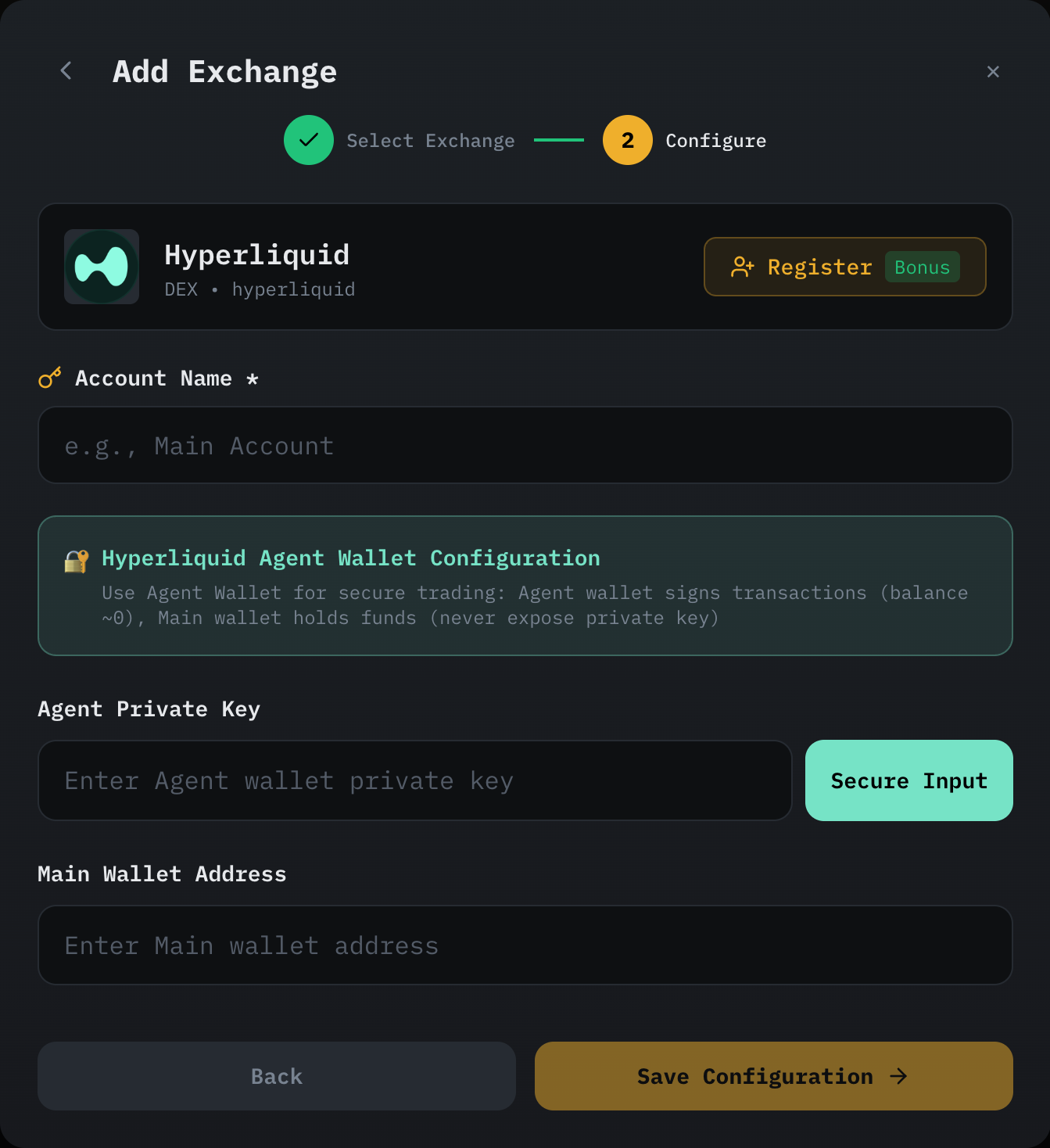

  4. On the Configure screen, fill in the following fields:
    • Account Name: Enter a memorable name for this exchange account, such as Main Account.
    • Agent Private Key: Enter the private key of the API wallet you created on Hyperliquid.
    • Main Wallet Address: Enter the address of your main Hyperliquid trading account that holds the funds. The Agent wallet signs transactions, while the main wallet keeps the balance and remains unexposed.
    Configure Hyperliquid

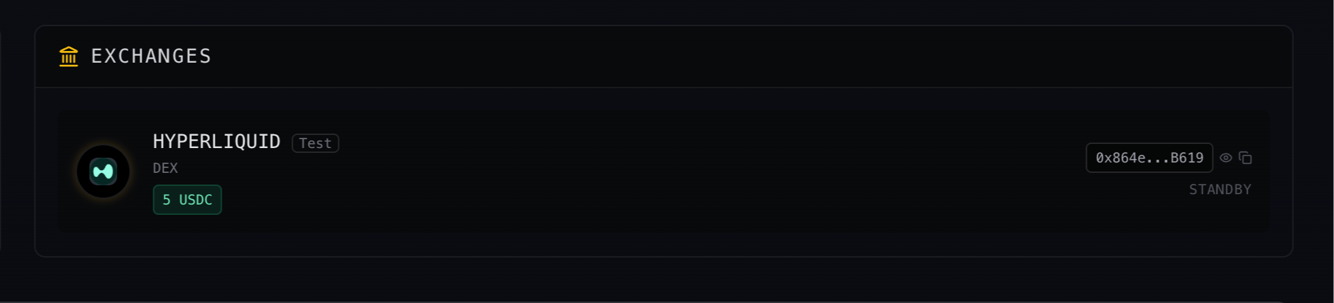

  5. Click Save Configuration. Once finished, Hyperliquid appears in the EXCHANGES section.
    Hyperliquid configured

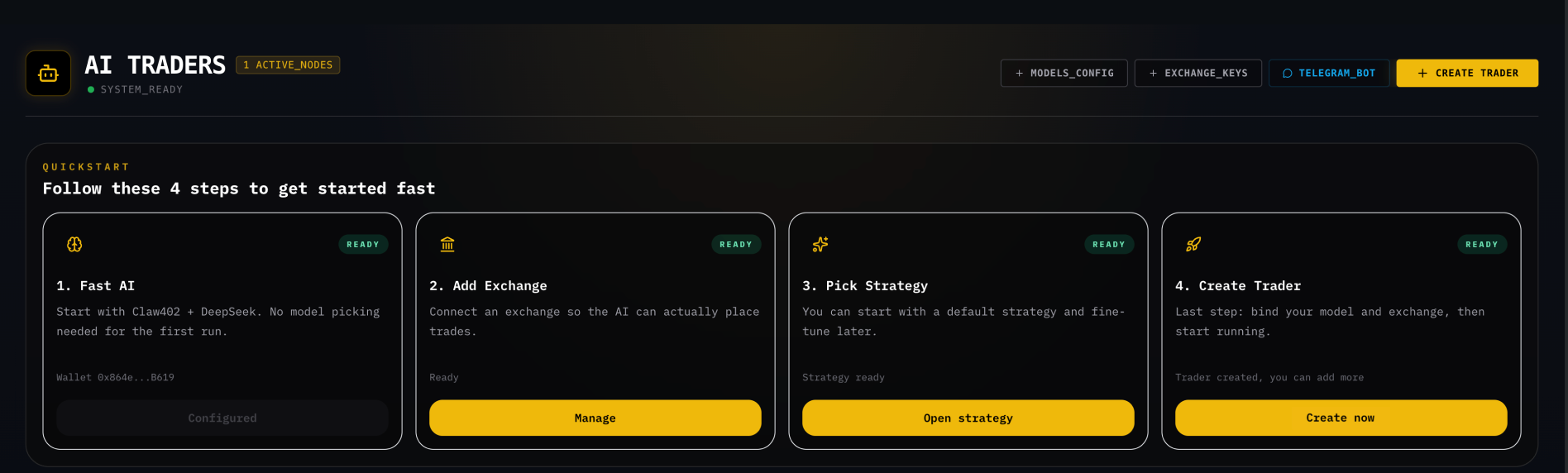

  1. On the Pick Strategy card, click Open strategy to open the strategy editor.
    Open strategy

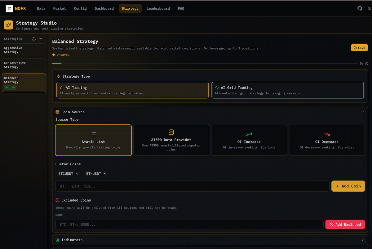

  2. Select a default strategy from the left panel, select Static List as the coin source, and add BTC and ETH as the trading pairs.
    Strategy config

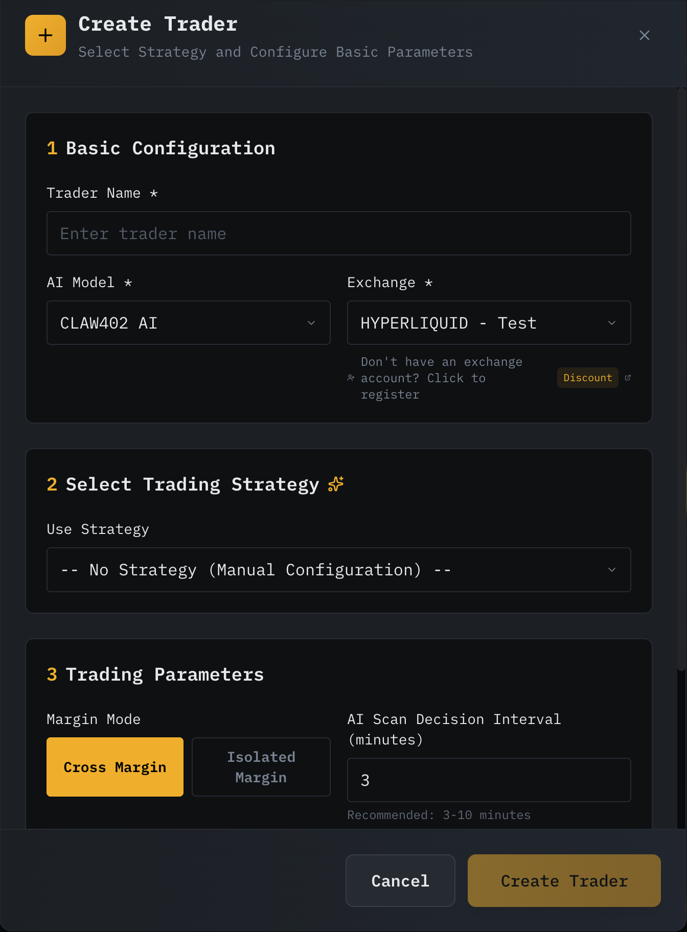

A Trader represents your automated trading bot. Creating a Trader combines your chosen AI model, exchange connection, and trading strategy into a single runnable trading bot.
  1. On the Create Trader card, click Create now.
    Create trader
  2. Enter the trader name, and select the AI model and exchange you configured earlier.
    Select trader components
  3. Select the trading strategy you configured earlier.
  4. Specify the trading parameters.
  5. Click Create Trader.

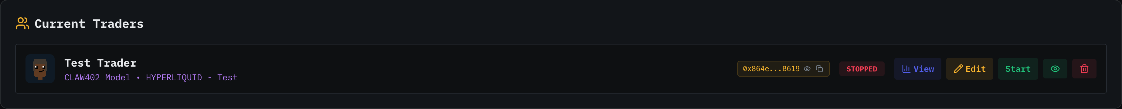

  1. In the Current Traders section, find the new Trader you just created.
    Trader created
  2. Start the Trader by clicking Start.

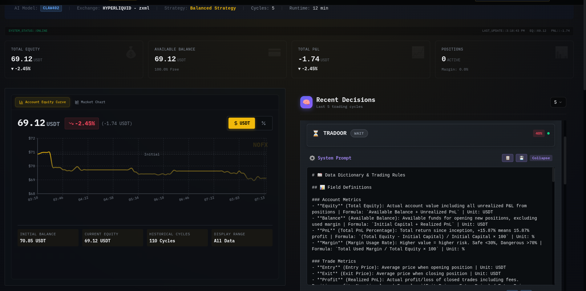

  3. Go to the Dashboard page to watch the strategy run in real time.
    Dashboard
  4. To stop the Trader, return to the Config page, and then click Stop in the same section.

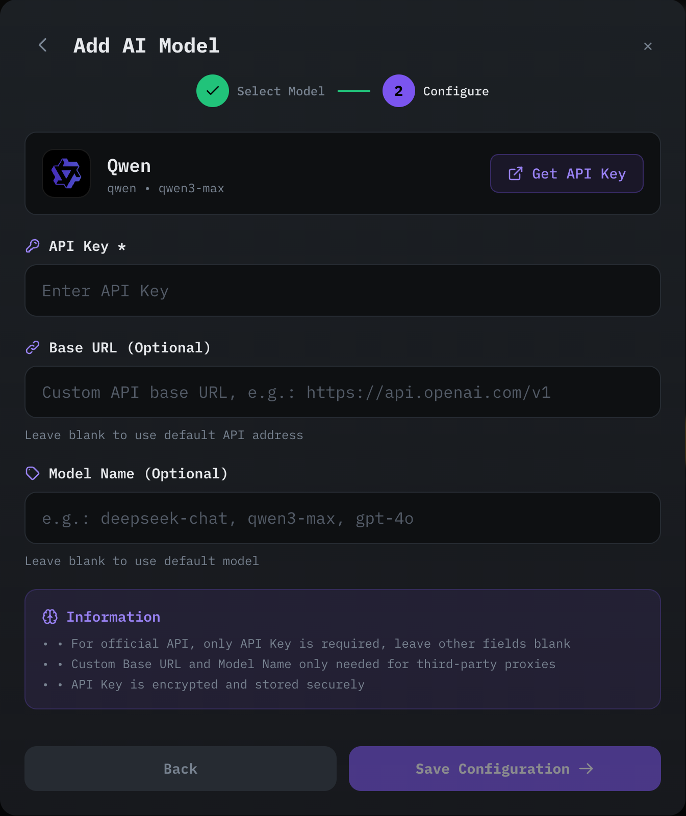

How to switch models? ​
If you configure your own API key, NOFX routes the requests directly through your provider. This means NOFX will not deduct model call fees from your internal AI wallet.
  1. On the Config page, click + MODELS_CONFIG.
    Switch models
  2. Click Other API Providers, and then select another provider. For example, Qwen.
  3. Enter the API key. The base URL and model name are optional.
    Configure models
  4. Click Save Configuration. API keys are encrypted before storage. After saving, test the connection to verify it works.
