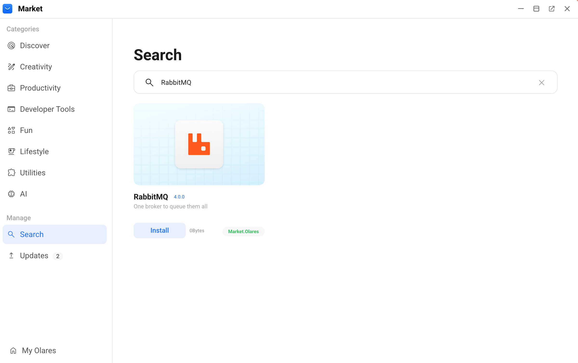

Before you can install Plane, you must first install RabbitMQ (V4.0.0 or later) and MinIO (V1.0.0 or later)
Plane relies on multiple middleware components to run smoothly. While PostgreSQL and Redis are already pre-installed on your Olares system, RabbitMQ and MinIO require manual installation.
  1. Open Market and search for "RabbitMQ".
    RabbitMQ

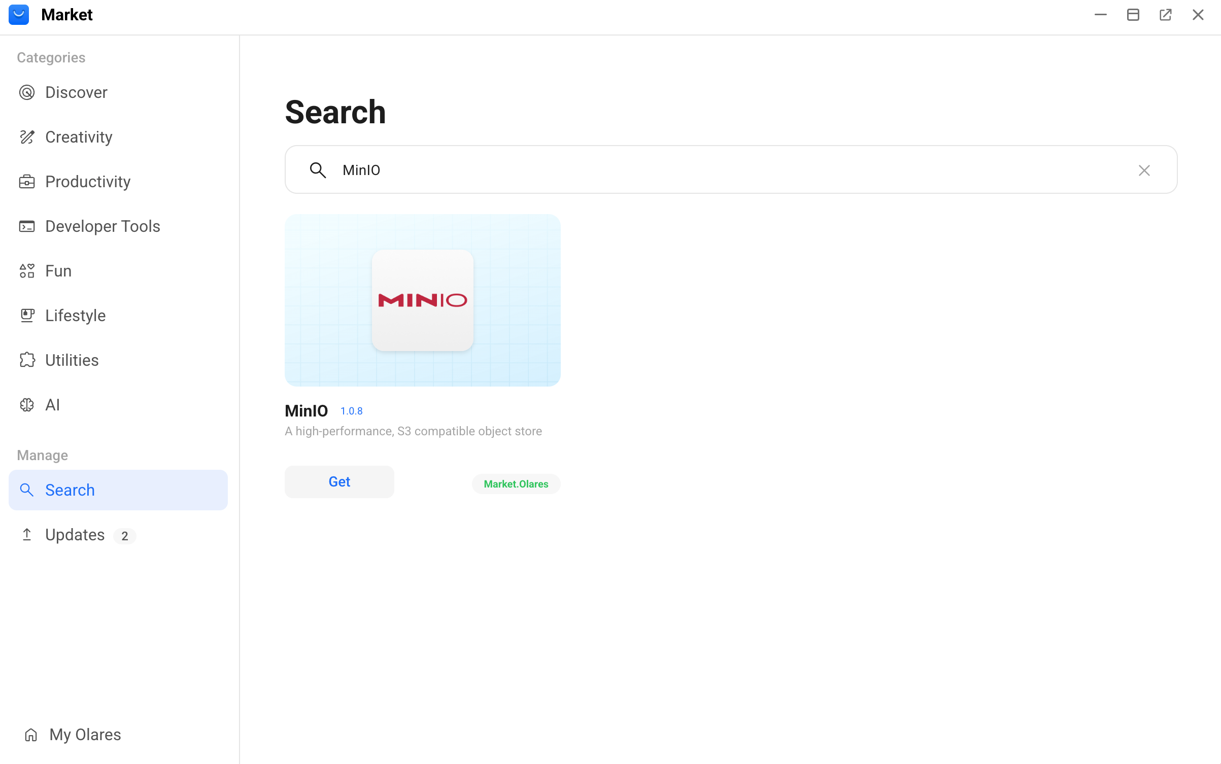

  3. Search for "MinIO" and install it.
    MinIO

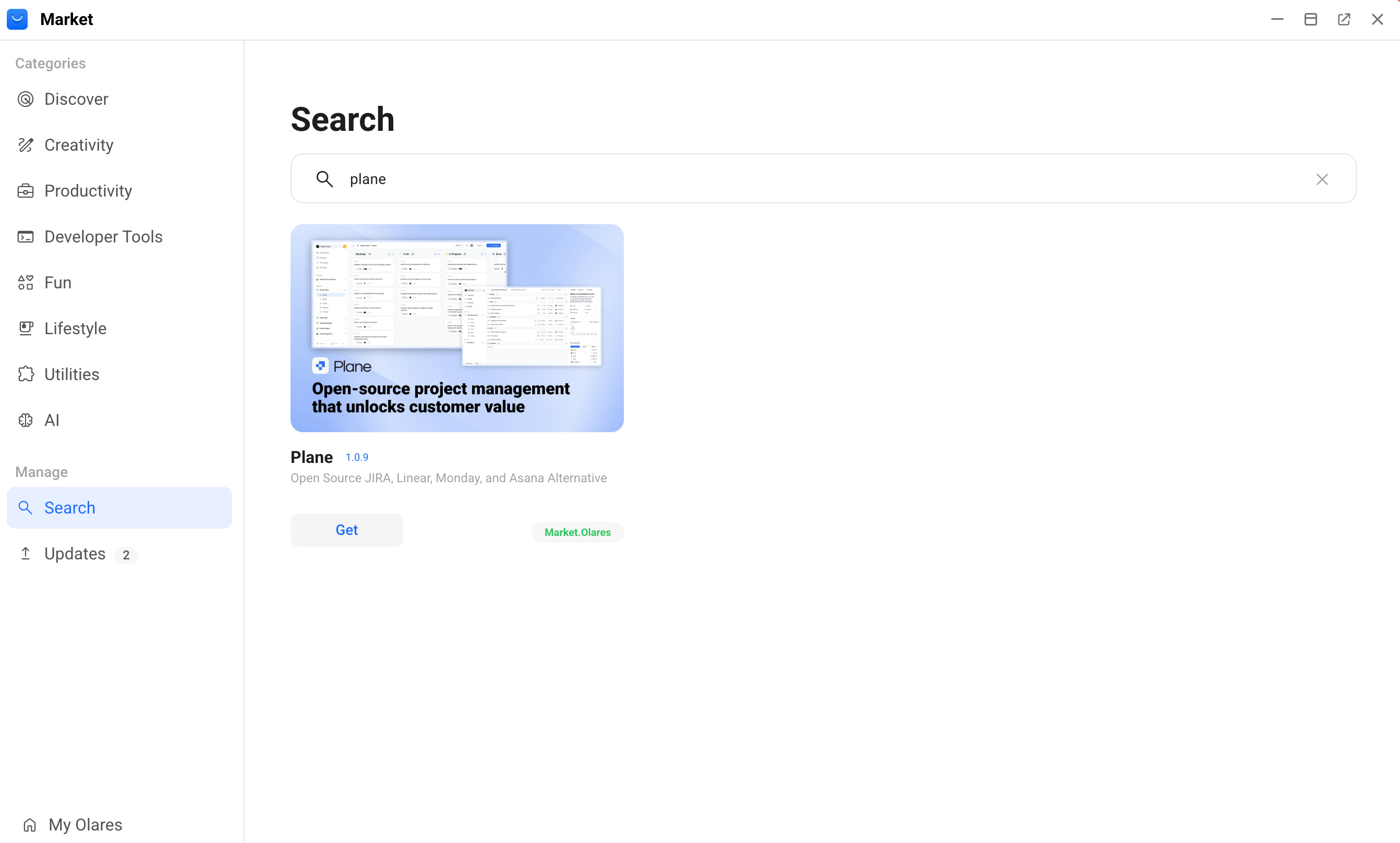

  4. Search for "Plane" and install it.
    Plane

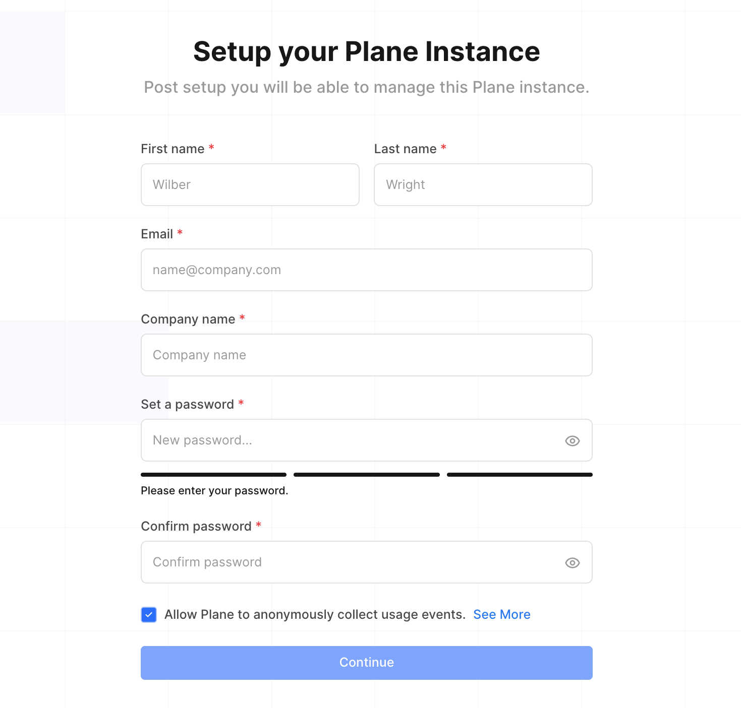

  2. On the Setup your Plane Instance page, fill in the required information, and then click Continue.
    Register for Plane

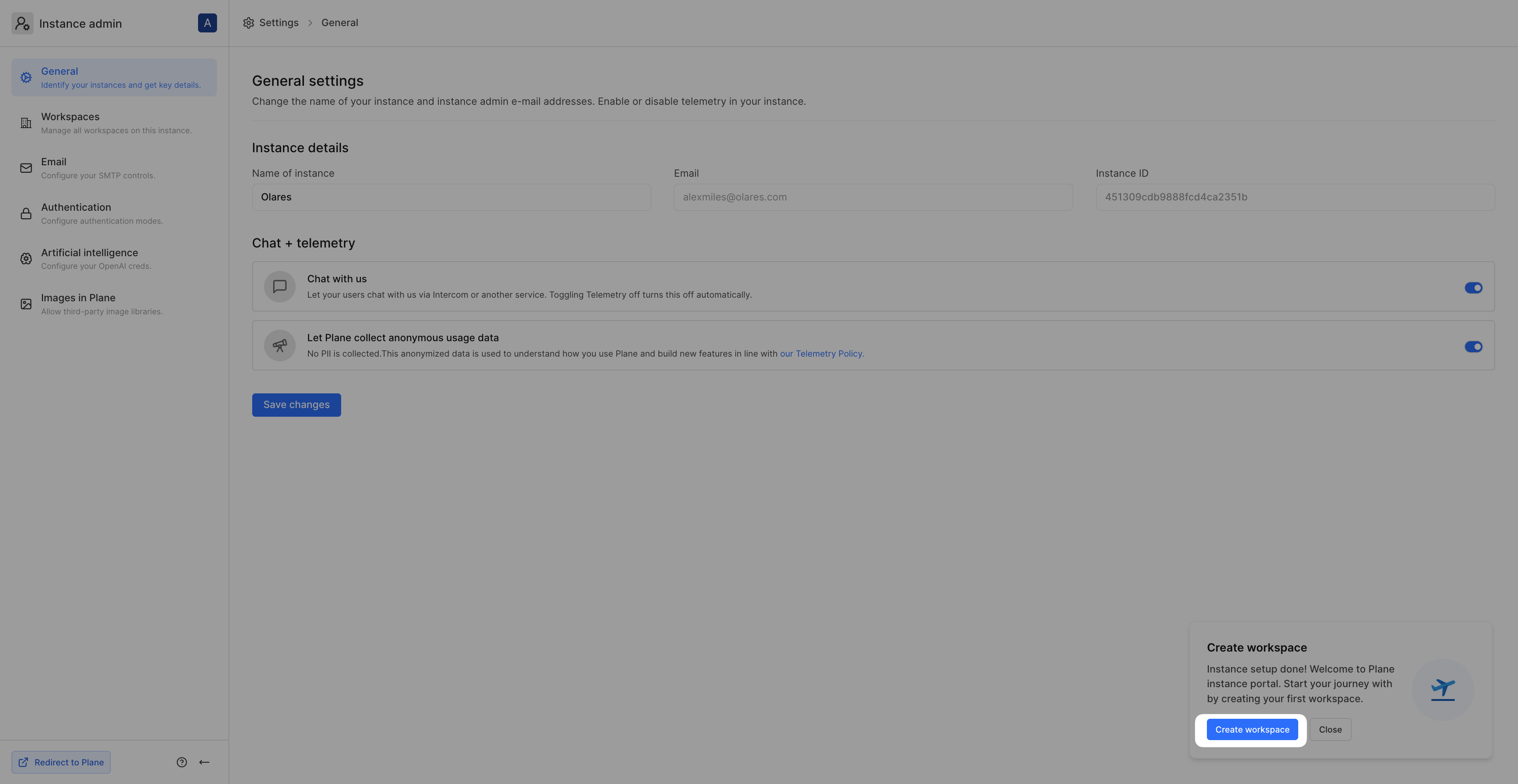

  3. Click Create workspace in the bottom-right corner.
    Create workspace

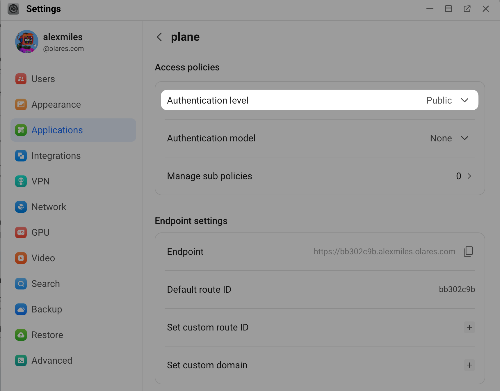

Before sending invitations, you must make Plane publicly accessible in Olares. Otherwise, they cannot join without an Olares password.
  1. Open Settings, go to Applications > Plane > Entrances > Plane, and then change the Authentication level to Public.
    Change authentication level for Plane

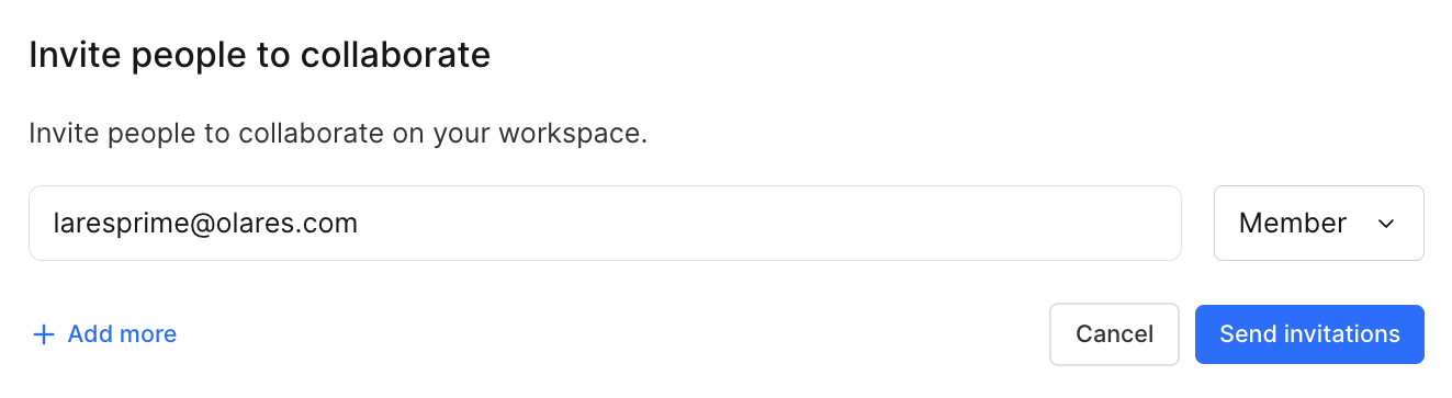

  4. Enter the email address of the team member, and then select the role to assign to the member.
  5. To invite multiple members at once, click Add more.
    Invite team members
  6. Click Send invitations. Invitees appear in the Pending invites panel.

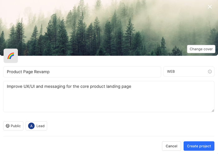

  2. Define the core details of the initiative:
    • Project name: Product Page Revamp
    • Project ID: WEB
    • Description: Improve UX/UI and messaging for the core product landing page
  3. Select an icon, set project visibility, and assign a lead.
  4. Click Create project.
    Create project

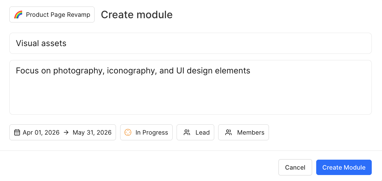

  3. Define the core details of the module:
    • Title: Visual assets
    • Description: Focus on photography, iconography, and UI design elements
  4. Set the date range, status label, lead, and members.
  5. Click Create Module.
    Create module

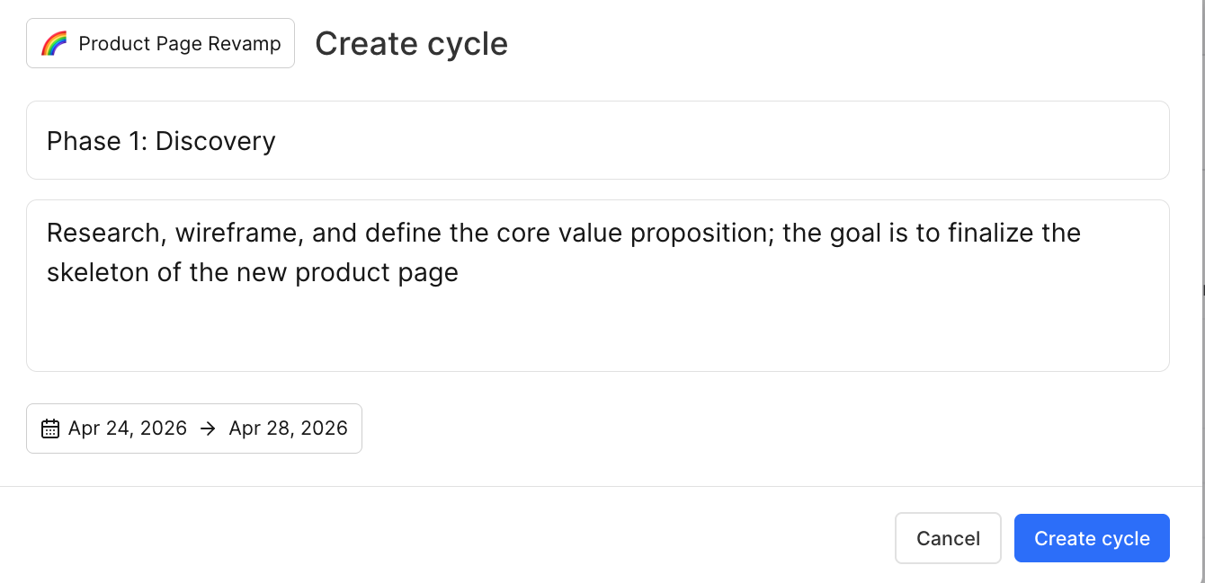

  3. Define the core details of the phase:
    • Title: Phase 1: Discovery
    • Description: Research, wireframe, and define the core value proposition; the goal is to finalize the skeleton of the new product page
  4. Select the start and end dates.
  5. Click Create cycle.
    Create cycle

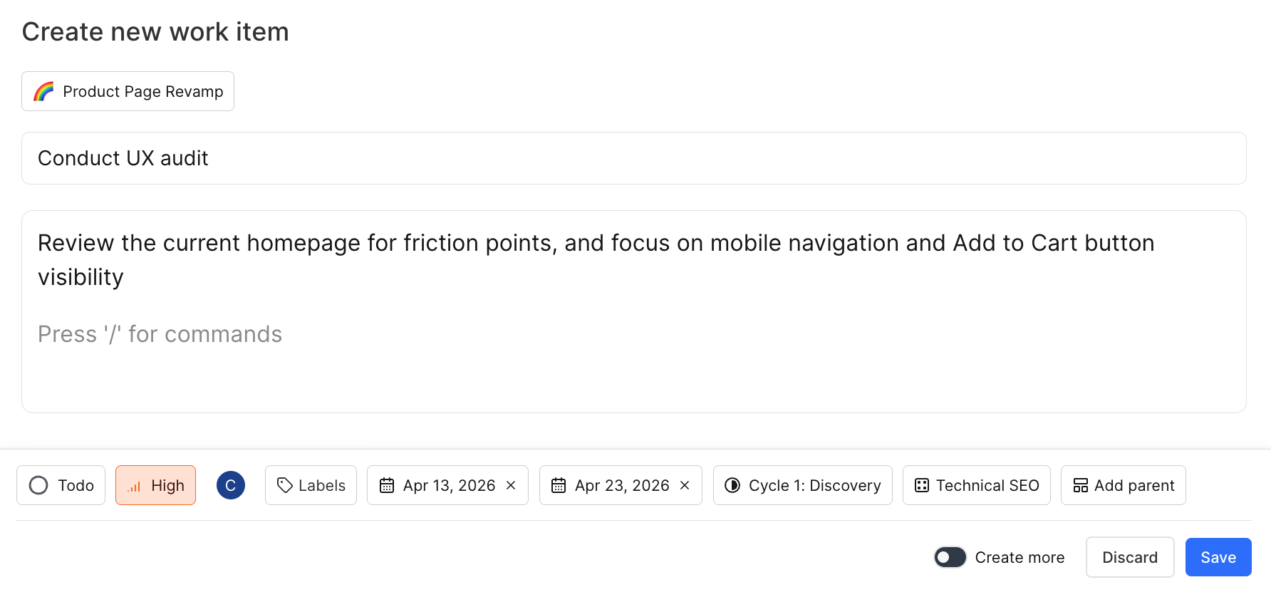

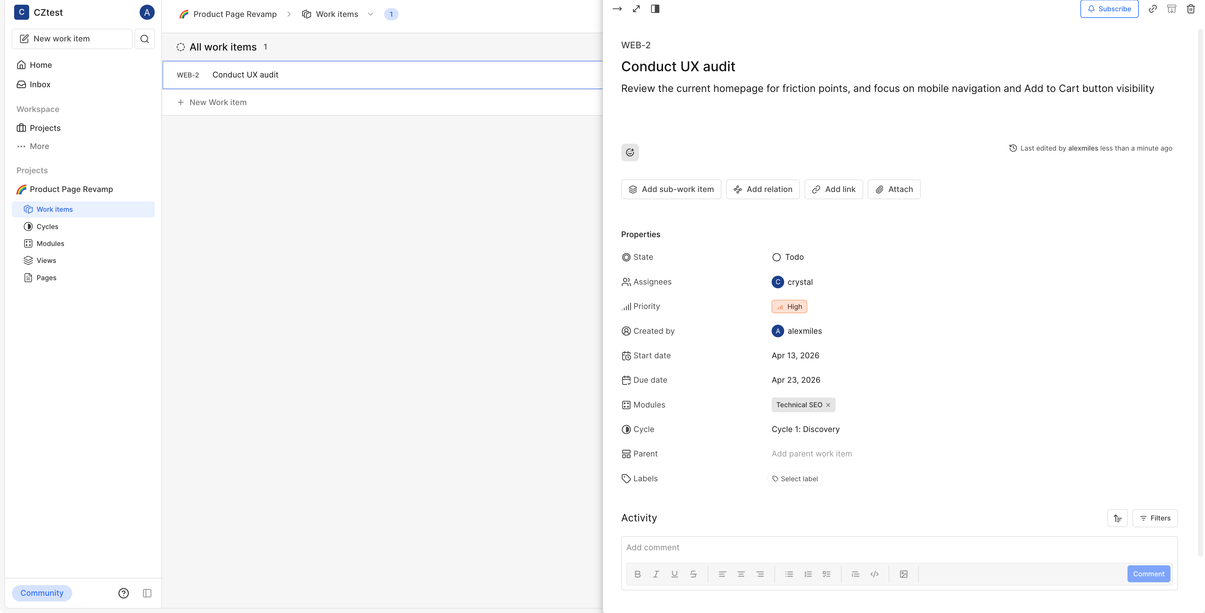

  3. Define the core details of the task:
    • Title: Conduct UX audit
    • Description: Review the current homepage for friction points, and focus on mobile navigation and Add to Cart button visibility.
  4. Set the status and priority, assign it to a team member, set the date range, and link it to a cycle and module.
    Create work items
  5. Click Save.
  6. Repeat these steps to create work items for the remaining tasks in this scenario.
  7. To add more context for a work item, click it to open the details page, where you can attach files, add sub-work items, or leave comments.
    Work item details page

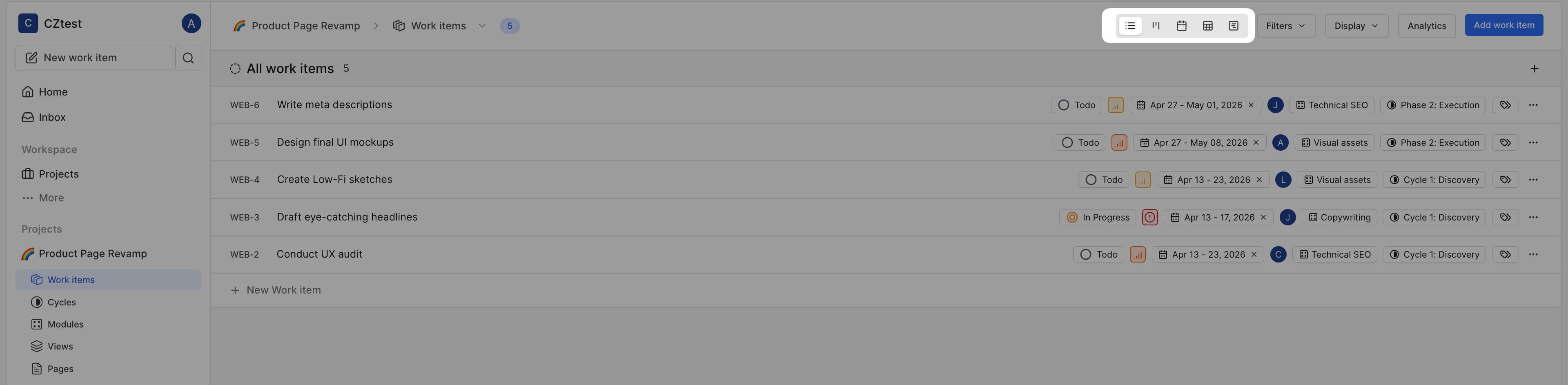

Depending on whether you are running a daily standup meeting, checking upcoming deadlines, or looking for scheduling conflicts, you will need to look at your data differently.
Use the layout icons in the upper-right corner of the Work items page to switch views and get the insights you need.
Layout views
The following layouts are available:
  • List Layout: Groups tasks into collapsible sections (like Todo and In Progress) so you can quickly see where everything stands at a glance.
  • Board Layout: Displays tasks as Kanban cards, allowing you to easily drag and drop work from column to column as it progresses.
  • Calendar Layout: Plots your tasks on a traditional monthly calendar grid so you can see exactly when deliverables are due.
  • Table Layout: Provides a spreadsheet-style interface with distinct columns, making it easy to review and update priorities, assignees, and labels in bulk.
  • Timeline Layout: Maps out task durations as horizontal bars in Gantt style to help you pace the project and spot overlapping work.

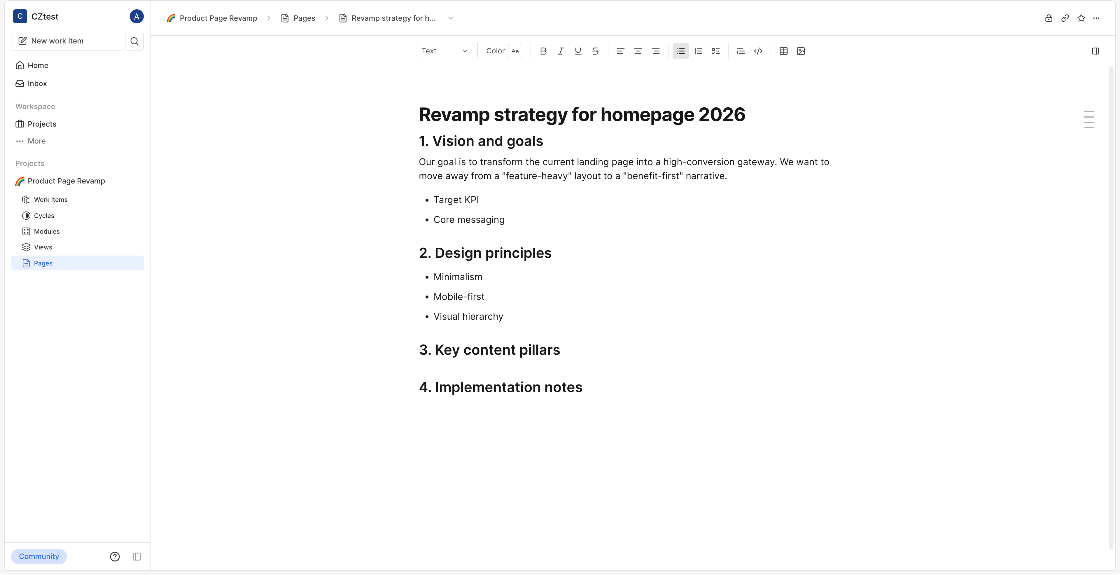

  1. In the left sidebar, click Pages.
  2. Click Create your first page or Add page.
  3. Enter a title for the new document, such as Revamp strategy for homepage 2026.
  4. Click Create Page.
  5. Use the editor to draft your document collaboratively with your team.
    Document collaboration
  6. To connect a document to a work item, click the copy link icon in the upper-right corner, and then paste it into a work item's description so the assignee has the context needed.
  7. To save a local copy of the document, click more_horiz in the upper-right corner, and then click Export.
