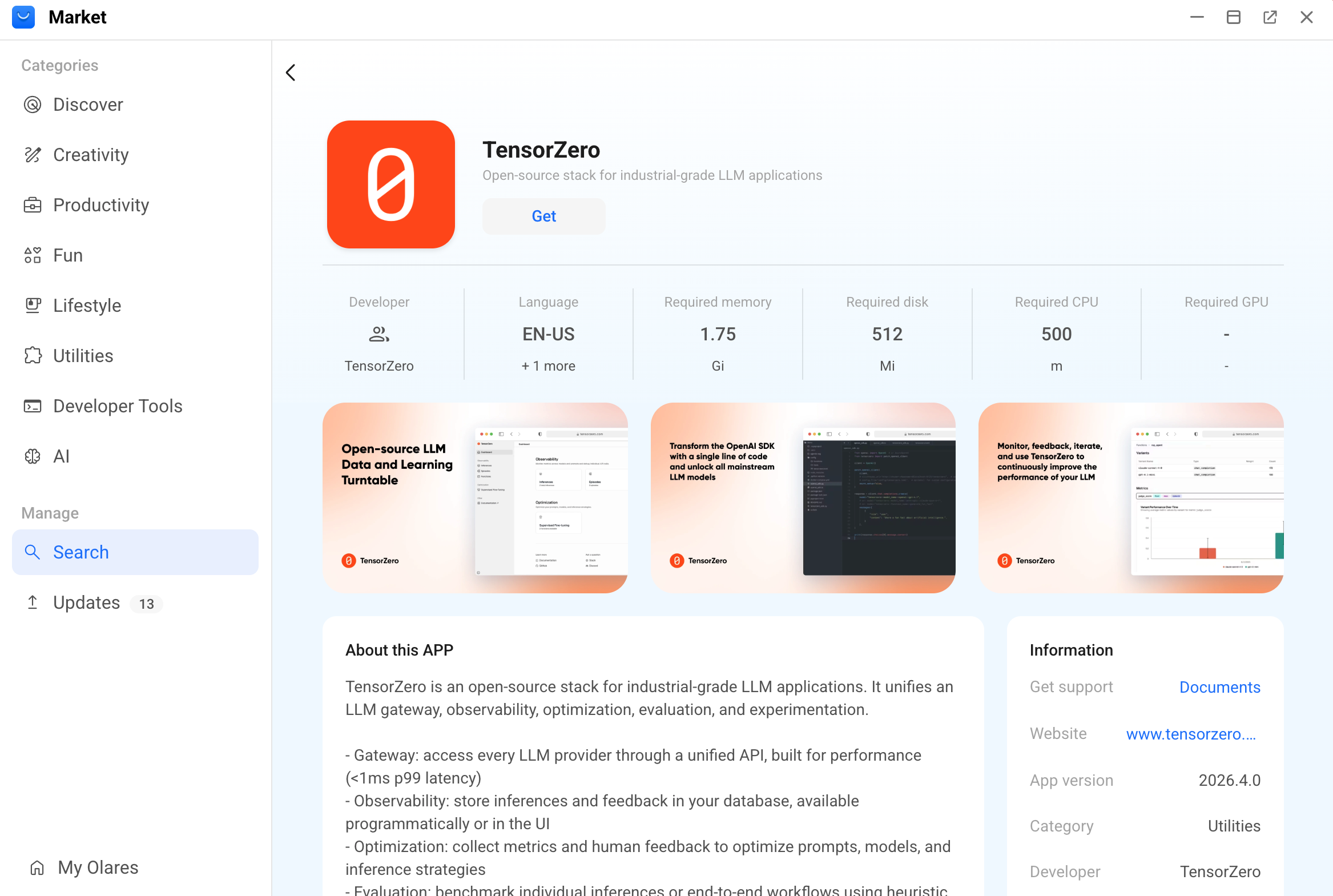

Install TensorZero ​
  1. Open Market and search for "TensorZero".
    Search for TensorZero from Market

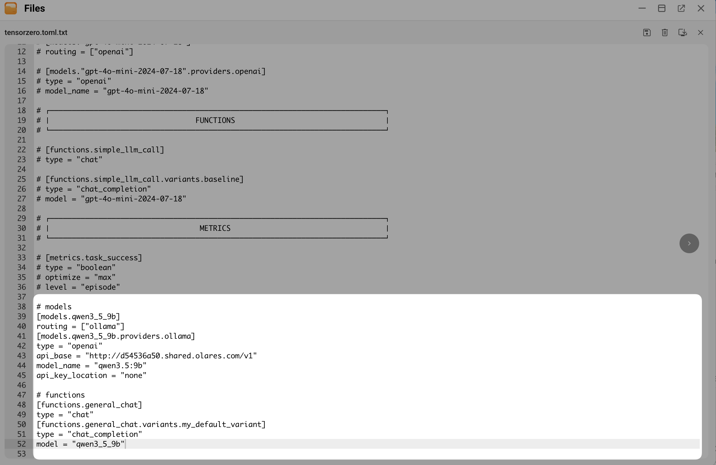

  1. Open Settings, go to Applications > Ollama > Shared entrances > Ollama API, and then copy the endpoint URL. For example, http://d54536a50.shared.olares.com.
  2. Open Files, and then go to Data > tensorzero > config.
  3. Right-click tensorzero.toml, and then rename it to tensorzero.toml.txt.
  4. Double-click tensorzero.toml.txt, and then click edit_square.
  5. In the editor, add the following snippet:
    • Replace api_base with your copied Ollama endpoint URL and append /v1.
    • Replace model_name with the exact name of the model you downloaded in Ollama.
    This configuration registers your Ollama model under the alias qwen3_5_9b, and creates a client-facing function general_chat that routes incoming app requests to that model.
    toml
    # models
    [models.qwen3_5_9b]
    routing = ["ollama"]
    [models.qwen3_5_9b.providers.ollama]
    type = "openai"
    api_base = "<ollama-shared-entrance>/v1"
    model_name = "qwen3.5:9b"
    api_key_location = "none"
    # functions
    [functions.general_chat]
    type = "chat"
    [functions.general_chat.variants.my_default_variant]
    type = "chat_completion"
    model = "qwen3_5_9b"
    Connect to Ollama
  6. Click save, and then close the file.
  7. Rename tensorzero.toml.txt back to tensorzero.toml.

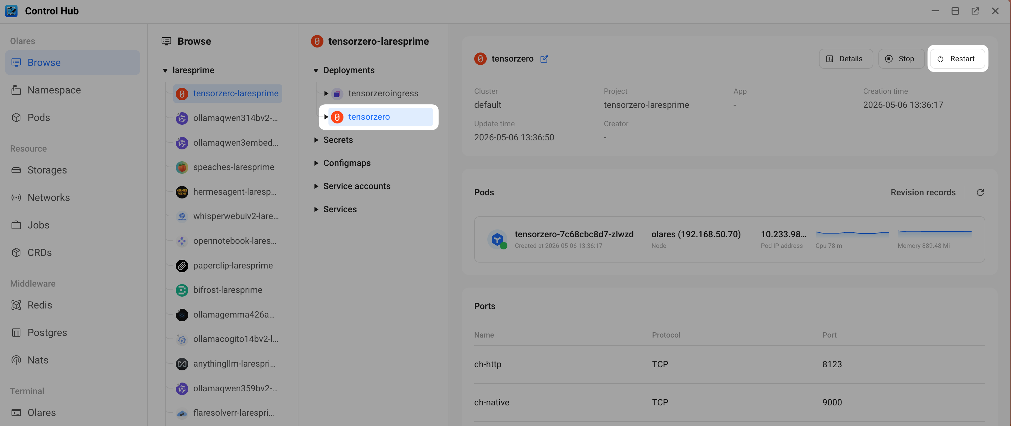

  8. Open Control Hub, go to Browse > tensorzero-{username} > Deployments > tensorzero, and then click Restart for the application to apply the new settings.
    TensorZero pod restart

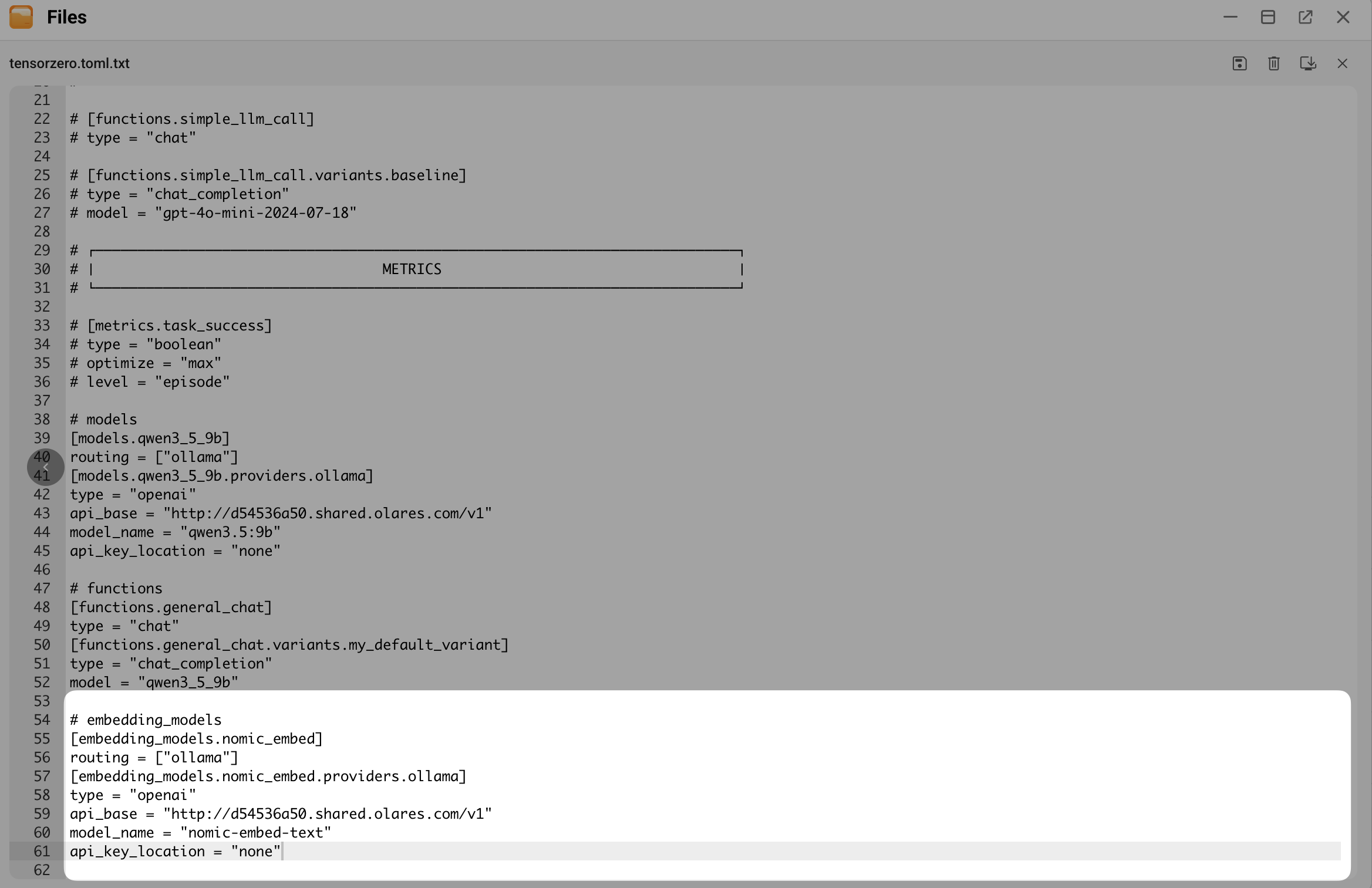

(Optional) Configure an embedding model ​
Some apps require embedding models to search through documents or build memory features. TensorZero treats embedding models separately from chat models. You must define a dedicated embedding model. Do not use a chat function for memory tasks.
  1. Add the following snippet in tensorzero.toml to define an embedding model:
    • Replace model_name with the exact name of the embedding model you downloaded in Ollama.
    This configuration registers your Ollama embedding model under the alias nomic_embed.
    toml
    # embedding_models
    [embedding_models.nomic_embed]
    [embedding_models.nomic_embed.providers.ollama]
    type = "openai"
    model_name = "nomic-embed-text"
    Connect to embedding model
  2. Restart the tensorzero container in Control Hub for the application to apply the new settings.

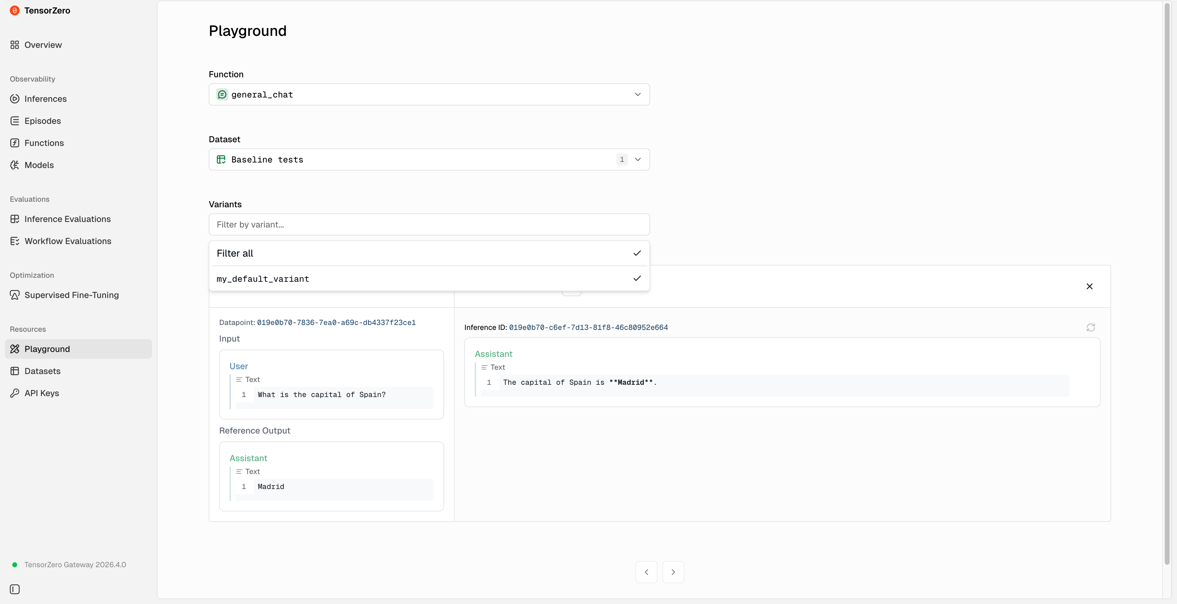

Use the built-in Playground to test that your function works correctly with your Ollama model.

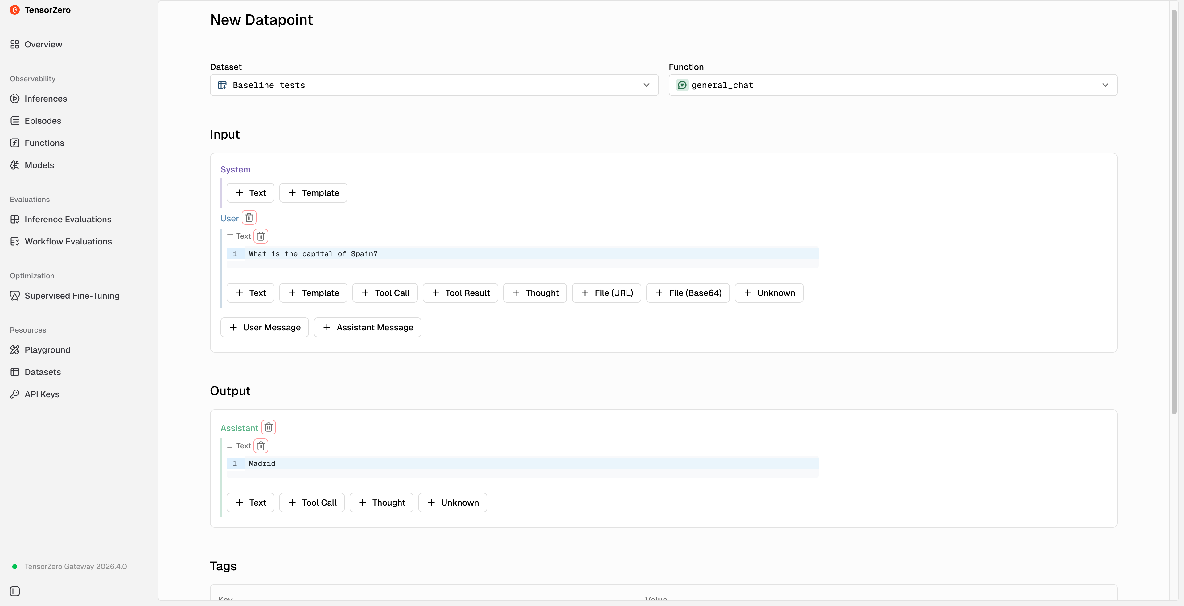

The Playground requires at least one test case, called a Datapoint, to display the chat interface. If you do not have one, you must create it manually.
  1. Open TensorZero from the Launchpad.
  2. Select Datasets from the left sidebar.
  3. Click New Datapoint, and then configure the test case details.
    For example, to create a basic geography test:
    • Dataset: Specify a name to create a new collection of test cases. For example, Baseline tests.
    • Function: Select the function you configured earlier. For example, general_chat.
    • Input: Select + User Message, click + Text, and then enter a test prompt. For example, What is the capital of Spain?.
    • Output: Select + Text, and then enter the exact answer you expect the model to generate. For example, Madrid.
    • (Optional) Tags and Metadata: Enter labels to help identify this test case later. For example, add a tag with Key set to type and Value set to QA.
    Create a new datapoint
  4. Click Create Datapoint.
  5. Select Playground from the left sidebar.
  6. Select your function, the dataset you just created, and your variant. The chat interface appears. If you receive a normal reply, the setup is successful.
    Verify connection

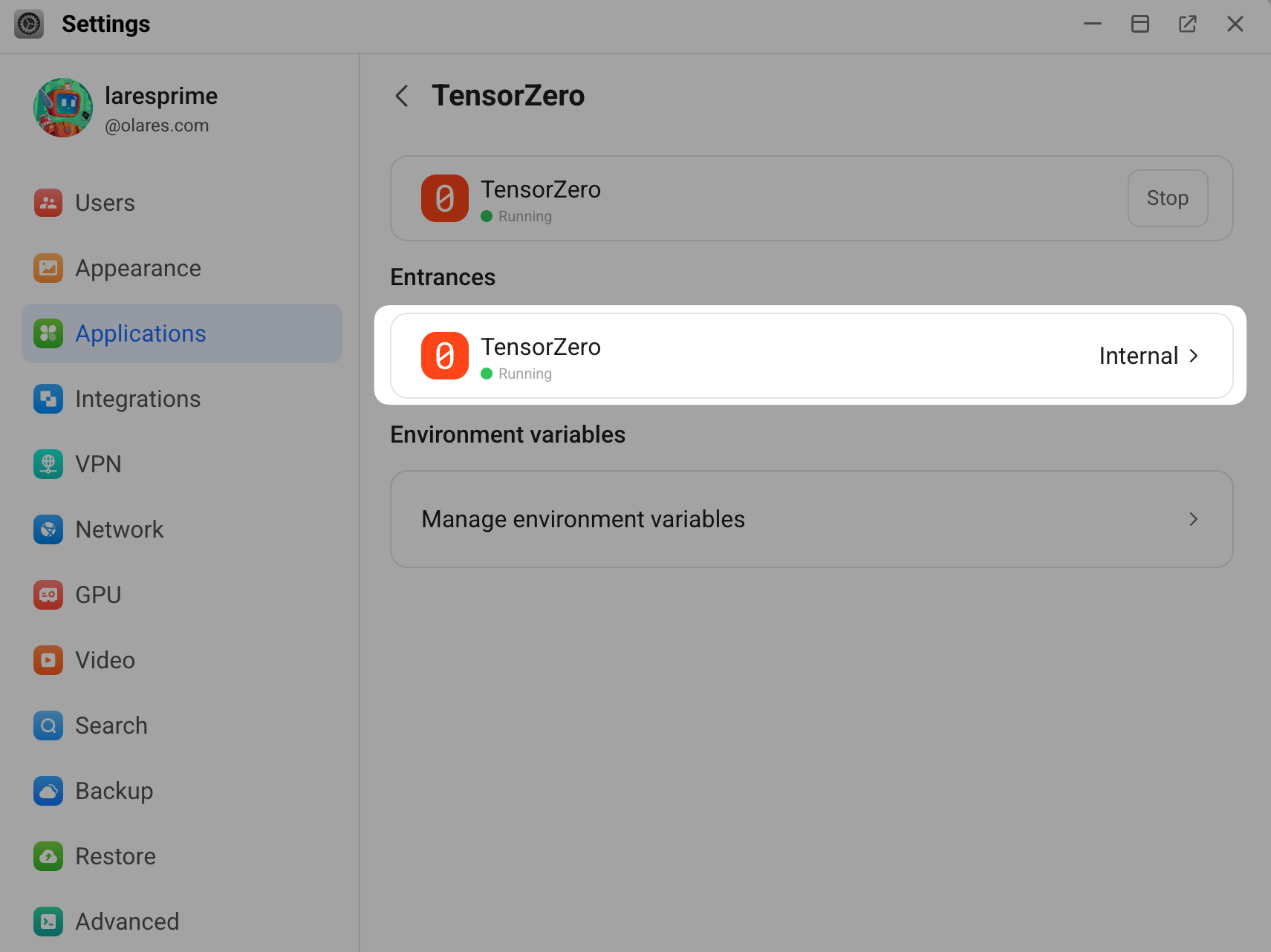

Obtain the TensorZero endpoint ​
To connect other apps to TensorZero, get its entrance address.
  1. Open Settings, and then go to Applications > TensorZero > Entrances > TensorZero.
    TensorZero endpoint address
  2. Copy the endpoint URL. For example, https://ea581361.laresprime.olares.com. For OpenAI‑compatible clients, you must append /openai/v1 to this URL.

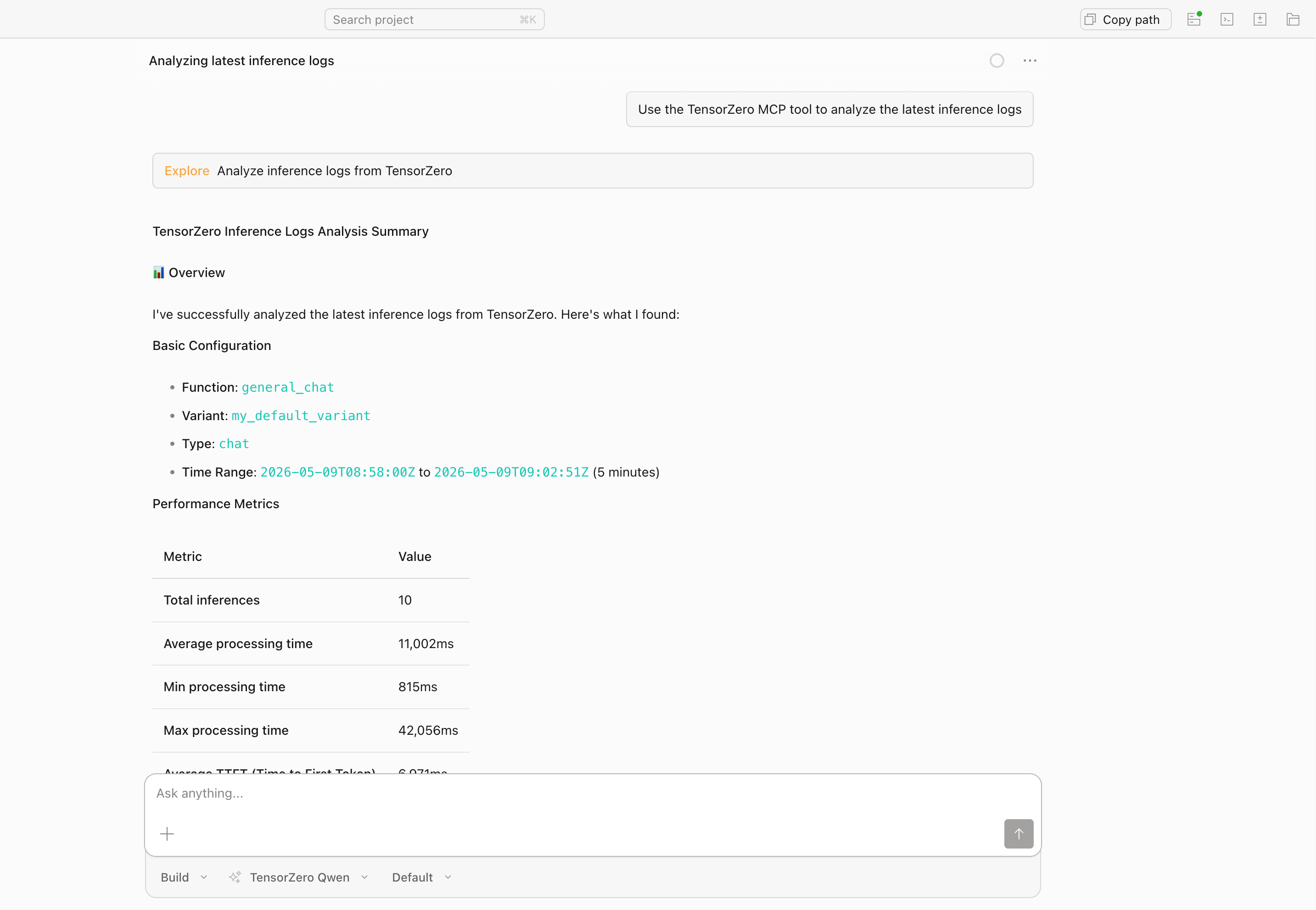

Access the built-in MCP server ​
TensorZero includes a built-in Model Context Protocol (MCP) server located at the /mcp endpoint. This feature allows your AI agent to look up the performance data in TensorZero.
For example, you can ask your agent to retrieve the average response time for general_chat today, and the agent will use the MCP connection to read the logs and report the data back to you.
The following example demonstrates how to configure OpenCode to access this MCP tool.

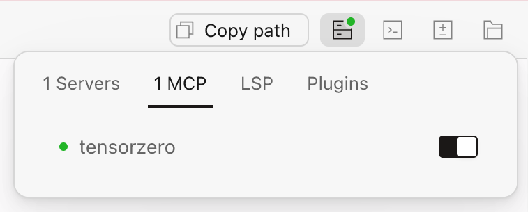

  5. Restart the OpenCode app to apply the changes. In the upper-right corner, on the MCP tab, verify that tensorzero shows up as enabled.

  6. Instruct your AI agent directly in the chat to explicitly use the tool. For example, enter Use the TensorZero MCP tool to analyze the latest inference logs.
    OpenCode MCP use

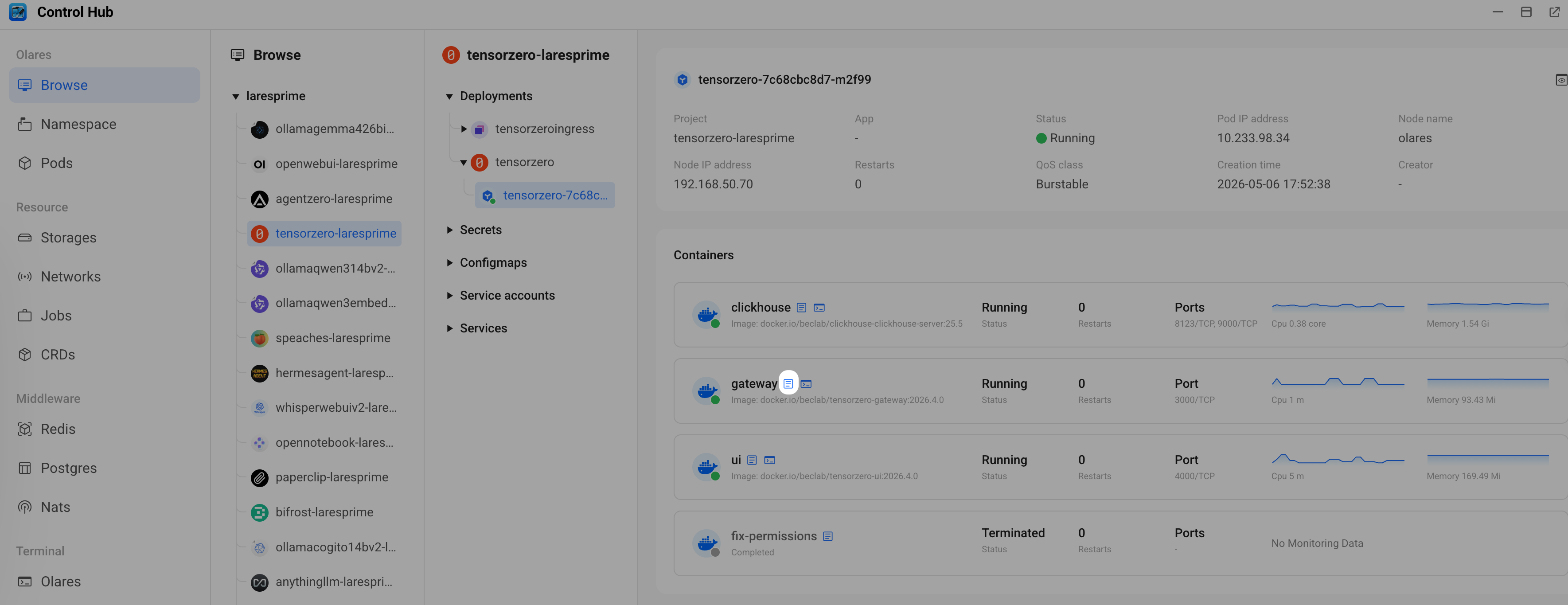

  1. Open Control Hub, go to tensorzero-{username} > Deployments > tensorzero > Pods, and then click the tensorzero pod.
  2. In the Containers section, locate gateway, and then click article next to it.
    Container logs
  3. Look for the following common errors:
    • Failed to parse tensorzero.toml: Syntax error. Ensure you have exactly one empty line between every section block (# models, # functions, # embedding_models). If you deleted the empty lines when pasting the code, the application will fail to start.
    • unknown field: Incorrect setting name, such as dots or colons in aliases. Use underscores, like qwen3_5_9b, not qwen3.5:9b.
    • provider...not found: The provider name in your routing = ["name"] line does not match the block defined immediately below it [models.alias.providers.name]. For example, if you write routing = ["ollama"], you must have a matching [models.xxx.providers.ollama] block.
