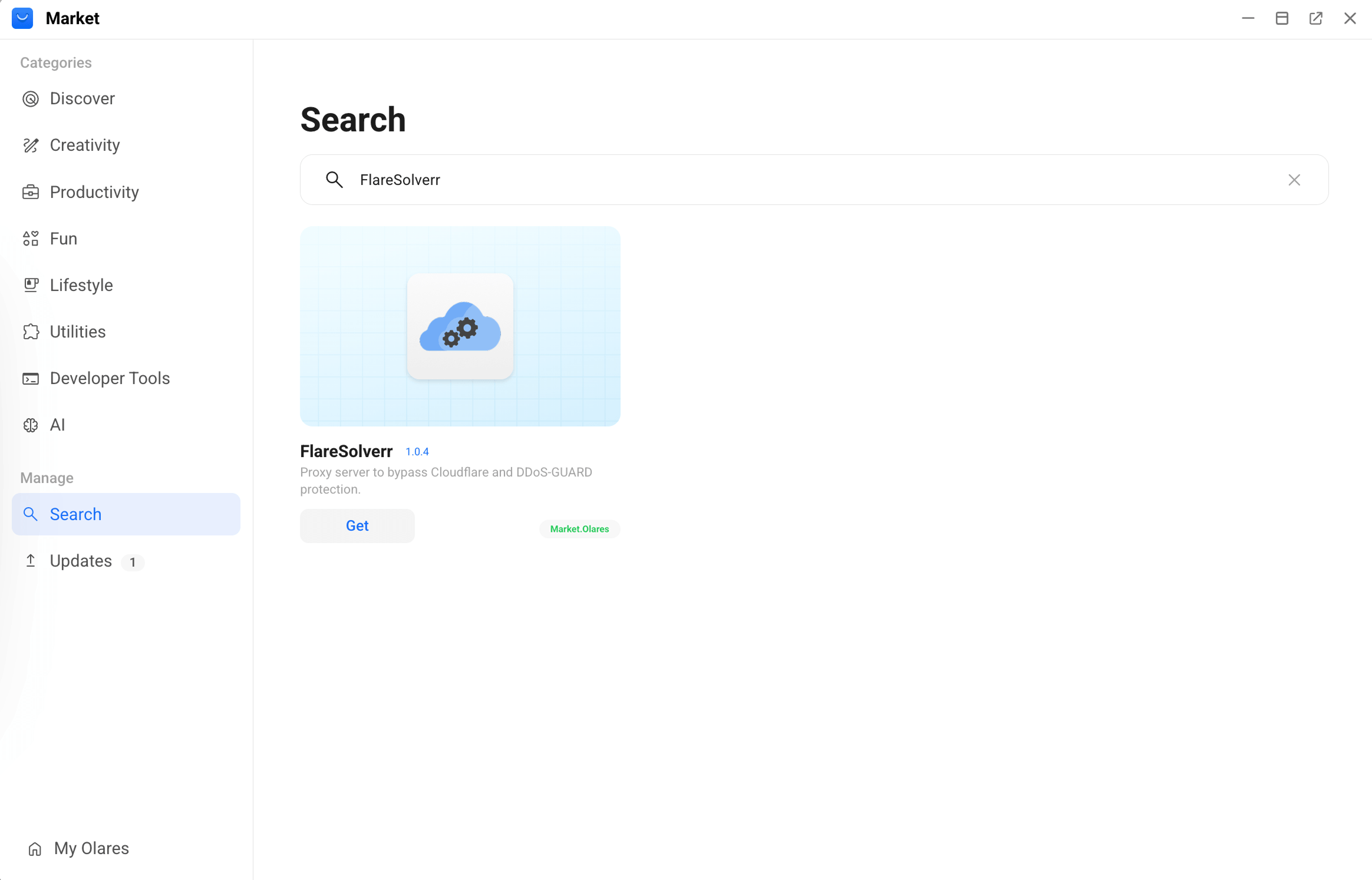

Install FlareSolverr ​
  1. Open Market and search for "FlareSolverr". Install FlareSolverr

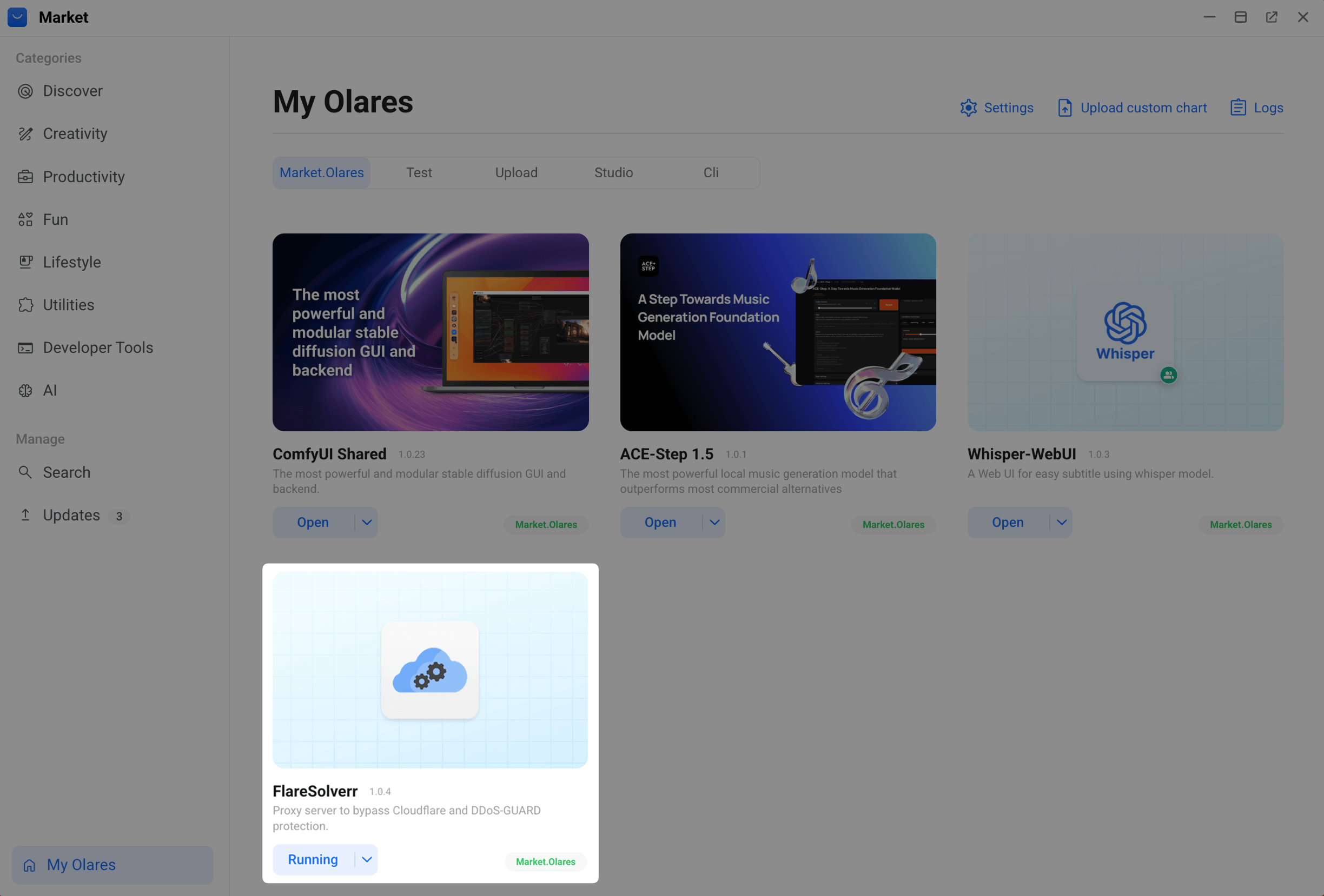

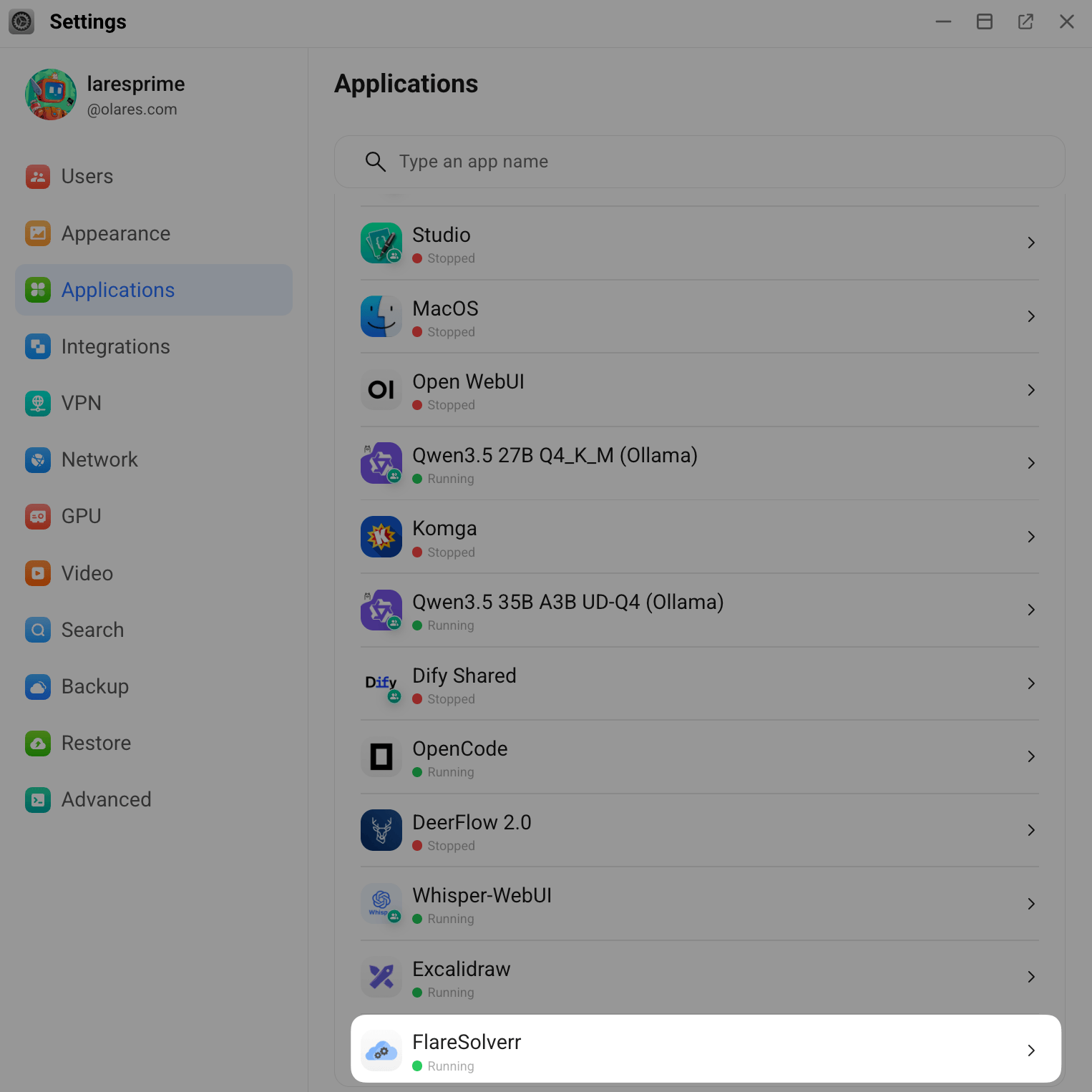

FlareSolverr runs as a background service, so it does not appear on Launchpad.
You can find it in Settings > Applications or Market > My Olares.
FlareSolverr in SettingsFlareSolverr in My Olares

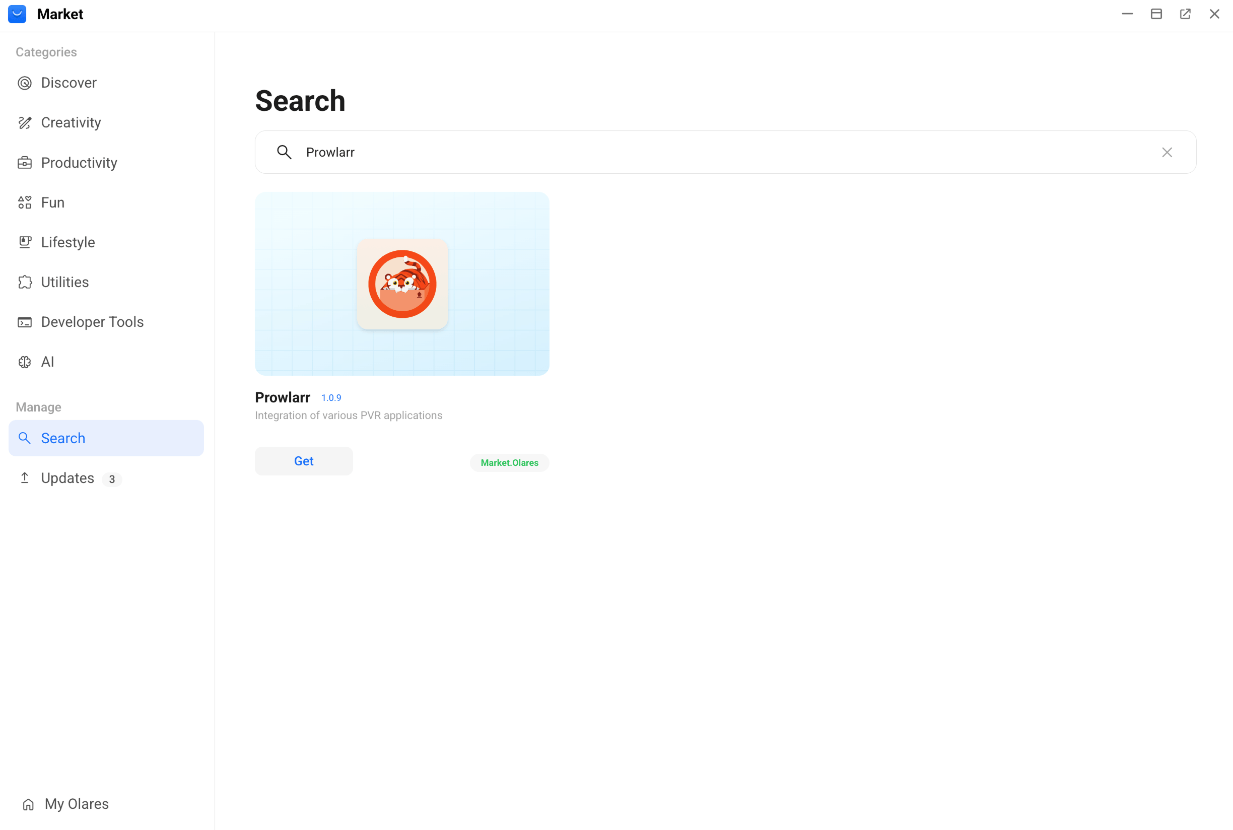

  1. Open Market and search for "Prowlarr". Install Prowlarr

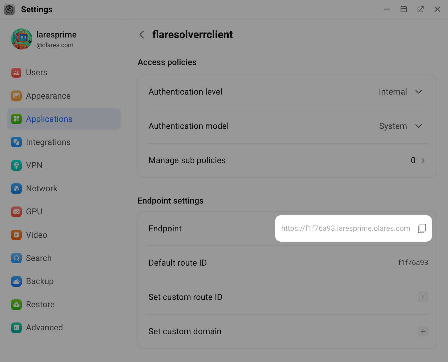

Get the FlareSolverr API address ​
  1. Open Settings, then navigate to Applications > FlareSolverr.
  2. Under Entrances, click FlareSolverr.
  3. Under Endpoint settings, locate the API endpoint and click content_copy to copy the address. FlareSolverr entrance

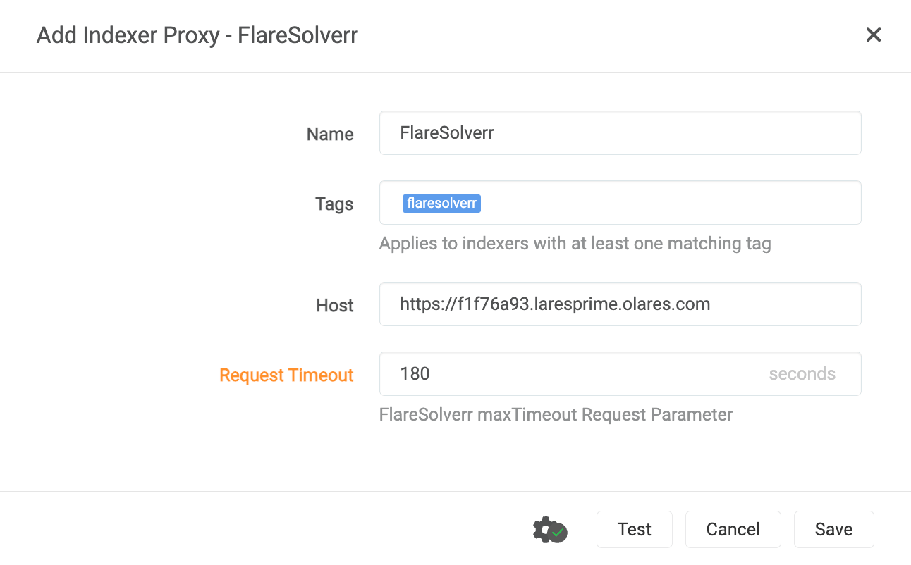

Add FlareSolverr as an indexer proxy ​
  1. Open Prowlarr from Launchpad.
    First-time setup
    The first time you open Prowlarr, the Authentication Required dialog appears. Select an authentication method, set a username and password, then click Save to continue.
  2. Go to Settings > Indexers.

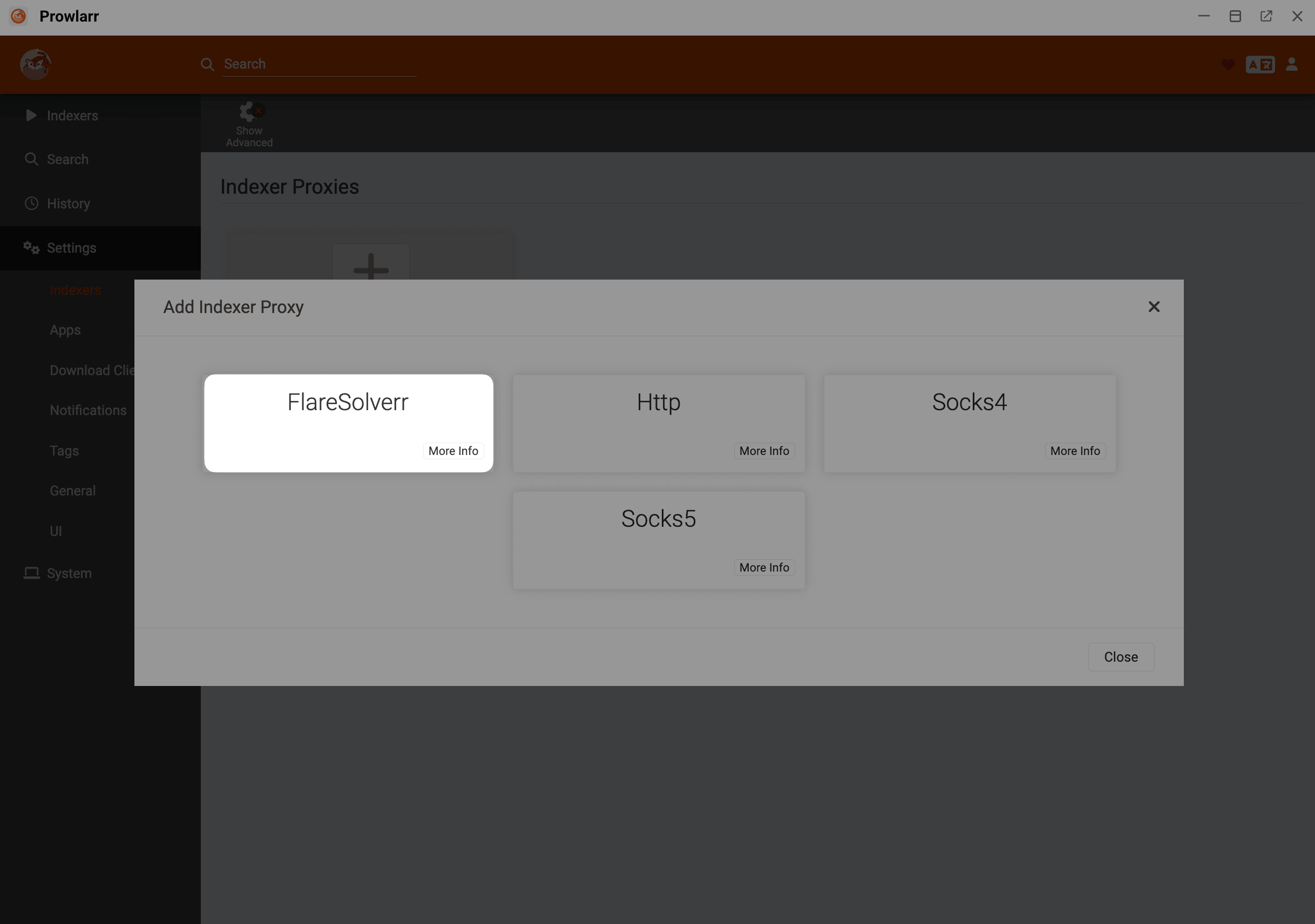

  3. Under Indexer Proxies, click add_2, then select FlareSolverr.
    Add FlareSolverr proxy
  4. Configure the proxy settings:
    • Tags: Enter a lowercase tag name such as flaresolverr. Prowlarr uses this tag to decide which indexers should route requests through FlareSolverr.
    • Host: Paste the FlareSolverr API address you copied earlier.
  5. Click the gear icon and set Request Timeout to 180 seconds.
  6. Click Test to verify the connection, then click Save. FlareSolverr proxy settings

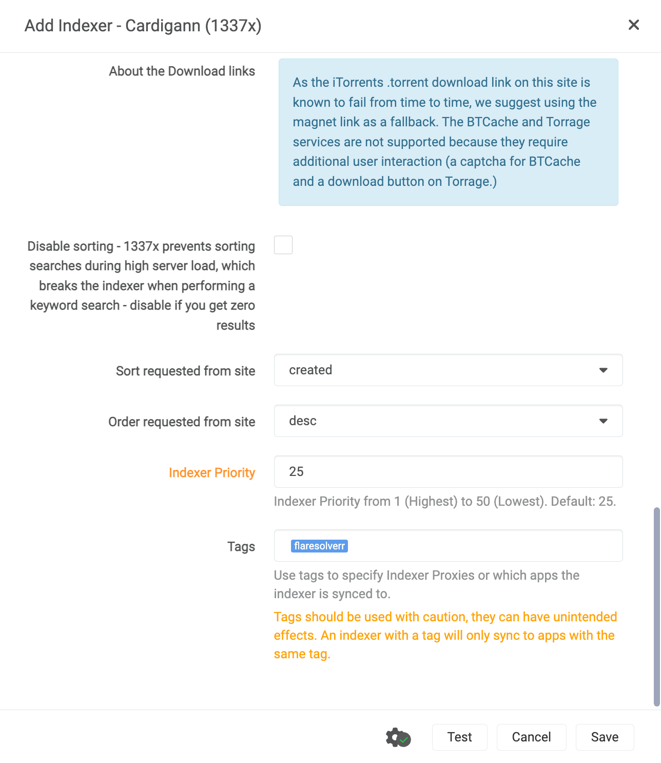

Add a Cloudflare-protected indexer ​
This example uses 1337x, a popular indexer site protected by Cloudflare.
  1. In Prowlarr, click Indexers > Add Indexer and search for "1337x".
  2. Select 1337x, then set Base URL to 1337x.to.
  3. In the Tags field at the bottom, enter the same tag you assigned to the FlareSolverr proxy (e.g., flaresolverr). 1337x indexer settings
  4. Click Test.
The challenge-solving process might take some time and does not always succeed on the first attempt. Try a few times if the initial test fails.

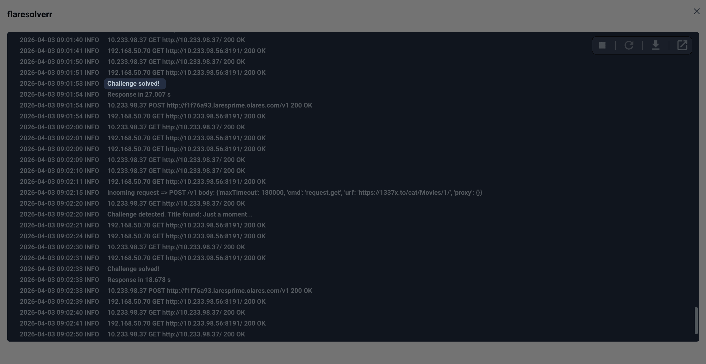

You can check FlareSolverr's logs to confirm it is receiving and solving Cloudflare challenges.

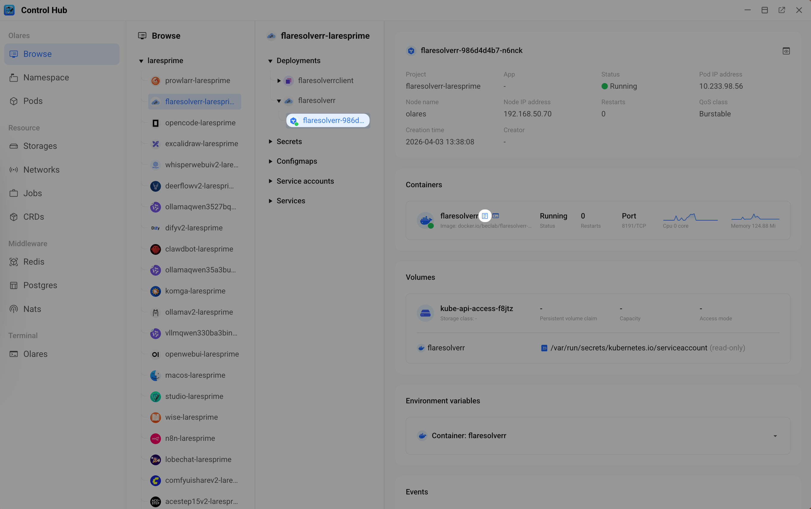

  1. Open Control Hub and select the FlareSolverr project from the sidebar.
  2. Under Deployments, click the running pod of flaresolverr, then expand the container to view its logs.
    FlareSolverr container logs
  3. Click the play button to stream real-time logs.
  4. Go back to Prowlarr and click Test on the 1337x indexer. You should see the incoming request appear in FlareSolverr's logs.
  5. Look for Challenge solved in the logs. This confirms FlareSolverr has bypassed Cloudflare protection. FlareSolverr challenge solved

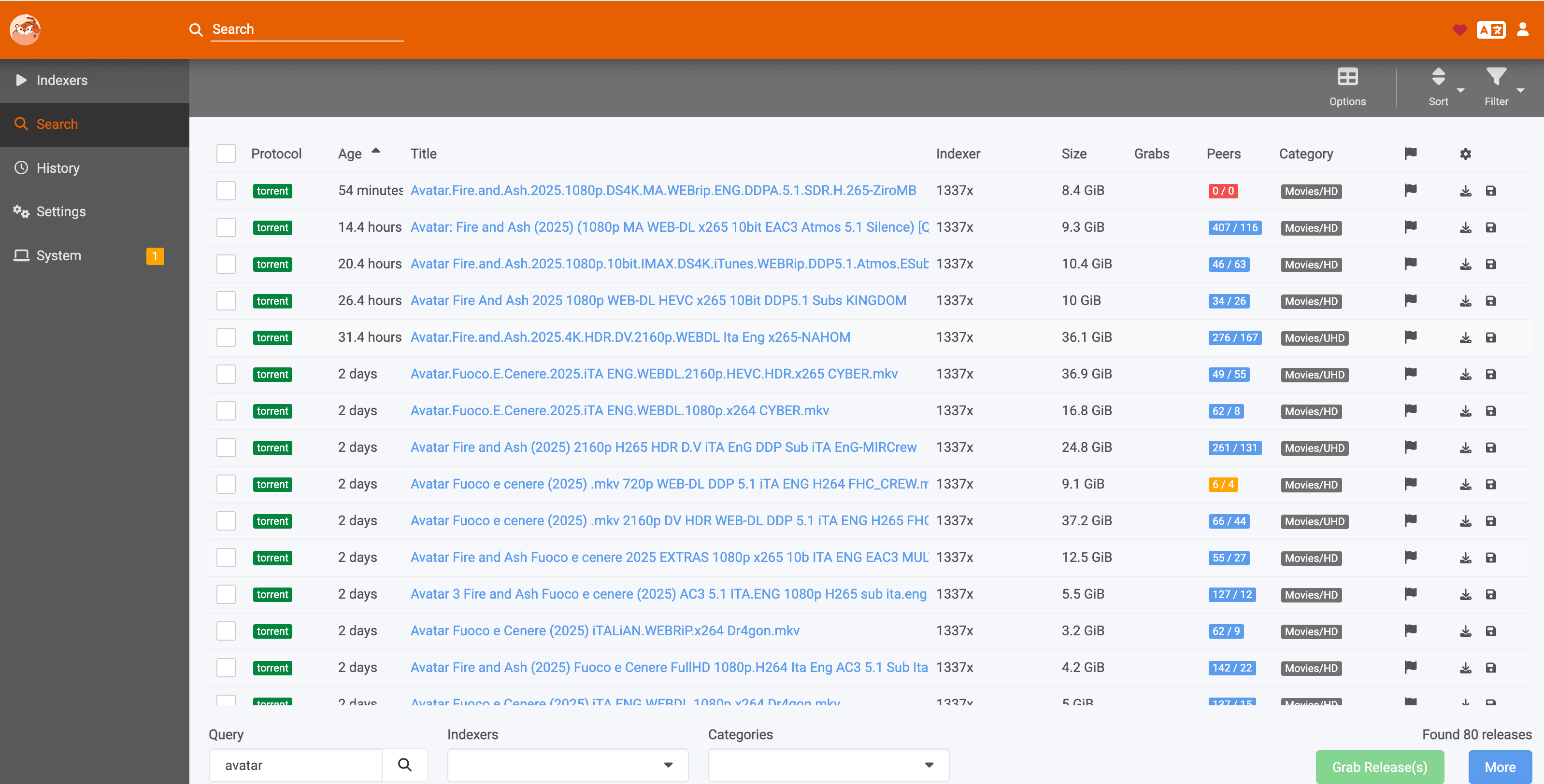

  6. Search for content in Prowlarr's search bar. If results appear, FlareSolverr is working correctly. Prowlarr search results

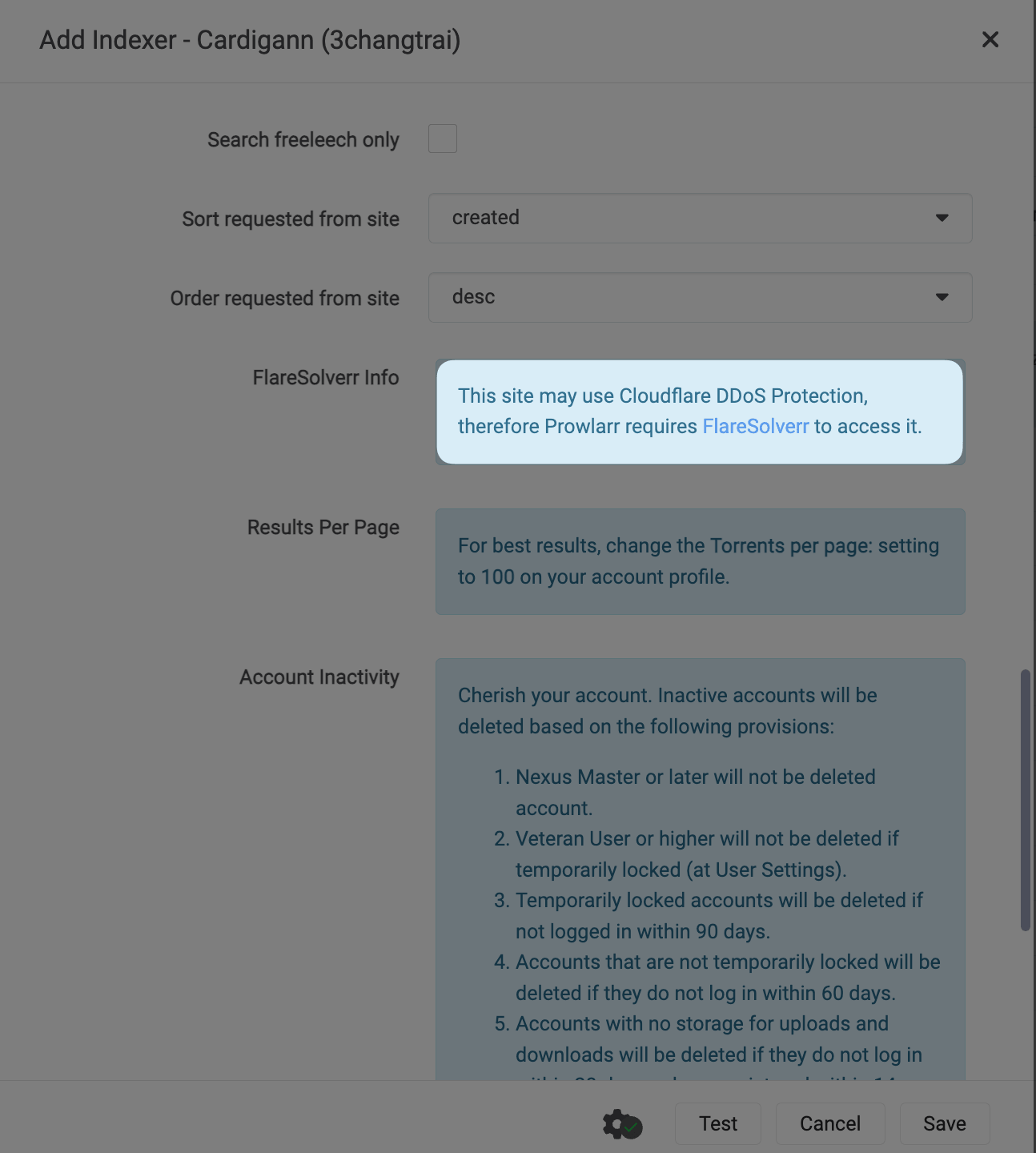

When adding other indexers in Prowlarr, look for the following message:
This site may use Cloudflare DDoS Protection, therefore Prowlarr requires FlareSolverr to access it.
Cloudflare warning on indexer
For any indexer showing this warning, add the same FlareSolverr proxy tag (e.g., flaresolverr) in the indexer's Tags field.

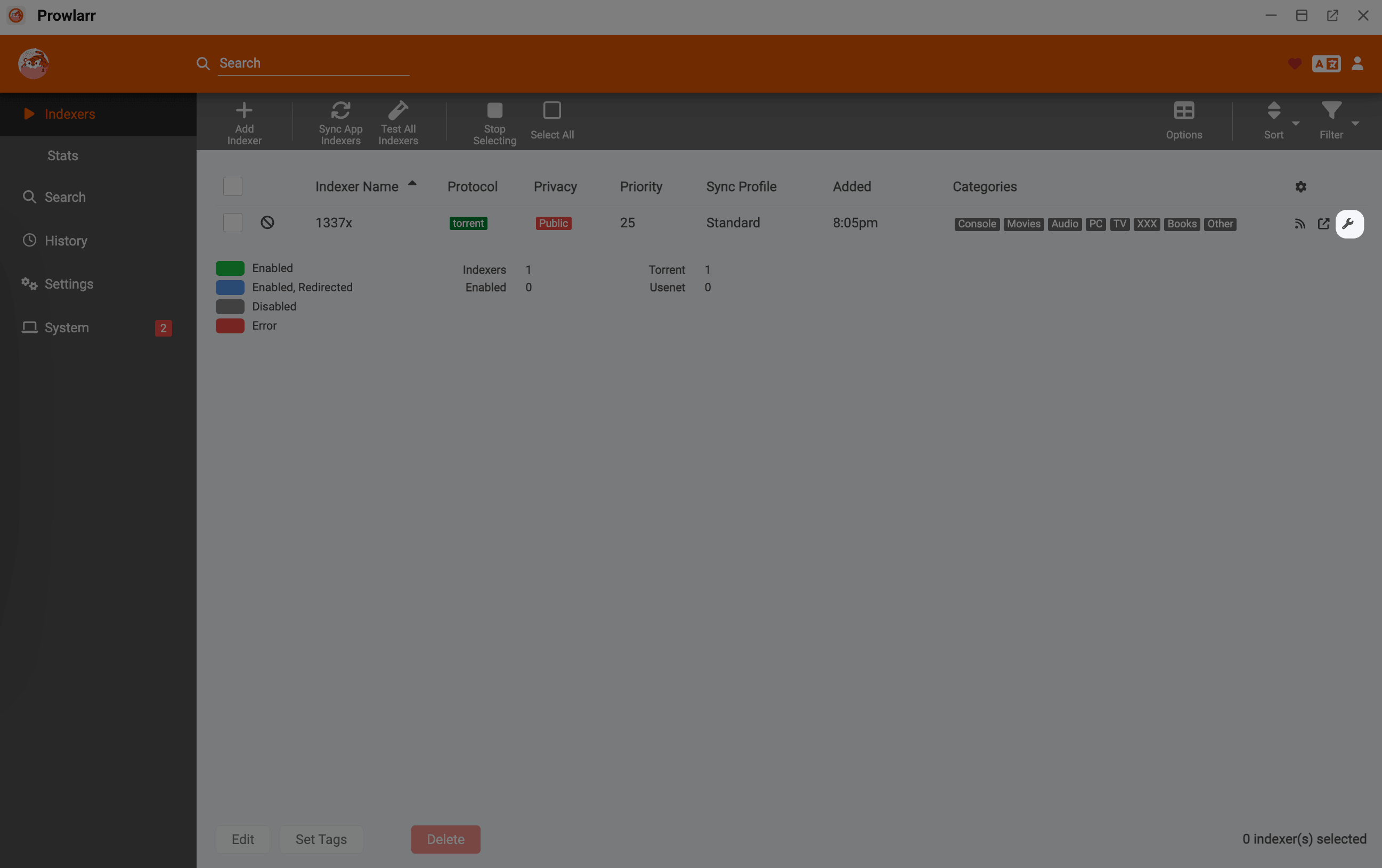

  2. Uncheck the Enable checkbox, then click Save. The indexer is now added to the list in a disabled state.
  3. On the Indexers page, locate the indexer in the list and click the wrench icon on the far right to edit it. Edit indexer from Indexers list
  4. Select the Enable checkbox.
  5. Click Save.
  6. If Prowlarr keeps the edit page open and displays a warning (e.g., Unable to access 1337x.to, blocked by CloudFlare Protection), the Save button will change to a red warning icon. Click this icon again to save the indexer despite the failed connection check.
